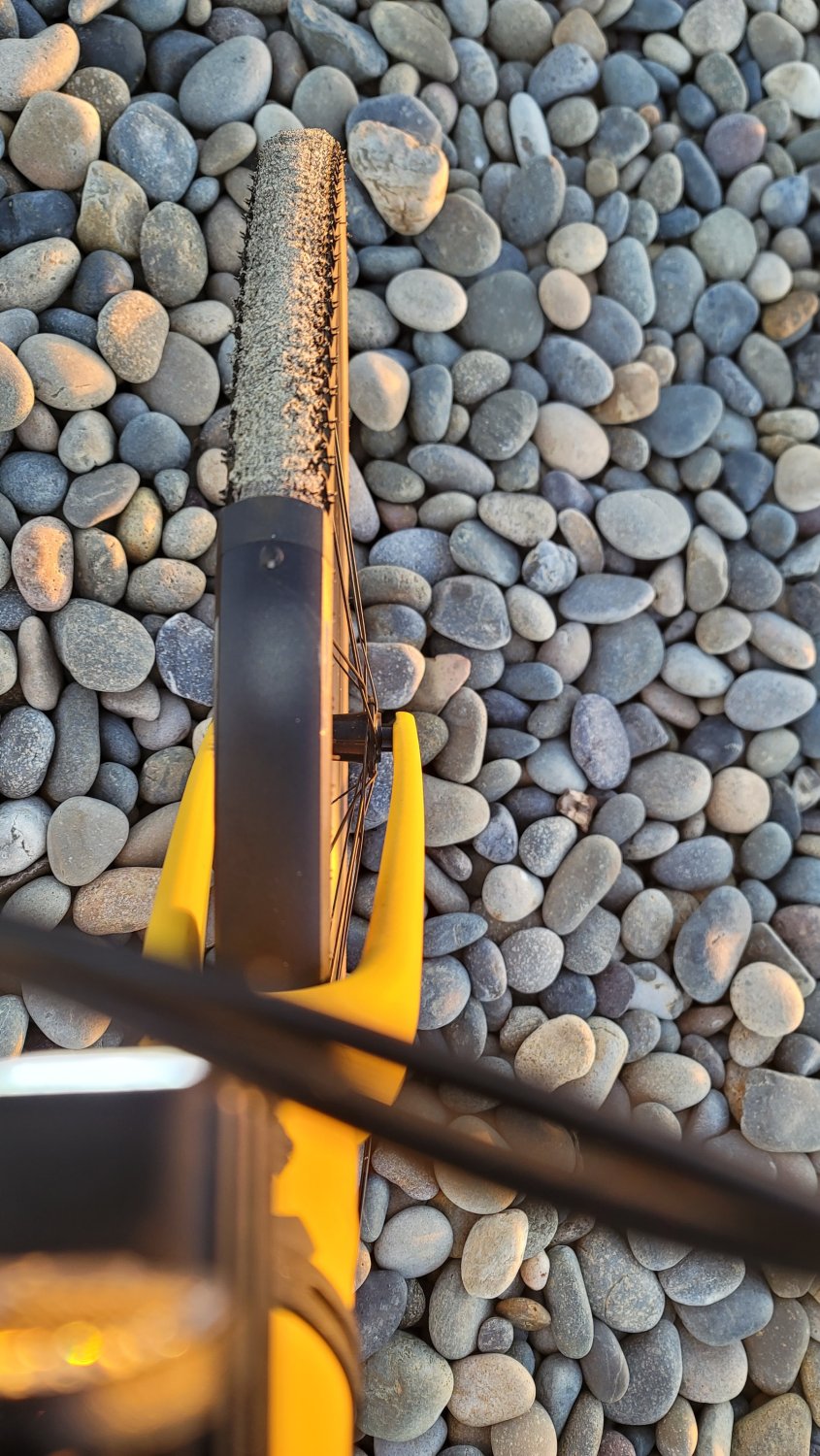

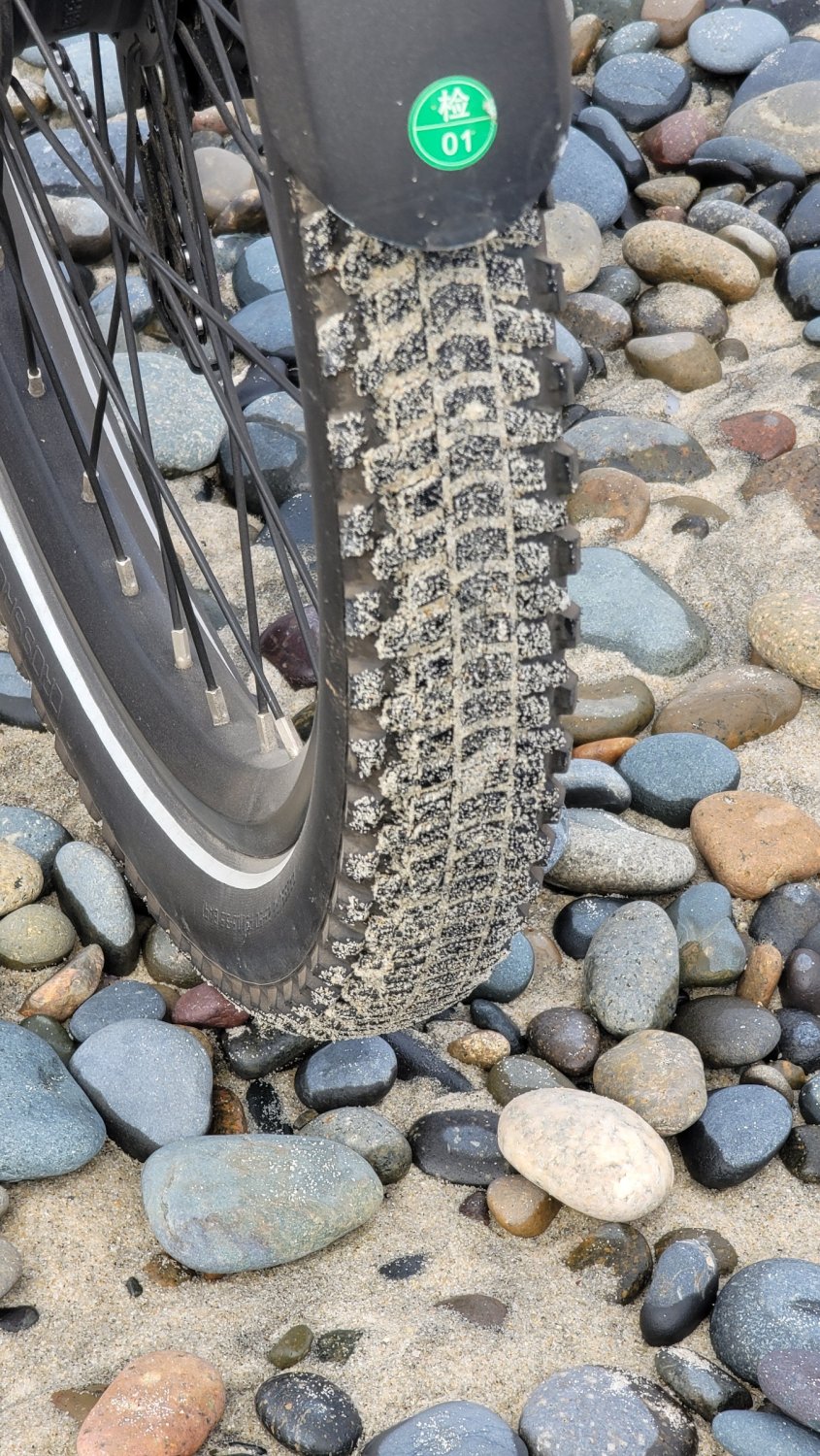

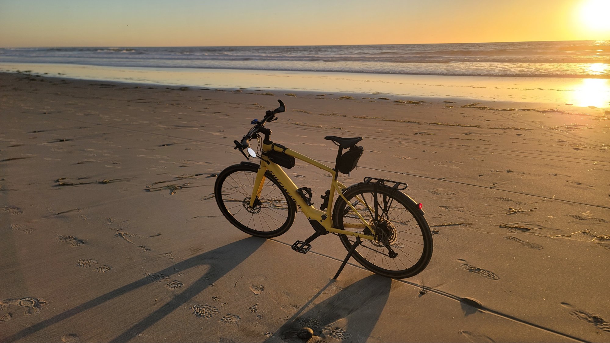

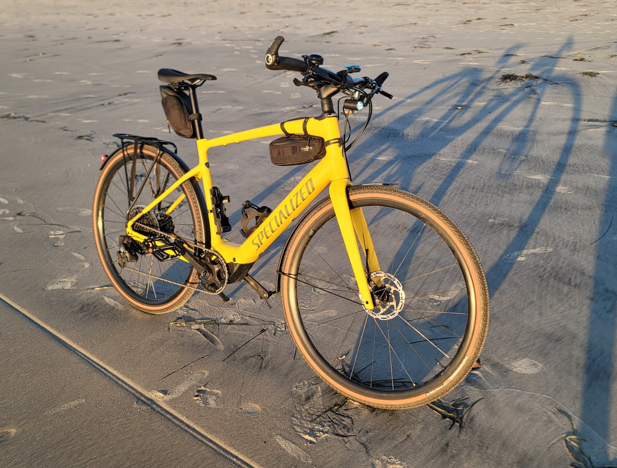

No experience with 3" tires, but the 27.5 x 2.35" hybrids on my 70 lb errand/beach bike are fine on reasonably damp and packed low-tide sand.
So are the 700 x 38 mm (1.5") hybrids on the 38 lb gravel bike below.
As you can see, not much sinkage even at 1.5".
But they're both worthless on deep loose dry sand and loose sand-free cobble like that above.
However, none of that keeps me off the beach. Just walk the bike till you're on stuff you can ride. Your ebike's walk mode is your friend here. You'll soon learn to read the sand.
