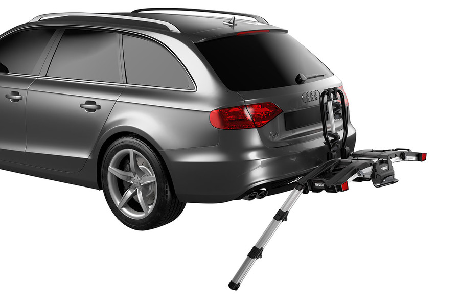

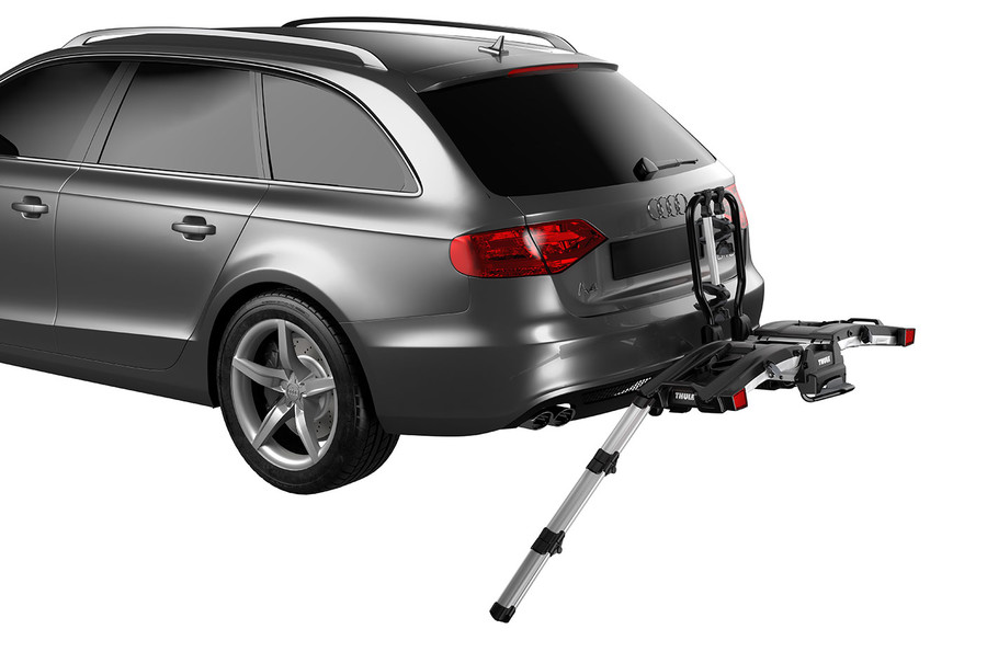

I use the Thule Easyfold 2 - It is rated at 65 lbs. per bike, comes with a folding loading ramp that attaches to the side of the platform. It clamps on the frame rather than the tire. It also has the best locking system that I have seen. It is one of the most expensive racks with a retail price of $750.

My complaint on the Thule Easy Fold, other than the price, is that the whole unit, when folded up to the center, doesn't then fold back towards the back of vehicle.
If you want to leave it attached to the hitch you're stuck with this >2' appendage sticking out off the rear of the car with only two red reflectors. If someone in a 4x4 truck isn't paying attention as they come to a stop I could see them bumping into it.

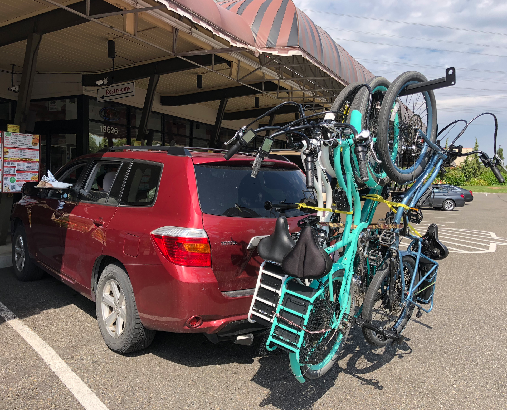

One rack not mentioned that can carry two ebikes and more is the Upright Designs rack. I've posted about it here before. Here it is, loaded four ebikes on it--three cruisers and a commuter. I don't remember quite what it cost. Around $350 I think--I got a discount by calling and asking a question about the rack.

@Amy ... a couple of things concern me about that rack. It seems like it would put a lot of stress on the fork and headset. Maybe there is some component that isn't obvious from the picture that is supporting some of the weight? Also, from the picture, it appears the bikes are hanging pretty low to the ground. Have you had any problems with dragging when approaching a steep grade, like the entrance to a drive?

Holly mother of God!!!... didn't even know such a thing existed... I bet there is a speed limit that you can drive your car/truck/van with that thing full of bikes. Cause I can just see you doing 75-80 mph and having the bikes come off one by one...Plus the bikes don't seem to be isolated from one another so they could be hitting the hell out of each other, especially on long trips. Also you may get the wheels hanging from the top out of true...especially for 65lbs ebikes... or even damage to those wheels (just a guess)... but I can see this may prove useful for groups, clubs and such that need to carry lots of bikes... or families with lots of bikes (don't know what the maximum weight allowed on it is). Thanks for posting it @Amy. You certainly win for the most unusual bike rack that can carry the most e-bikes.

We found they did fine--they are individually bungied to the rack--they aren't just clattering. There is a cross-bar that isn't evident in my photo, and each has its own built-in place to put each lower wheel.
Wheels/rims did fine hanging from the rack. We did not have any interest in driving 75-80mph with bikes on a rack--we stuck to speed limits and highways/roads had good quality pavement. :)
As for stress on the hitch, this rack requires a class III hitch. Class III is a minimum of 500 pounds. Ours is rated even higher than that.
We liked how visible the bikes are from in the car. You CANNOT drive into a garage with this rack attached.
As for how low the bikes hang (clearance from the ground), we had no difficulties with a very steep driveway at the rental house on our vacation. Our car required the extension piece, which we ordered with the rack. There are instructions on how to determine if one's car needs the extension piece.
We are satisfied with the rack. It does take us two people to load, but we bought it for vacations when we take all four bikes. Otherwise, we don't need a rack to hold all of our bikes--we do most recreational riding from home, or with just two of us at a time.
