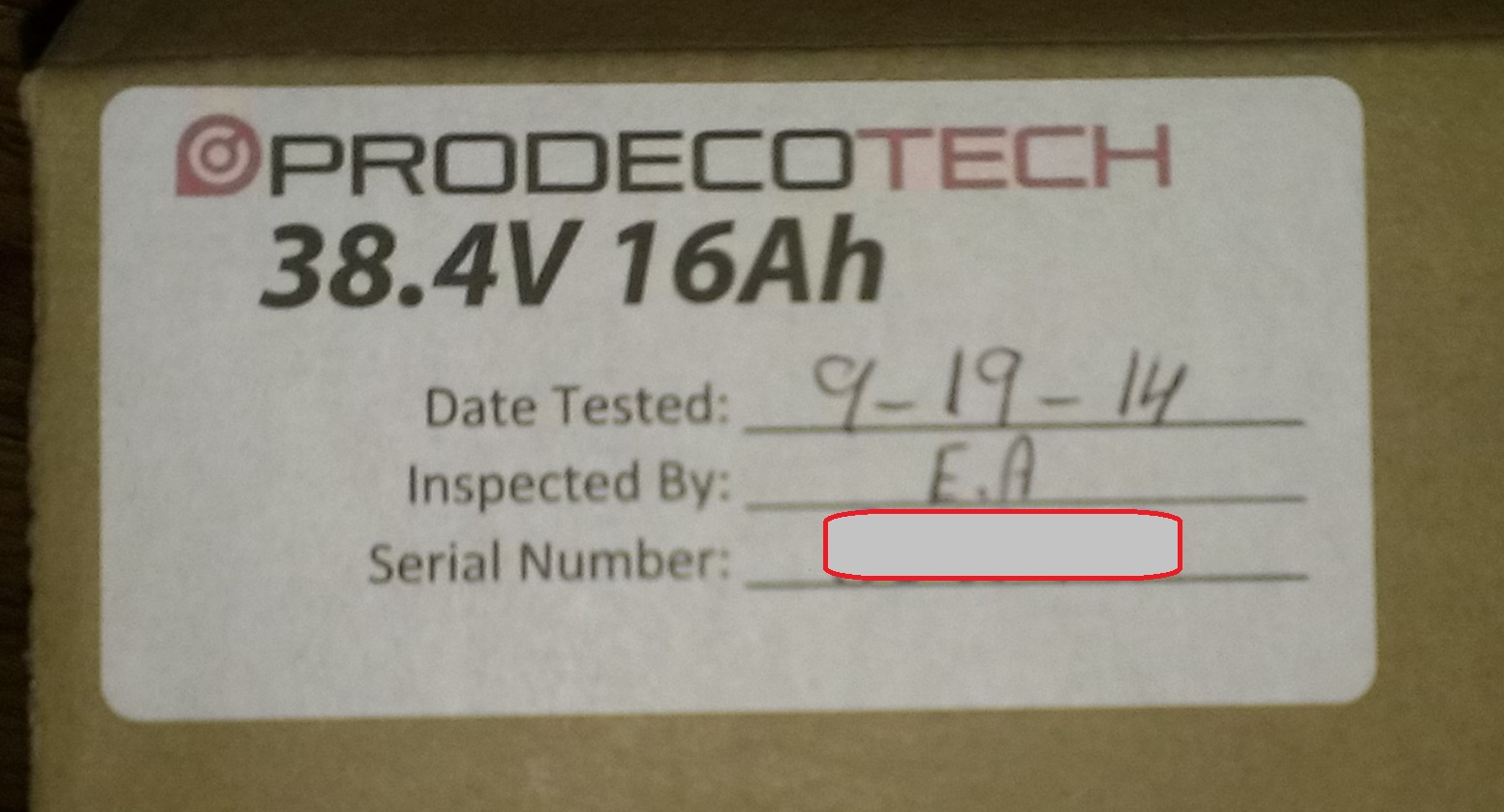

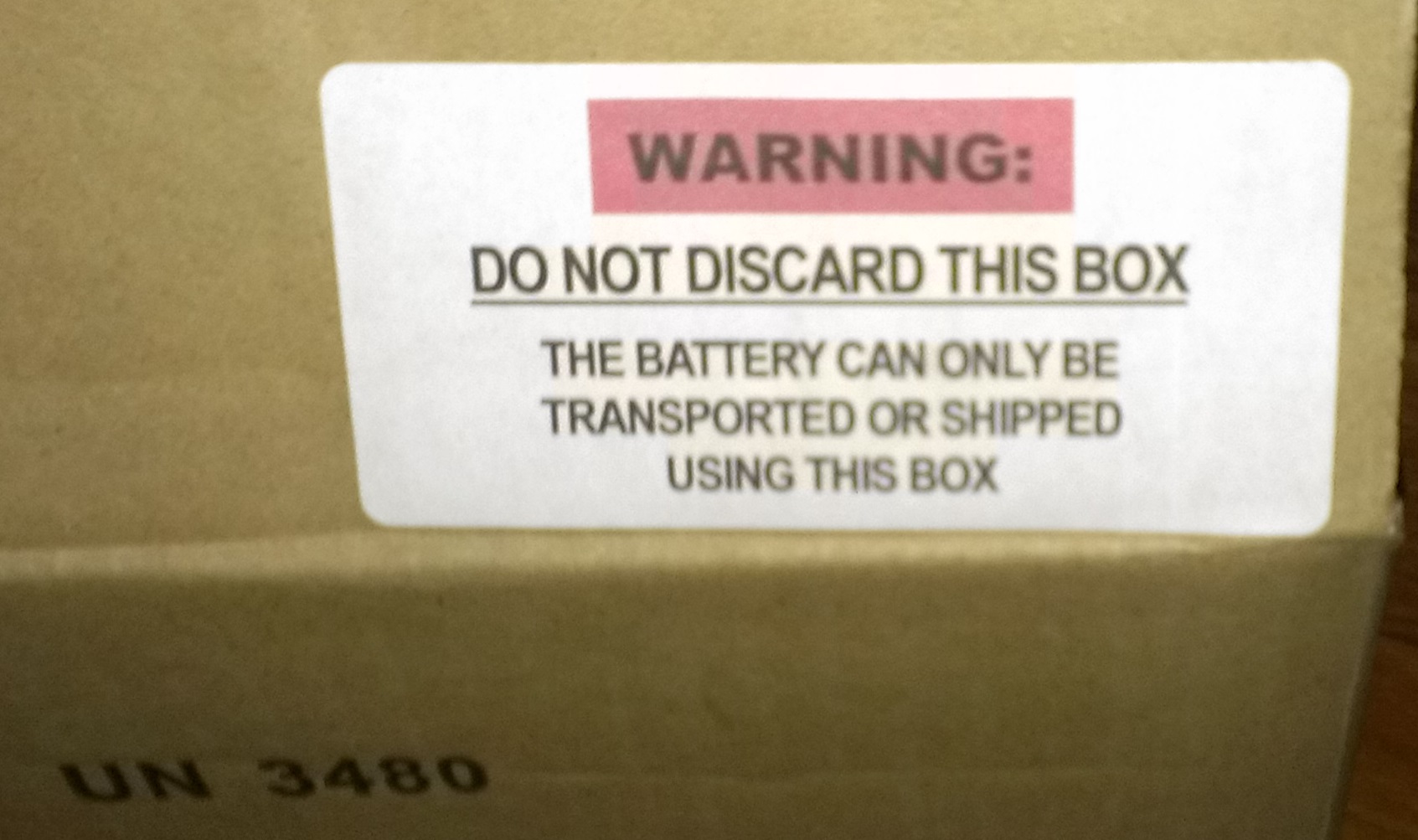

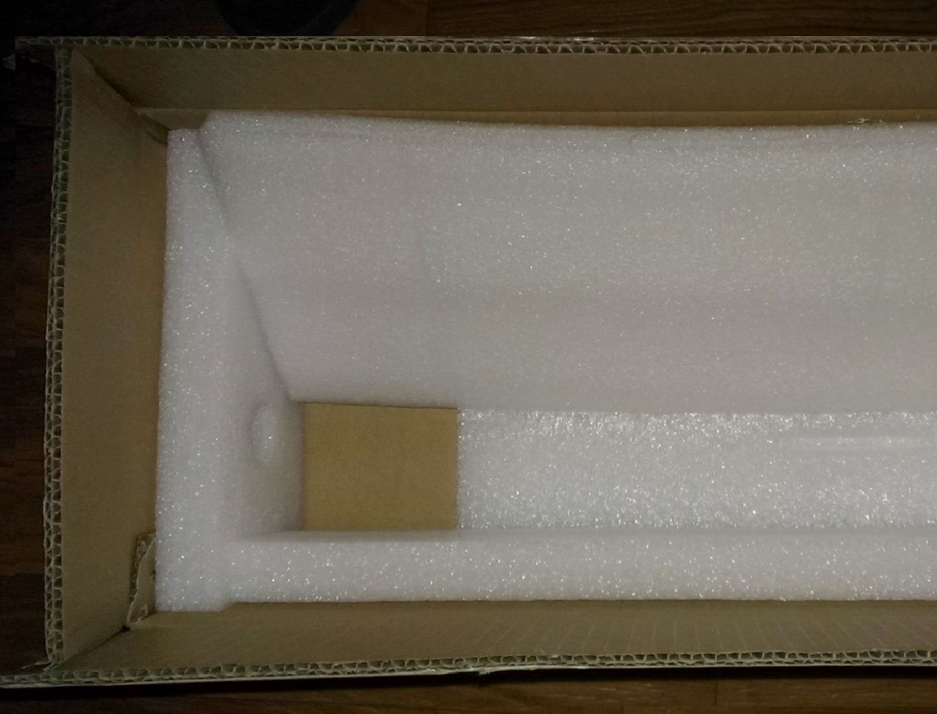

George, that's great to see! I'm not too surprised to see some (likely most) battery shippers are trying to ship within the ever changing regs. I had both of my ebikes (Easy Motion & ProdecoTech), with batteries shipped to me and both were done in the same way and by ground. Not only does it need the proper documentation and labeling, but the packing materials have to be of a certain type and grade.
View attachment 5086 View attachment 5087 View attachment 5088
