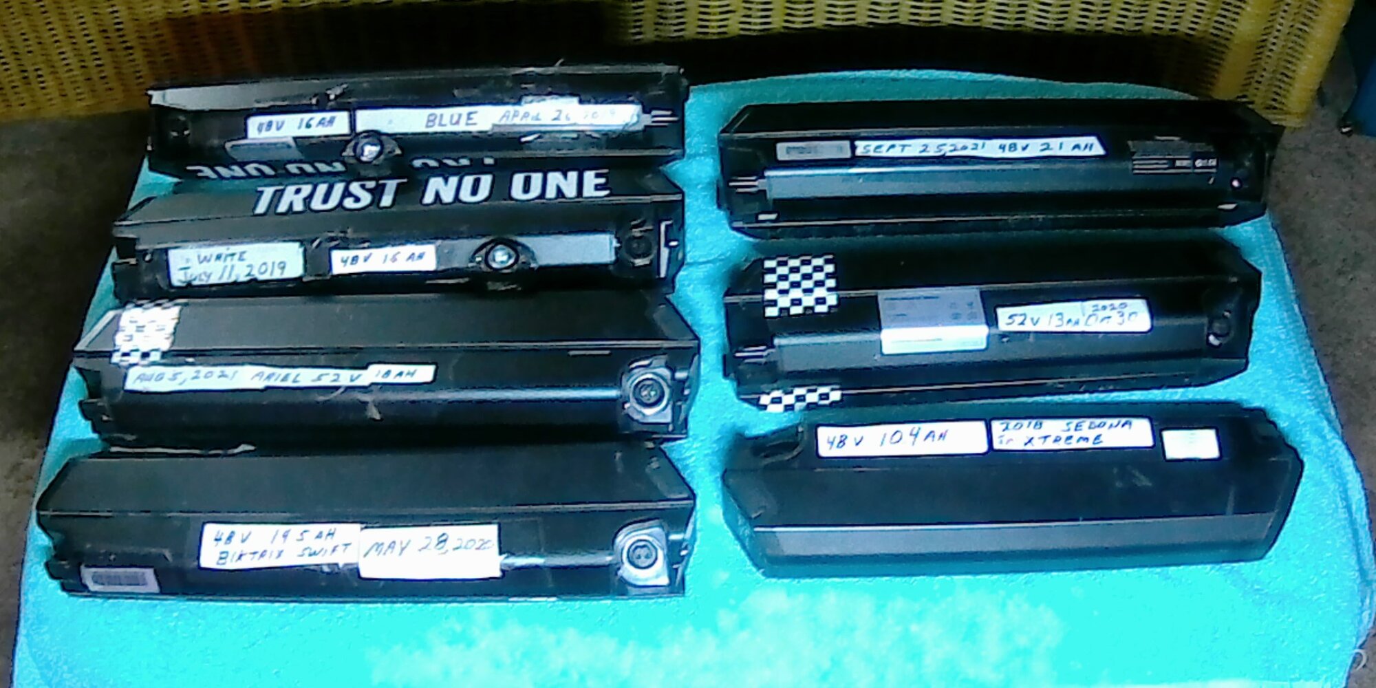

3rd, the 52v, 18ah battery: I currently own 8 ebike batteries.
One is a 36v item that is not even worth mentioning.
Five are 48v; a 10.4ah, a 14ah, two 16ah, and one 21ah.
Two are 52v; a 13ah, and an 18ah(from the X-Class).
Each of these batteries, either as part of a complete ebike, or as a stand-alone item, have a charger included.
The 36v battery charger (plastic housing) would get so hot that I had to set a cooling fan by it to assist in temperature control. Needless to say, I soon progressed on to 48v ebikes and this 36v combo has long been relegated to “the bin”.
The 48v battery chargers are: One 2amp plastic housing unit. Two 3amp plastic housing units. Two 5amp aluminum housing/air fan cooled units-- they are the EOM equipment on my two M2S (brand) ebike monsters.
The 52V battery chargers are both plastic housing units. One is 2amp and one is 3amp(The X-Class).
I have never been a fan of the plastic housing units. It seems that they go “titz up” too quickly. By the way, the two M2S ebike 48v 5amp aluminum air cooled chargers are still just as dependable now as they were on day 1.

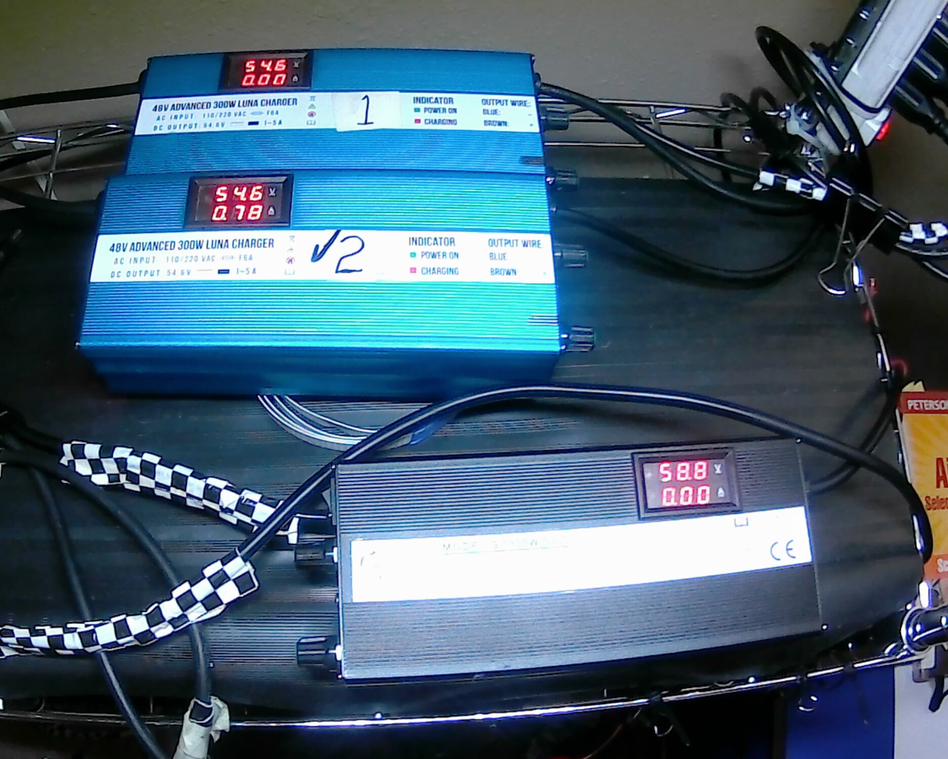

Now, more on my battery chargers. I also own 2 of the LUNA brand 48v multi-chargers (80/90/100% and 1,2,3,4, or 5amp): https://lunacycle.com/luna-charger-48v-advanced-300w-ebike-charger/ .
In addition, I own this 52v multi-charger (80/90/100% and 1,2,3,4, or 5amp) item: https://www.eco-ebike.com/products/52v-advanced-300w-eco-charger-1-to-5a-80-90
Why the need for so many different chargers? Well, for starters, the plastic housing units are pretty much crap. If used on a (nearly) daily basis (as I do),they will stop working in short order. Being ever cautious of potential fire hazard, especially when lithium batteries are involved, I prefer to err on the side of caution. Thus the additional multi-amp fan-cooled chargers.
As my plastic housed units began acting up, I decided to go ahead and buy the two LUNA 48V multi-amp chargers (2 months apart). Sad to say, 10 months after buying that first LUNA unit, it suddenly stopped functioning on the “3 amp” setting. Bummer deal.. Needless to say, LUNA's after-the-sale attitude is rather juvenile-- they have the “roadie cyclist” mentality.. I won't go into details, but I will say: DO NOT buy from LUNA.
Recently the 52v 2amp plastic charger bit the dust, so I decided to buy the aforementioned 52v multi-amp charger. By the way, I thought this 52v unit (in black aluminum) was the same brand as the blue aluminum 48v items, but its not. It (52v) has an on/off switch on the side.
2.1mmx5.5mm barrel connectors for battery charger: https://www.amazon.com/gp/product/B07D8T756C/ref=ppx_yo_dt_b_asin_title_o05_s00?ie=UTF8&psc=1
I went ahead and installed the aforementioned barrel connector and then commenced to charge the 18ah Reention Dorado battery belonging to the X-Class 52v ebike-- on the “5amp” with “100% charging” settings. NOTHING happened (green light still on, not red “recharging” light). What the ??? There are only 2 wires involved when wiring up the barrel connector. But, what the hey, I undid the cables and then connected them up again. Same results. I then plugged in the 13ah battery at the 5amp/100% setting. It worked like a charm. I then went thru the charging procedure on 4amp, 3amp, 2amp, and 1amp settings (all at 100%) everything worked as it should have. I then turned back to the 18ah Ariel XClass battery. 5Amps. Nothing. 4Amps. Nothing. 3Amps. Bingo-- everything works. 2Amps. All ok. 1Amp. All ok.
So, for some ridiculous reason, the Ariel 52v X-Class beast of an ebike apparently has a restriction of 3amps maximum when charging (or the battery itself is defective). This results in a 6.5 hour duration charging time if battery is mostly depleted. Being able to utilize a 5amp setting should reduce that time to 4 hours. Of all 7 of the aforementioned 48v and 52v batteries, each of them is able to recharge at 5amp or 4amp (or whatever) setting. The X-Class 52v/18ah battery is the lone EXCEPTION. Something is definitely not right. My 48v/21ah battery is at least as powerful as the Ariel ebike unit and it works fine at 5amp/4amp/100% settings (on the 48v LUNA chargers).

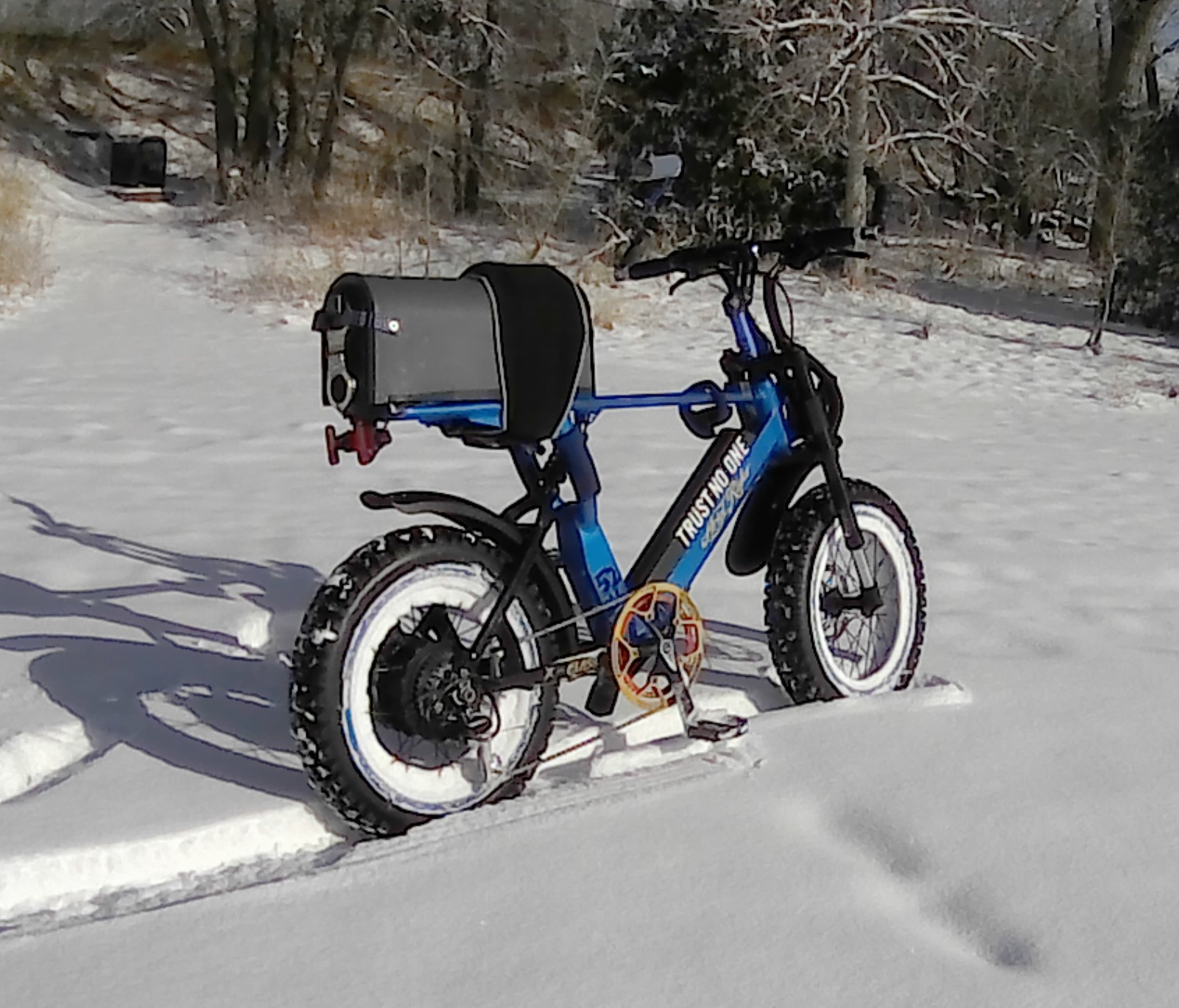

4th ..tire pressure: I recently went out for my initial ride in 6” of fresh snow a few weeks ago. Tire psi was 14.. The X52 performed flawlessly. After returning back to the condo, I decided that reducing the pressure down to 8psi would really be traction-worthy. Big Mistake!! At one point the wheel was spinning like a mutha.. The tire, however, was not rotating one iota. I ripped the valve stem right off the inner tube. Luckily I live right next to a city park that has a open area the size of 5 football fields to play on. So, I only had to walk/push the 80+ beast 200 yards instead of 10 miles (had I decided to do an extended out-an-back route).

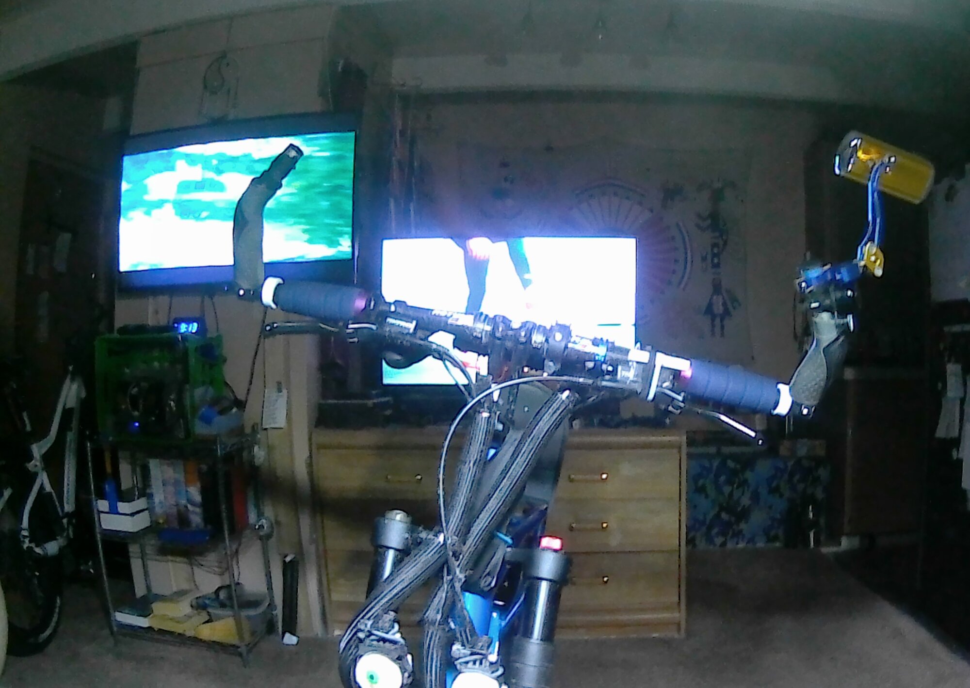

Finally, Here is a great way to clean up the mess of cables hanging all over the front of any ebike: Mesh 1” cable sleeve; https://www.amazon.com/dp/B08LPK1XQ9?ref=ppx_yo2_dt_b_product_details&th=1 This item works great. Looks great, too. If you use a sharp pair of scissors, there is no fraying to contend with. Also, when deemed necessary, I use 1/4” wide strips of duct tape at each end to keep everything tidy..
In regards to the photo (below) showing the mesh sleeves, you will also see two 42” tv's. In 1990, I owned a Panasonic 61” tv (the huge boxy style). It had a 21” picture-in-a-picture feature. Now, 30 years later, I just use 2 different brands of lcd tv (that way the remotes are tv set-specific). Plus, I just use over-the-air antenna stations (40+).
