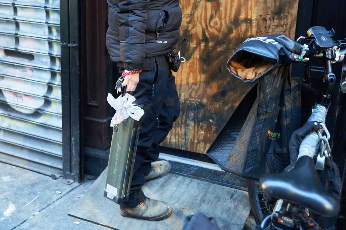

The quality of the E-bike battery is very important and it often dictates the longevity of E_bikes. Recently, a string of E-bike battery fires in NYC has prompted the legal agencies to take stricter measures. A detailed article on what exactly happened is presented in this article.
If you think about it, when one purchases a Tesla Model 3, you are paying about $275/kWh and get an 8-year warranty and liquid cooling technology. In comparison, E-bike batteries cost upwards of $800/kWh and come with only a 1-2 year warranty and minimal safety features. This has to change and will change in the coming years.
