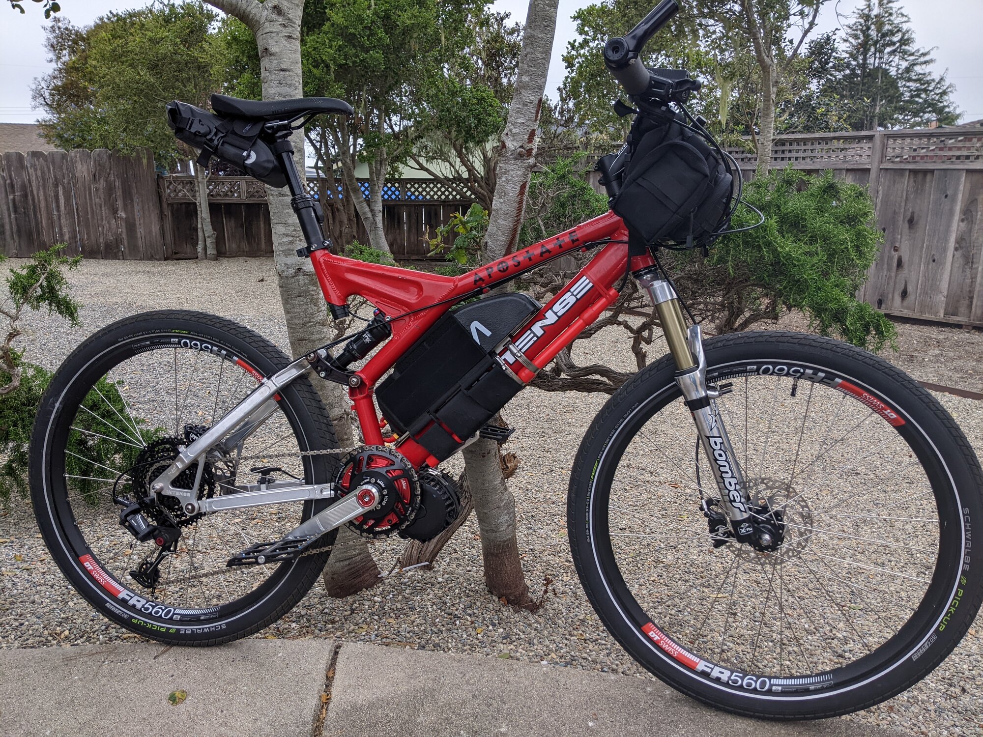

Why not open that battery case and check the assembly of the cells? Post a pic of your findings. Really like the looks of that MTB build btw.
Cuz honestly it sounds nothing like a battery issue. I wouldn't want to be taking a battery apart unless I knew I had something to gain by it, and the user's description of his problem sounds entirely like motor settings.
Well, keep it in the dark then.
