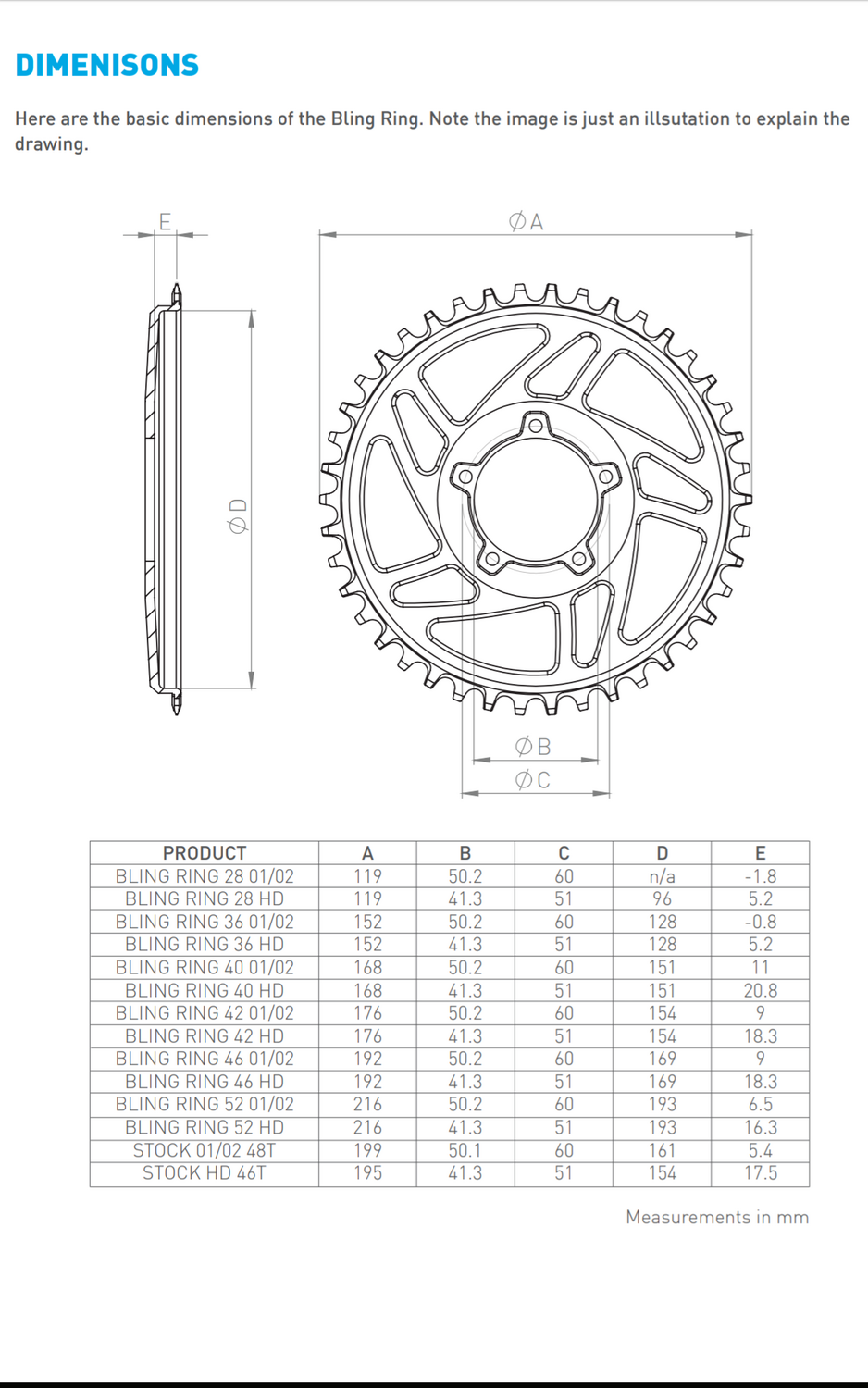

With the stock Bafang chainring on a fsmtb w/68mm bb my chainline was dead center of a 7sp. The stock ring I believe has a 5mm offset towards the motor.
So on a 68mm bb the chainline with the stock rings are 50mm from the center of the bike. (reference first # of D and F)
Those 104 adapters are flat and won't work without spacers behind them as the chainring bolts hit the plastic gear housing. I think you need to add 1-2mm but it still leaves the ring much further out.
If you mount the ring on the outside of the 104, it puts the ring about 13mm out from the stock ring.
In my opinion... The only other ring that might work is one of the expensive Lekkie Bling Rings.. But that will probably require spacers as well.

There are errors here, the Lekkie 42T offset is 18.5mm

I believe that the Lekkie would require 4mm of spacers to maintain the same. Screenshot_20210617-143437.png
