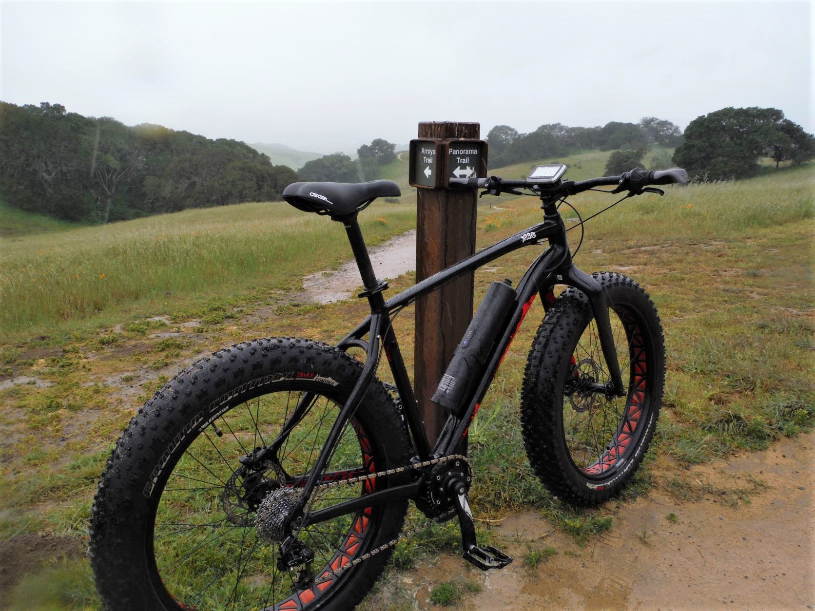

That chopper bike would stand out in Amsterdam. It is called a SIKK. It is a large bike. The owner is 120kg. It has a 750 watt 120 nm motor with a thumb throttle on the left. Okay here it another bike that is thru frame with a torque sensor and throttle on the left. I had to drill. You would also never see it in the Netherlands. It is also 750 watts. This one is called a FatBoy from Specialized. Oh, that lube is MucOff C3 ceramic dry lube.

Nice environment by the way! California is great.
In the tropics and by the sea and with an exposed chain with a derailleur, you need oil. Mobile 1 is ideal. I use that when I soak the guts of an Alfine or Nexus. Do you want me to stray off topic to show, 'Bad Dog'? I regularly use modified PVC tool extenders, but this one is special and uses a IGH cog.

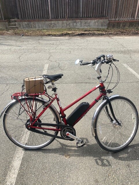

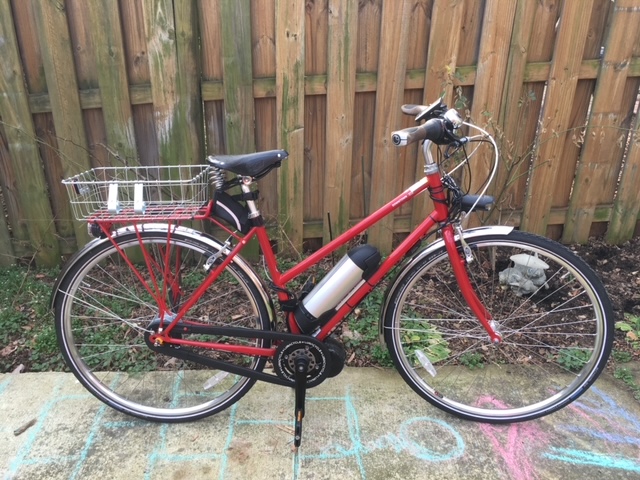

I've been running a BBS01 and 42t Luna front chainring on my bike, and the chainglider works for me. My bike is a work in progress and has changed over time as I've added Dutch components including an Azor drum brake fork and taller adjustable Ergomatic stem. Here are a couple of pictures showing my bike with the Nexus-8, then with the Enviolo. In my experience there is only a slight occasional rubbing noise that goes away if I adjust the rear piece a notch. When I had my shop swap out the Nexus-8 IGH for an Enviolo CVT I just needed to buy the different rear chainglider part and kept the front part, so 5 years and no plastic corrosion. The chainglider keeps my chain very clean in winter riding.
2018 with Nexus-8 IGH & BBS01
2022 with Enviolo CVT

Thanks for sharing your experience.
So it doesn't make as much noise as some say? I still don't really know what I want to do. There are 3 more options and I have to think about it.
I had almost the same stem in my Gazelle.
Not that I notice while riding except only occasionally, and IMO it doesn't do either the chainglider or chain any harm.
Yes, I had wanted a Gazelle Switch stem but my bike has a 1 1/8" steerer tube, and the Batavus Ergomatic version fits that size rather than for a 1" steerer as used on the Gazelle stem.
I even fit a Widek crown steel bell... I admit I want a Gazelle ebike!

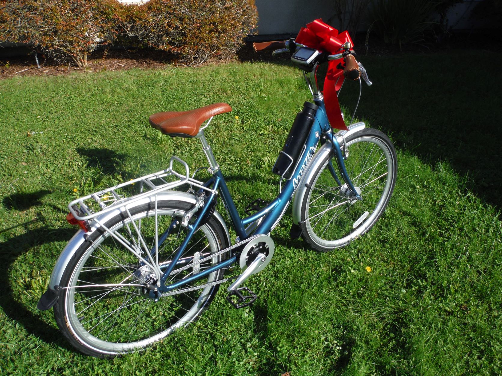

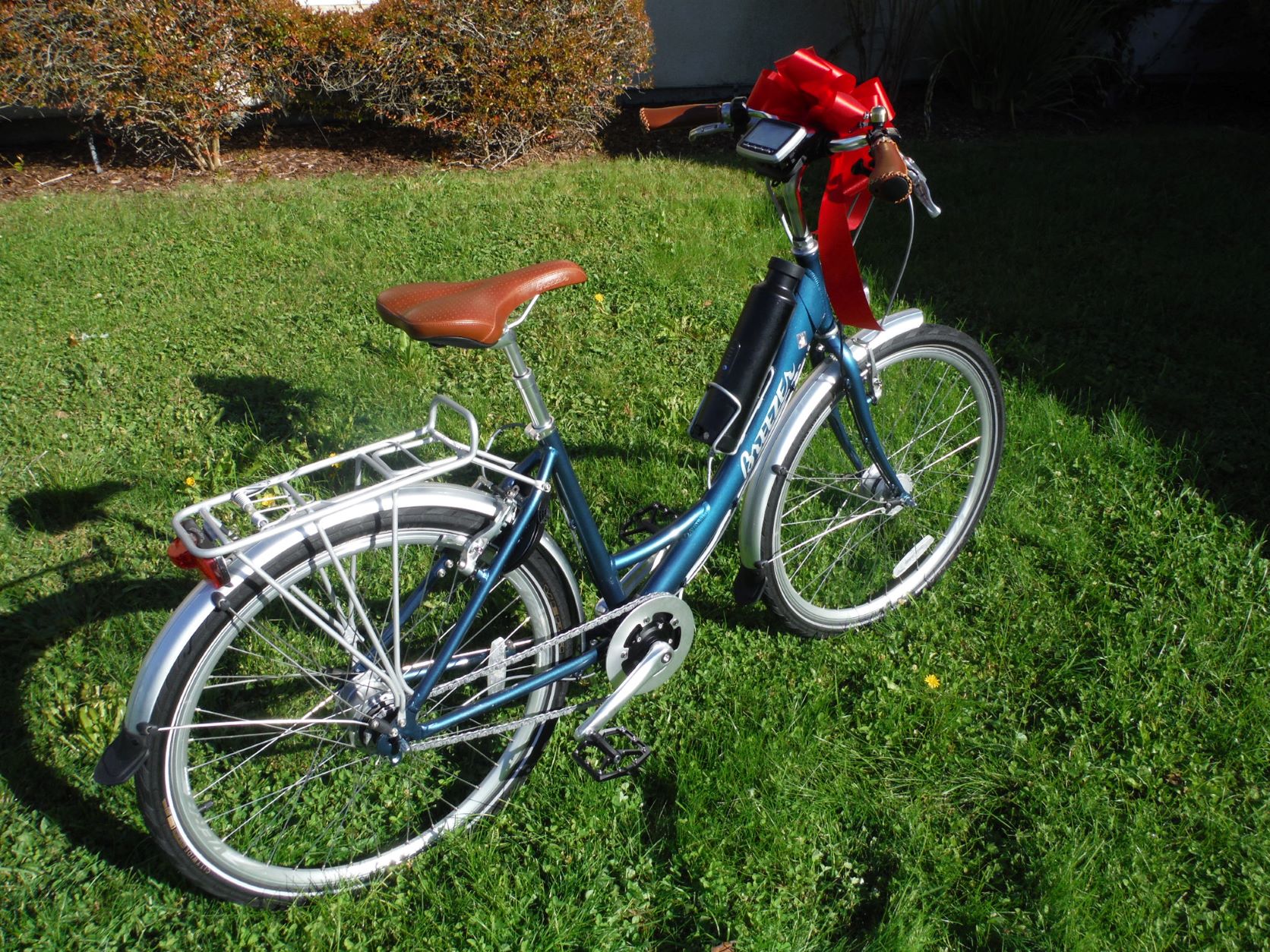

This one is all Dutch but it was designed in California. It is called a Breeser. By Joe Breese. It even has the lock and dynamo.
