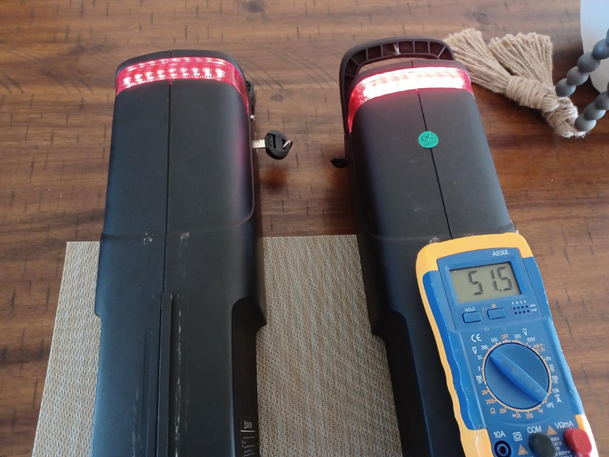

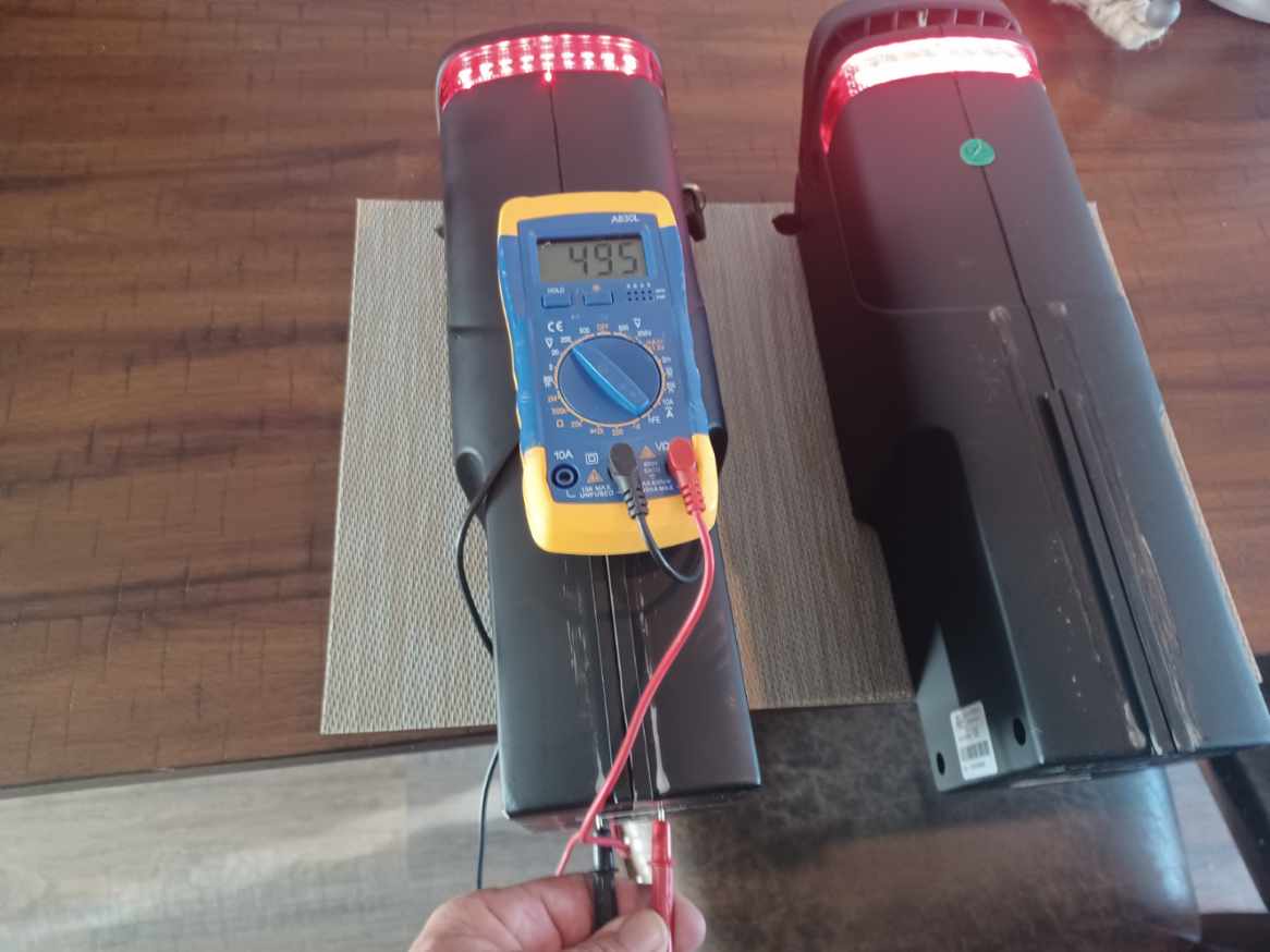

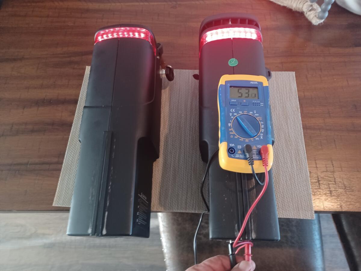

After a few weeks of sitting I tested the new battery against the old one.
Old battery still has more volts but i haven't charged either one since my ride
It was still cold outside so put 4 miles on old battery at #5 and throttle only
Started at 53 volts and ended at 51.5

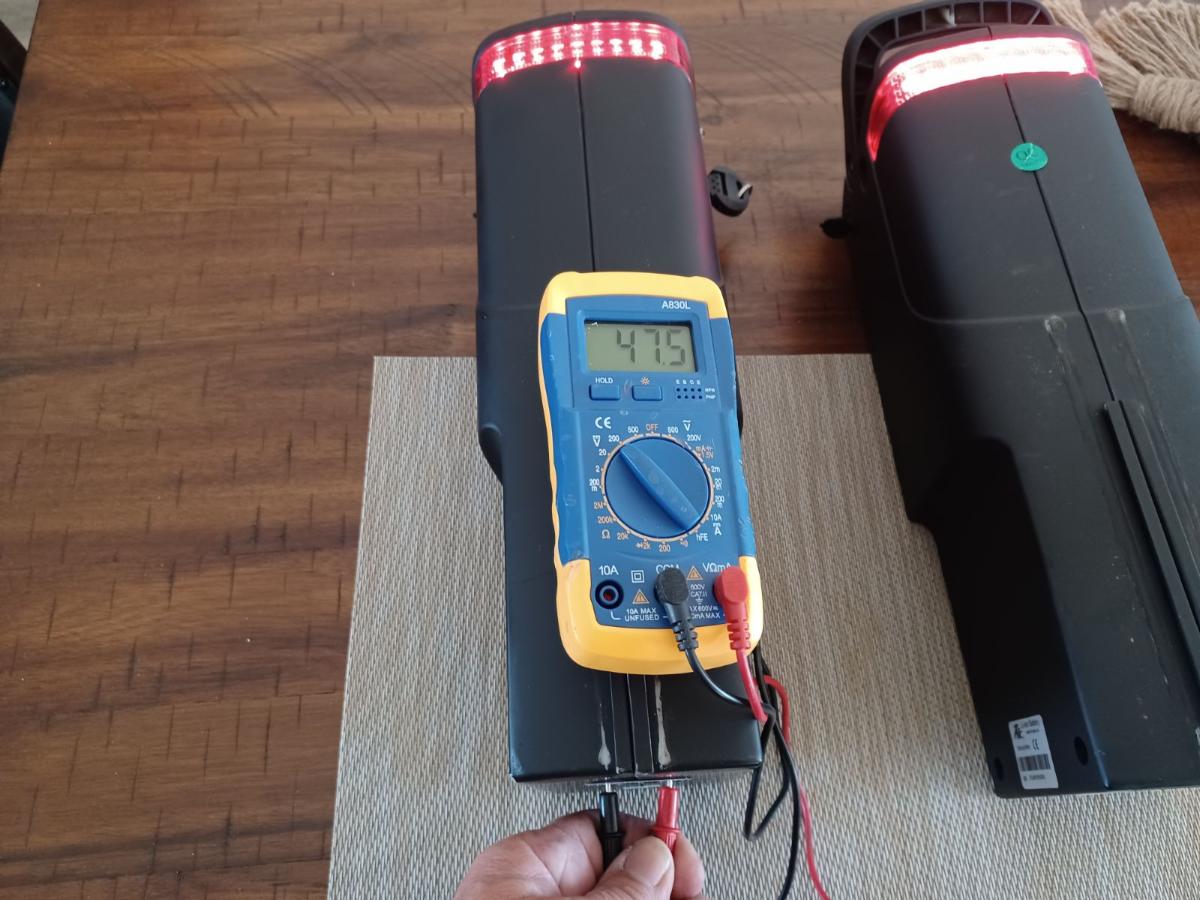

Tried the new battery the same at #5 and throttle only.
Got to 8.6 miles and started to cut out just like the original junk battery did
It was down to 2 bars on full thottle
Made it home fine in #3 and started to do some pedaling lol
Started at 49.5 volts
Ended at 47.5
Ecotric says everything should be fine unless it got down to 44 volts

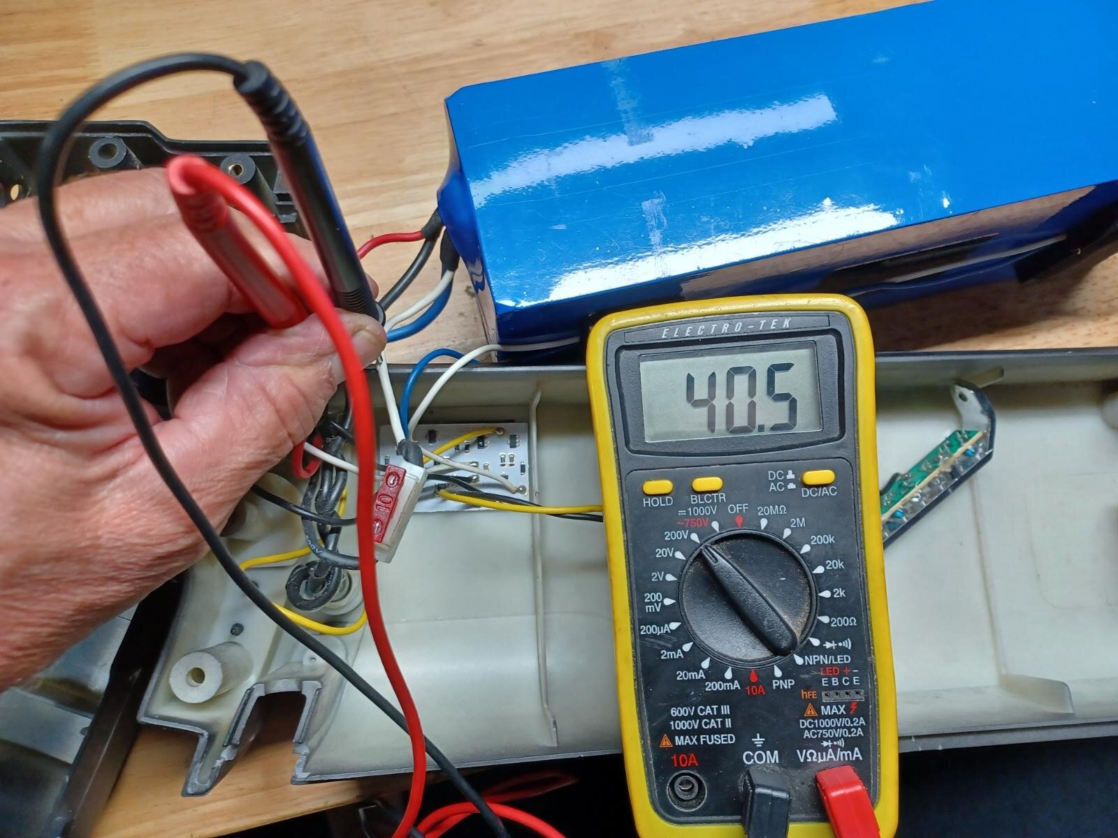

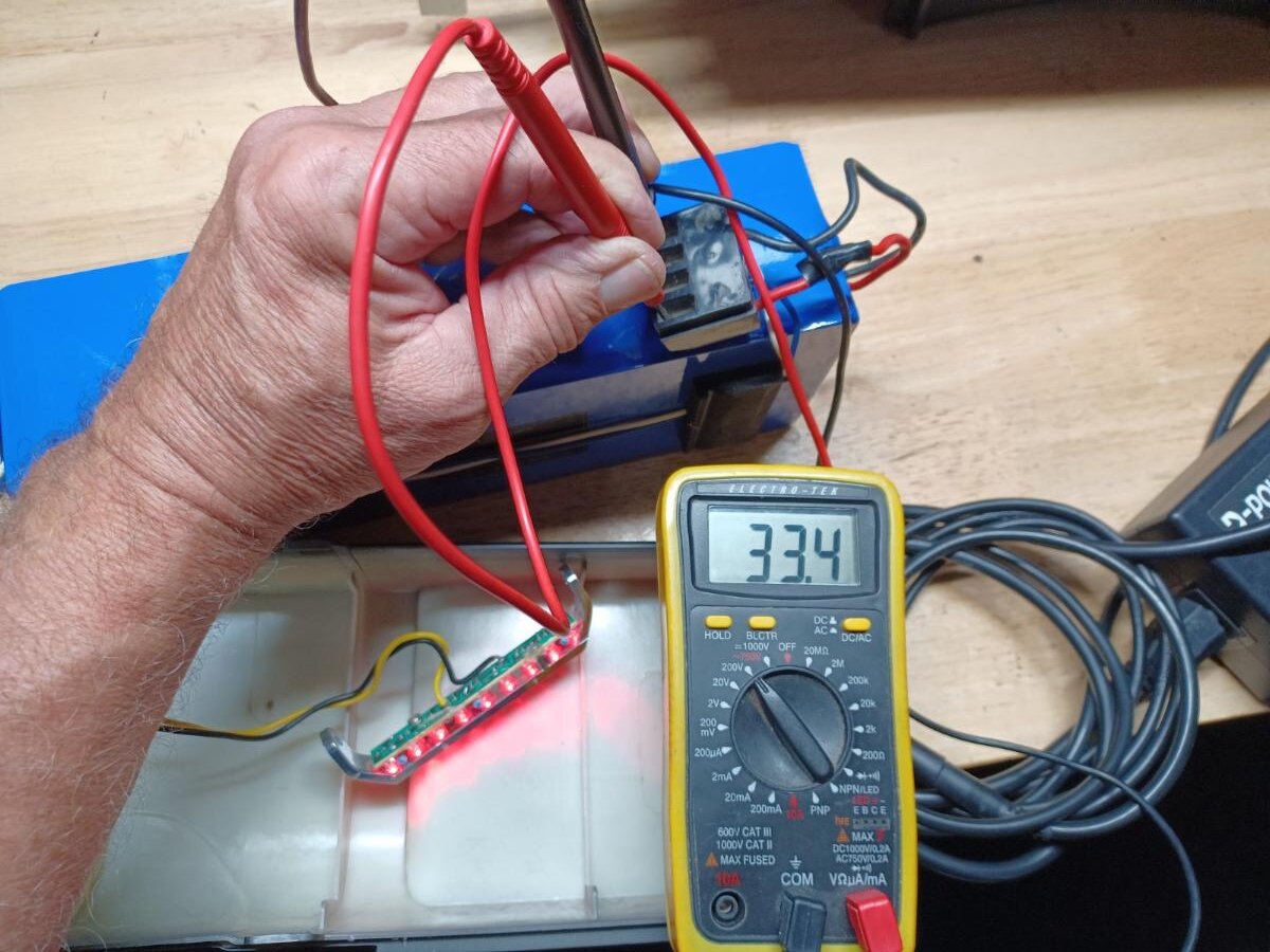

I did open up my junk battery again since you got me wondering
I can't find anything wrong with connections.
I have 40.5 volts at the top of the battery and 33.4 at the bottom
But my charger won't do anything. Green light is on to say fully charged
View attachment 149770View attachment 149771
Wow, so neither battery will charge? Maybe the charger broke. I have no idea. I would try testing the batteries on another tester. For both to fail is pretty incredible. Especially the new one. Show Ecotric those photos. I would double check the tester and the charger. If the charger light is green, does your bike screen show full? Come to think of it, when I first got this new battery last week and charged it, the charger light never would go from red to green. Yet, the screen showed it fully charged. I thought the charger broke. Then I rode it a few days and now it works fine. There is break in period for these batteries like Ecotric said. Maybe go riding and recharge a few times. May start charging all the way or you could have a bad charger.

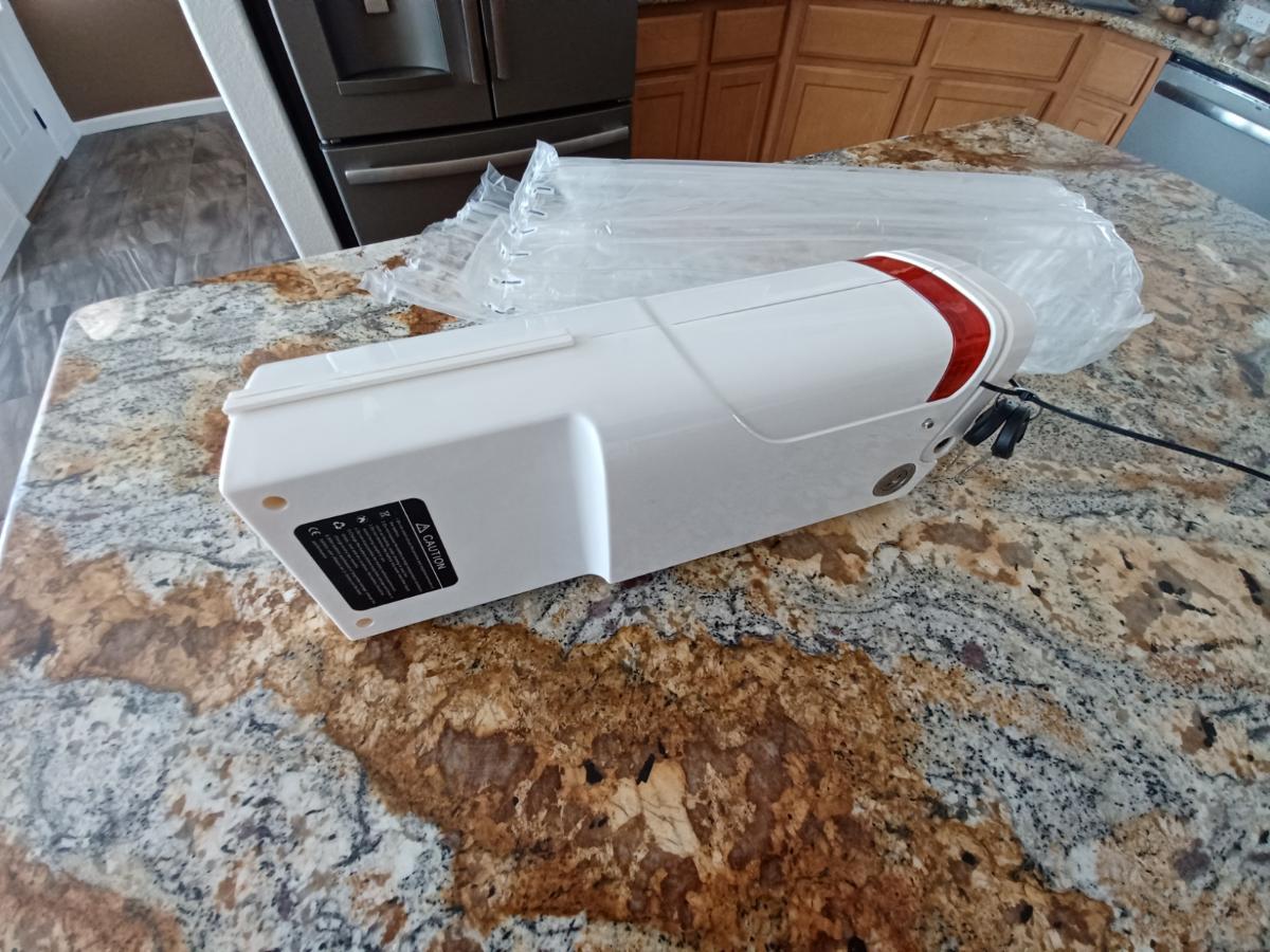

Ta daa!
Fast shipping
I think there was some miscommunication but it all worked out and now i have an extra battery.
Sometimes it's best to not say too much lol
Great! That bubble bag it shipped in makes a nice closed cushion for the battery if you decide to carry it or another one on a rack. Glad you got it. Charge that baby up and go have fun. Ecotric support rocks.
