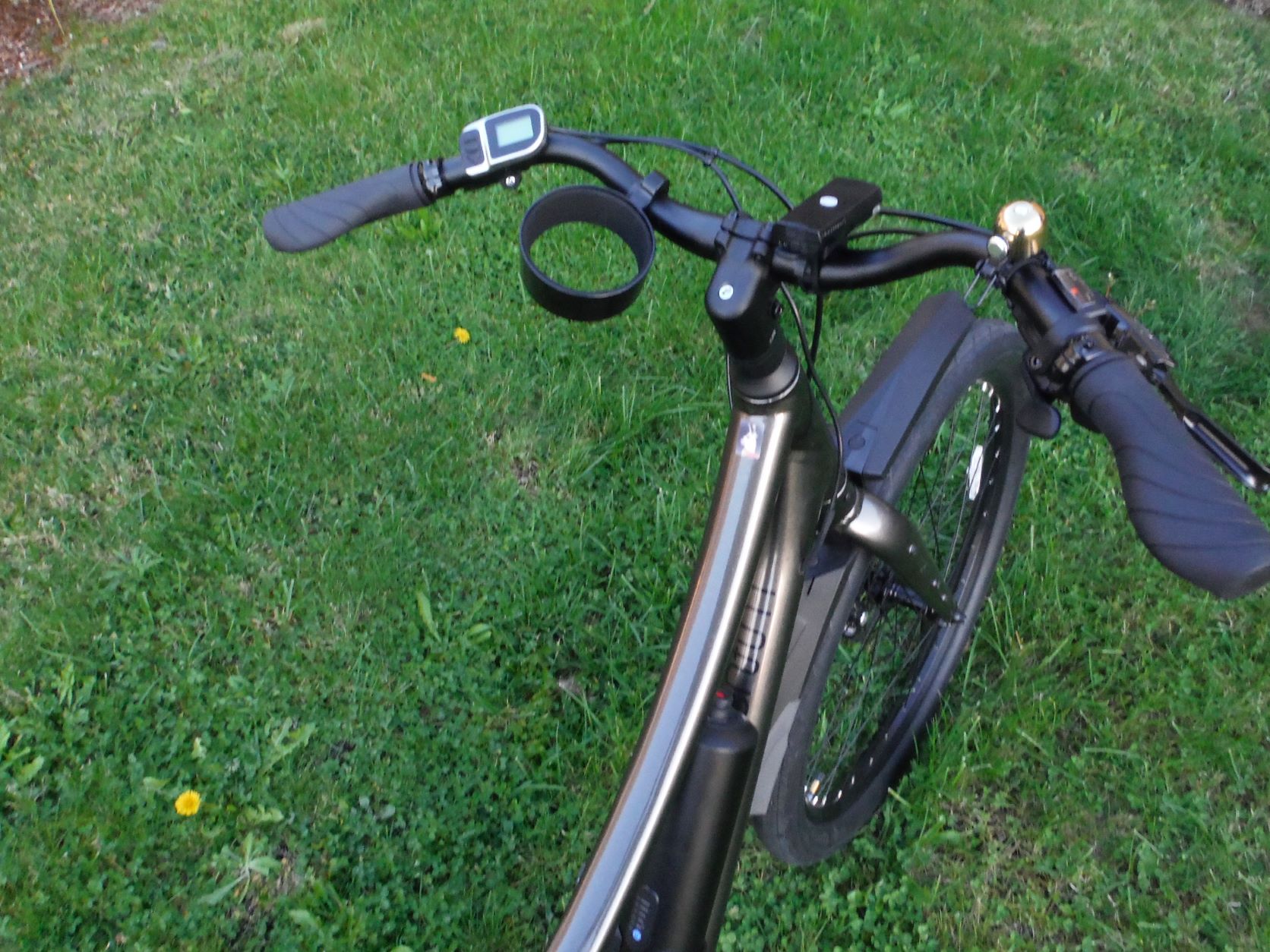

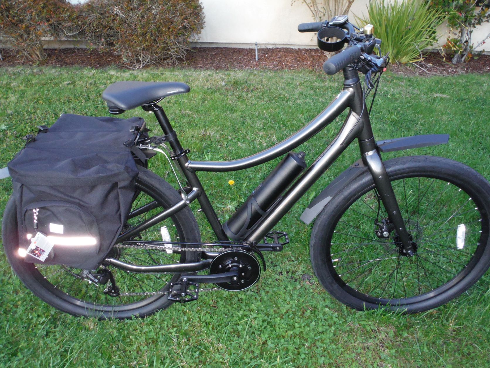

This illustrates the problem of proprietary battery cases. You are stuck. External batteries are much easier to work with. Rome is correct about photos. No photo and it didn't happen. Here is a bike with a 48V 10.5Ah 504Wh external battery with premium BMS and Samsung cells. It has a 750W 90Nm cargo bike twin cultch torque sensing mid-drive motor. Tom is the best. The photos are from yesterday afternoon.
