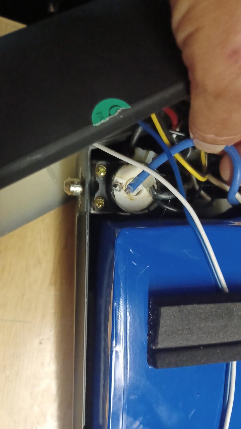

I decided to open up the old battery to see if there's anything obvious.
Sure enough! Poor workmanship killed this battery.
Broken wire on the main switch and a chaffed wire where the screw holds the case together at the bottom.
That's probably why it was surging until it died and i would get random voltage readings
Now it won't charge.
Oh well, new battery works good.
Did you solder the wire back onto the switch and tape up the scuffed up wire? Seems like that would get you a spare battery,
