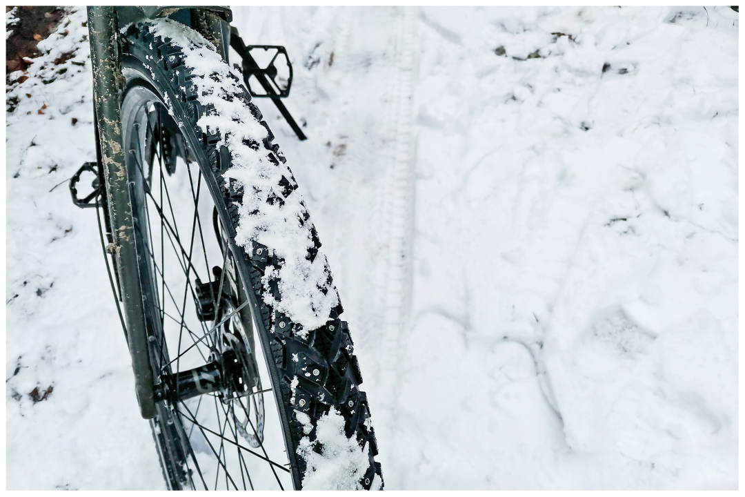

Ice Spiker Pro are not directional. Marathon Winter Plus are.
Thank you very much Randall for the explanation! It must be as you say.
It's certainly my interpretation of what i personally have experienced. I would suggest that there are certainly more experienced winter riders than I, and hopefully they'll add their own experiences and opinions to this topic.

Guys! Success! I've been working all day long (from 6 a.m. to 8 p.m. with an occasional nap in the afternoon). I thought to myself I became soft, so put the clothes on and rode out with my Monster (low pressure Ice Spikers). Snow got more packed by cars, making the ride safer. (Yes, bends were very dangerous because of accumulated snow). From time to time Monster was slightly drifting (when more snow was encountered). Interestingly, riding onto some rare ice patches made the studs sing and that was like angels were singing as that meant full traction being restored! :)
While the average speed during the Snow Calamity was 9.2 km/h, I got as much as 14.4 today. Big progress!

No prisoners taken! :) I'm very serious about all year round e-bike riding. My brother helped replacing my regular slick Electrak 2.0 tyres with Schwalbe Marathon Winter Plus, the studded 28x2.0" ones. With allowed inflation pressure of 2.5-5.0 bar, we chose 3 bar (58 psi) for better traction and smooth riding.
This morning, I had a chance to test the new tyres on snow & ice, at "black-ice" conditions. I was enchanted with the winter Marathons! Was it deep snow in my yard or thin ice on roads, studded Marathons held perfectly. For sanity (and to give the studs the chance to break in -- which disallows sudden braking), I rode decently slowly. No issues: just pleasure to ride! The biggest surprise was how quiet those tyres have been! (I had a single stronger braking - again, no issues).
Now I cannot understand how anyone can ride in true winter conditions without studded tyres... :) Yes, these are twice as expensive as the regular ones.

What you say Steve is true for regular (even wide) tyres. I had already had a crash like that -- precisely as you described it -- instant and face down. That's why I changed to Ice Spiker Pro. The studded tyres I'm using now just love having ice beneath them. It is because they get full traction just on ice. (Full suspension helps as well, as it ensures both wheels maintaining contact with the ground at all times).
I'm just back from a short grocery shopping at -14 C (wind chill factor -23 C). As Randall and PD said before, the properties of snow are much variable. My Monster rode on frozen packed snow just fantastically this morning! I actually was choosing ice patches for riding wherever they have been. I could watch front wheels of a car slipping at an intersection; Monster crossed the same junction just majestically :)
