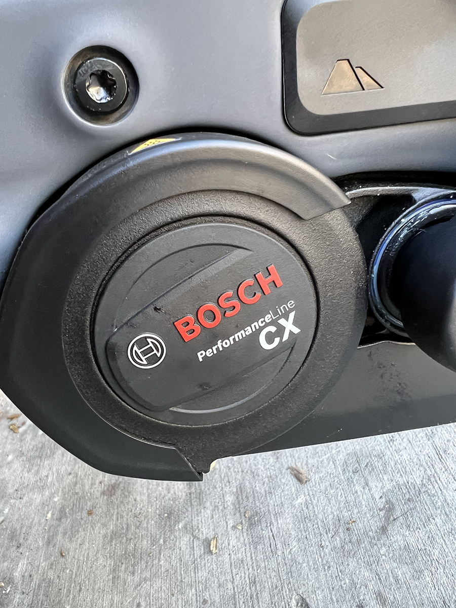

I just discovered the issue. the new Precede came with THE WRONG MOTOR!! its spec'd with a Speed and its actually a CX. I contacted Canyon via e-mail but they are of course closed on weekends. Absolutely nuts this happens but it did.

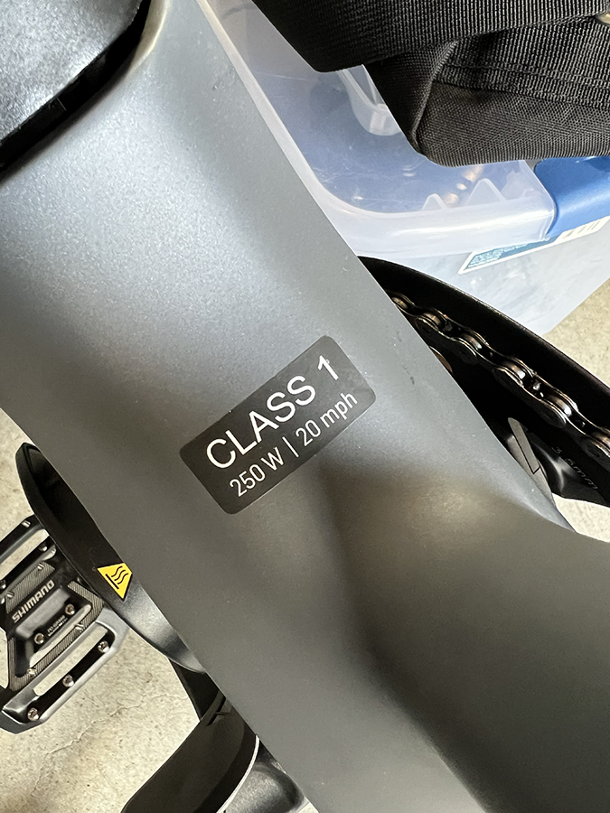

So just took it for a spin and it def pulls above 20mph so It may be as you stated above wrong cover which is nuts for German products (made in Asia of course). That said, it def does not pull anywhere close to my other bikes which are 29ers. Now Im wondering if the motor was programmed for 29" wheels and is off because the wheels on this new bike are 27.5. Its at least one level off on pull from my other bikes. to make it even weirder, this is the decal on the downtube. I know they were selling this bike (but with belt drive) in EU, and it literally just launched here last week so maybe thats all part of the confusion. Also, to add, I pulled the battery out and its the 500W, not the 250 as shown on the decal below.

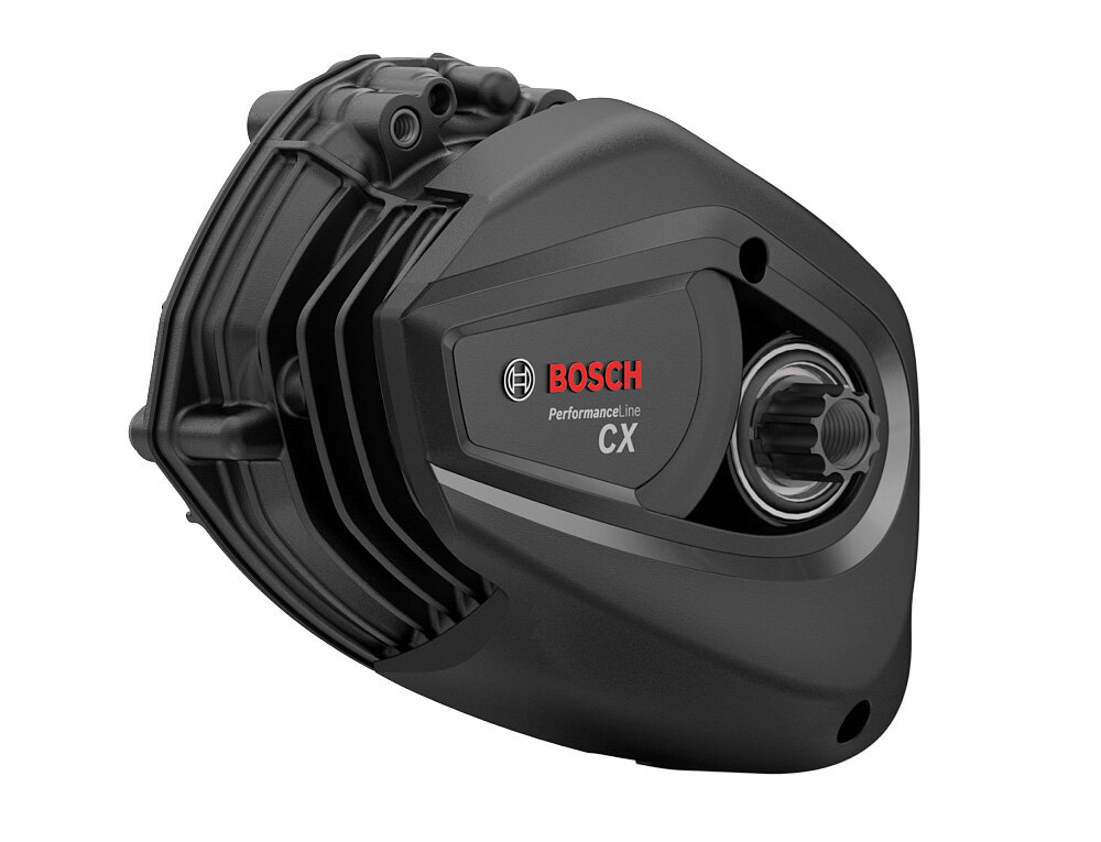

there is only one smart system and its a cx motor. the cx motor has cooling fins you dont see that on the speed motors. so it cant be the wrong cover. the performance and performance sped are the same looks

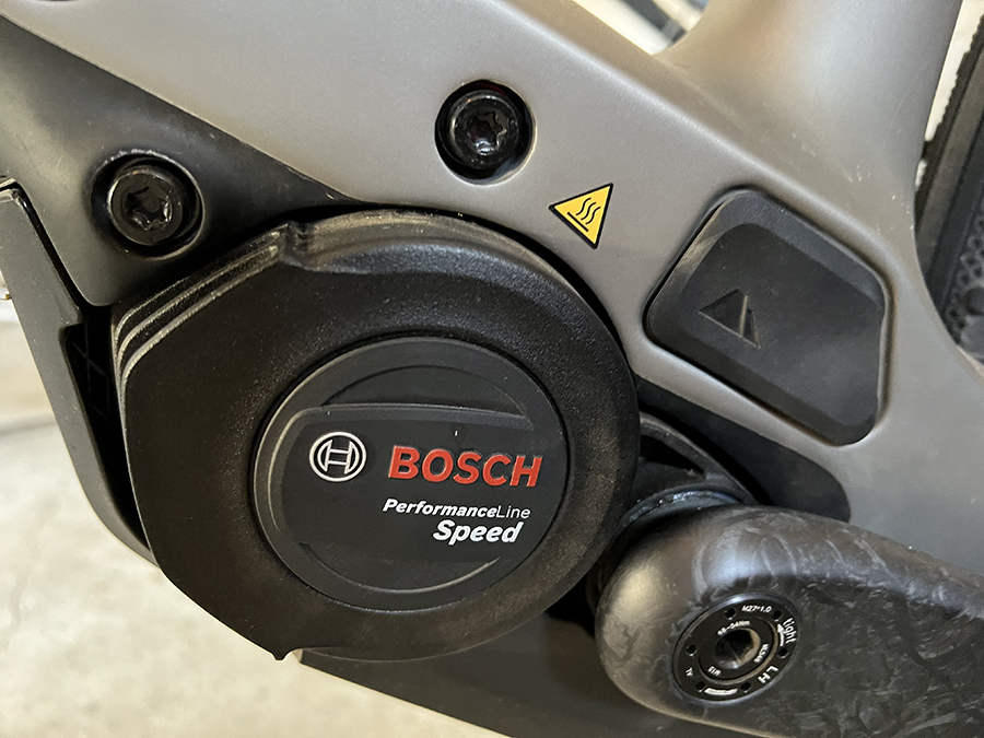

yea thats def not what I have. here are pics of both of my motors. the Speed is from my Grail and the "CX" is from the Precede.
