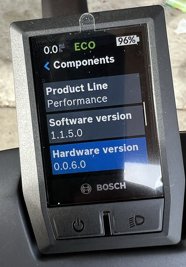

getting weirder and weirder. so when I check via my Kiox, the reading says simply "Performance", not Performance CX like it does on my Trek. However the spec is supposed to be Performance Speed unit. This bike seriously struggles up hills that my Trek and Grail smoke up. def something wrong here.

65nm will give away 1,2 gears on climb compared to 85nm when in Turbo
Also check you modes are all same as there are various settings

Apples to apples, on both of my other bikes I ride 80% in Eco mode and only use tour for climbing with no issues. However, this motor really drags up hills in Tour mode. I have to move to sport mode and it really drains the battery quick. its sounds like they put a 65nm motor in this thing. will know more once they open tomor and i can get ahold of somebody. Luckily, I live 2 miles from the US office.
Hey did you ever find out what's causing this? It looks like you have the CF 9 model - any thoughts on the CF vs the AL 5 model for sale?
I'm not an expert on motors, and I'm surprised that a motor would both put out less power AND drain the battery as much or more.than the more powerful motors you're comparing to...
