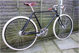

@Alanzo, Guv'nor! I love that Pashley. That is exactly the bike that I was going for when I made that red Public. Good eye. I even built a Nexus hub 8-sp wheel for it with roller brakes and click shift but couldn't get the matching front rim until next December. Alas, covid supply chain blues. A motor and battery adds ten pounds. With a secondary mount on the chainstays you be fine without welding. Firmware is open source, parts arrive in two days and cost 9x less. It is subversive in a fun way to be liberated of dealer dependency. Sometime do a Google search for Specialized 42V charger, then search 42V charger. If you want to see reviews that I cannot manipulate go to Google Maps, zoom in on the SF North Bay and search for ebike repair. You will see PedalUma and a link to the website for odd ball photos and information on builds.

As for the Pashley I never understood why some folks suggested that was a bad design due to the fork rake. That bike had excellent handling and was a blast to ride. Was a killer on hills due to the weight and 3 speed rear hub. I would have never been able to do a long ride on it had I cycled in your area with big climbs. I'll be interested to see if you ever acquire a Guv'nor and turn it into an e-bike.

@Alanzo, I have wanted to get my hands on a Guv'nor. No such luck. Six month wait times and big bucks upfront plus shipping. A Public V7i is $600. I did a Canadian version of a Pashley Princess Sovereign. And have done a number of three-speeds with handmade steel frames. Reviews on motors and batteries are scatter-shod because so many are knock-offs or seconds. It is like buying jeans off the sale rack that end up having an upside down, inside out zipper. The supplier is super important. One three pound battery will take you 50 miles at 18.2 Mph average with some hills, starts, stops at lights and traffic. Add a pound and you can go 1/3 longer. Taking two does not double range because you have added weight. But putting a 7-Speed Nexus in the Pashley wheel would help a lot. I love the fork rake on the Gov'nor. It is like piloting a long sailboat on chop instead of a dingy. I remove speed limiting controls so I can use a low nominal drain motor with seamless sweeps into huge peaks. Then top speed and climbing ability is a matter of drag and gearing. If you want to talk directly you can message me or contact me from PedalUma anytime. You have some cool bikes! The Gov'nor frame is made for Gates compatibility. Look for the frame break on the drive-side seatstay.

Is the Pashley the double toptube? That bike makes me drool like a court jester's fool. I would make it into a superior stealthy electric to blow past guys in spandex with $9400 bikes.

I bought the Guv from Universal Cycles many years ago. Single top tube. That was my first single chanring bike and I learned how to maintain the Sturmey Archer setup which different than Shimano components. I had Schwalbe studs for winter riding and a set of Woody's 3 tone fenders. Learned how to finish the leather bar tape with twine and lacquer and rode it with a Brooks saddle. Very retro. Beautiful bike that was donated to to a charity group delivering bikes to people in need. I imagine someone is putting it to good use that desperatley needed a bike.
