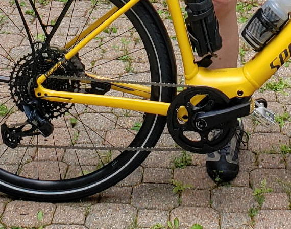

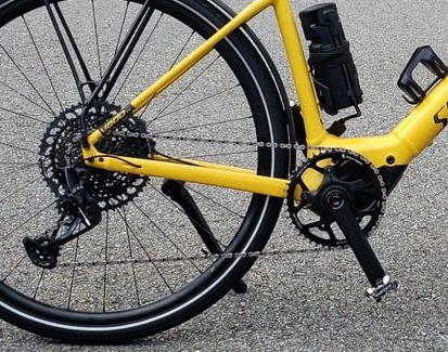

I have a fair amount of experience. My 2022 Turbo Vado SL 5.0 EQ came with SRAM Eagle GX shifter and derailleur. It had an HG freehub with SRAM PG-1230 11-50T classette and a 44T 110 BCD chain ring. I like to gear my Class 3 e-bikes such that the next to tallest gear (11th speed in this case) will max out the assist at 28 mph and a cadence of just over 90 rpm (comfortable for me). With the 44T ring and the 11T (12th gear) and 13T (11th gear) of the PG-1230, I found I was spinning too high on the 13 and the 11 was required for 28 mph, with nothing left over for descents at 30-35 mph.
I first upgraded my chain ring from the stock 44T to a Wolf Tooth 110 BCD 46T. I then found out that I could purchase an XD driver freehub from Specialized for around $75 and replace the freehub myself. Replacing the HG freehub with XD is as simple as removing the rear wheel and cluster. Then give a good yank on the freehub and it comes right off. The replacement slips back on (3 pawl ratchet) after thoroughly cleaning and greasing the ratchet and pawls. Next, install the 10t-52T SRAM XG-1275 cluster. I get better gear spacing and ratios on the top end (9th - 12th gears) with a lower "Granny" gear (52T/46T) in 1st. I also upgraded from an SRAM NX Eagle chain to an SRAM GX Eagle chain and used all 126 links instead of the stock 124 links. The last change (and a welcome one) was to switch from the standard GX shifter to a "single click" shifter. This makes both upshifting and downshifting sequential, with no "skipping" gears or accidental over shifting. This shifter is designed to help reduce stress on the chain and sprockets and provide a bit smoother more accurate transmission. I am very pleased with this conversion, even though the upgrades cost around $460 - tax and shipping where required.
Using the XG-1275 cassette, Wolf Tooth chain ring, and GX chain also saves a few grams over the stock Vado SL 5.0 and SRAM NX components. Since I added a fair amount of weight elsewhere to my bike, I haven't bothered to do any fine calculations.
The Parts List:
Wolf Tooth 46T 110 BCD chain ring - $69.95+shipping+tax (eBay)
SRAM XD-1275 cassette 10t-52T - $231 (list price) - multiple sources
XD Driver for Specialized hub - approx. $75 - Specialized shop
SRAM GX Eagle 12-speed chain - $36 - multiple sources
SRAM GX Eagle Single Click Shifter - $49 - multiple sources
