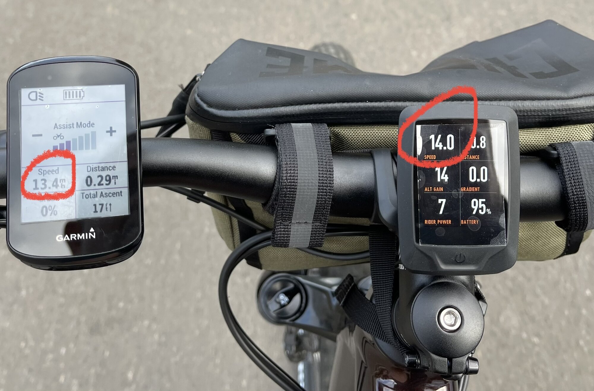

It’s set at 88.78 Inches. Here is a pic of the Garmin(13.4MPH) vs the built in computer (14.9)
It is strange. It is very very strange. That is, the value of 88.78"/2,255 mm that is the same as in my big Vado with totally different wheels (and which is totally wrong, too). Now I have a suspicion the number displayed in Mission Control is just a dummy that does not reflect the actual value of Wheel Circumference as stored inside the bike.

What you could do would be visiting the LBS and describing the situation ("My display gives significantly higher values of speed and distance ridden than GPS does. Can you fix it?") Turbo Studio allows adjusting the WhC inside the bike, and dealers have a table of Wheel Circumference for all Specialized tyres.

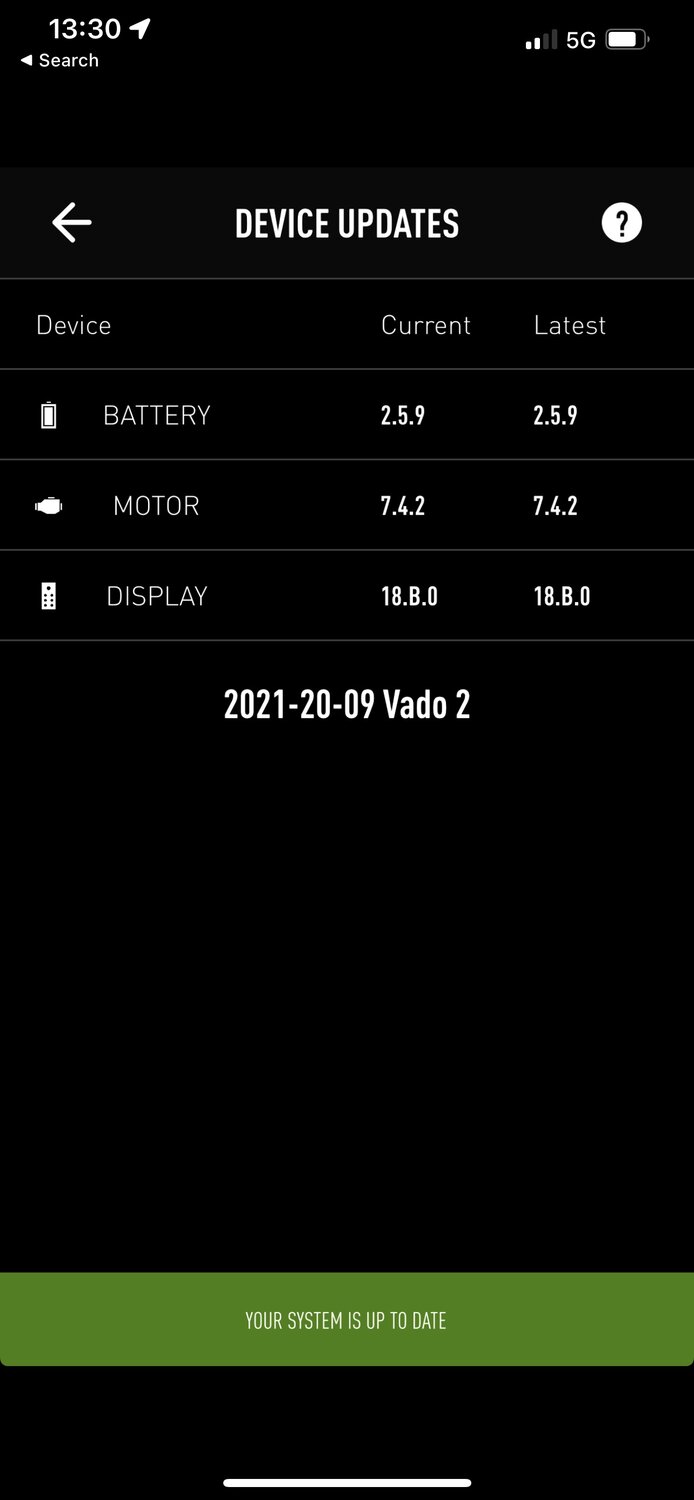

They never got back with me with a new circumference number but I went to my local bike shop and they measured the circumference and we looked on the chart. The two numbers were close so we went in between them and set it at 2300. After setting the wheel circumference I tried it against the Garman and the speeds were spot on. One other small note, I noticed that mission control shows my bike as a different kind. The local bike shop re-flashed the bike to be a tero but it still showed it was a Vado

As I said in another thread, pay no close attention to what Mission Control reads... :D I can bet there is no real communication between the engineering and programming departments at Spec!

I would expect some random variation in instantaneous speed measurements between two different devices because they are using two different methods to measure instantaneous speed. One is doing it mechanically and the other is doing it via GPS positioning data. And how the two computers smooth out or average out data variations is going to be different. But the distance measurement over say a 10k ride should be very close to each other if the specialized is properly calibrated. If one computer says you rode 11.2 km and the other says you rode 10.3 km then you have an issue.
