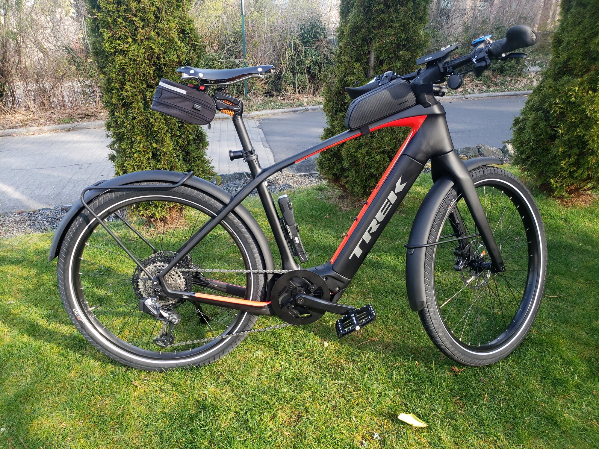

I added Trek's piggy back range extender battery set up to my Allant +9.9s. It was spendy at nearly $300 parts and labor. I already have an assortment of Bosch 500 watt power packs for my other bikes. It is the most integrated solution. It totally eliminates the issue of where to carry the battery when it is needed for a longer ride. It is fully integrated into the Bosch system with the power being pulled 5% from each battery back and forth, resulting in equal use of each battery and maximizing the range achieved. The range estimate reflects the presence of both batteries as well. No need to set anything up. The extra battery is detected and integrated automatically.
I kind of wish the whole receiver apparatus was not there all the time, even when the second power pack battery is not needed. It does detract from the bike's great aesthetics.
