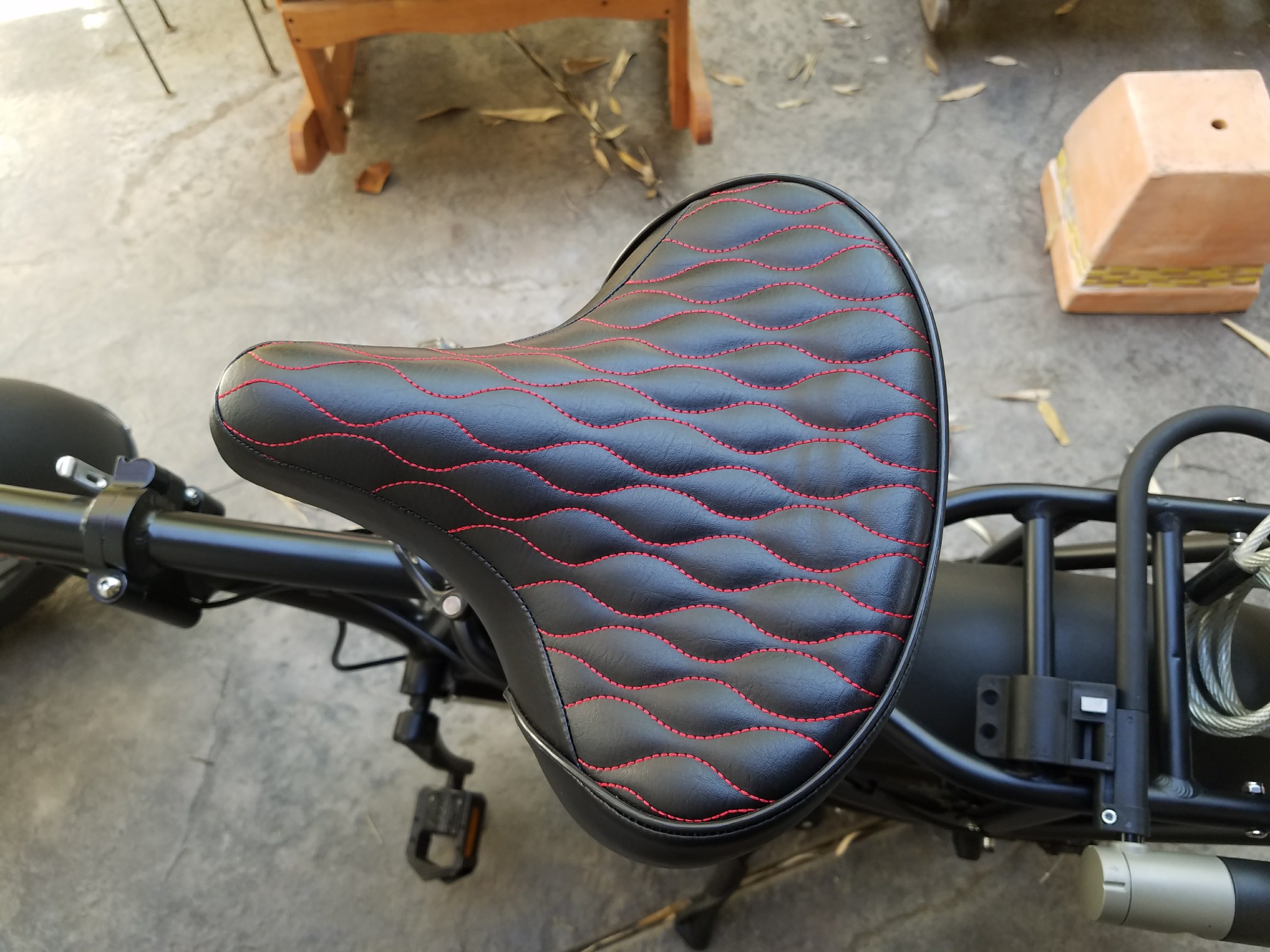

New to forum just testing some pics out this is my bike with new seat and post really makes for nice ride!!
