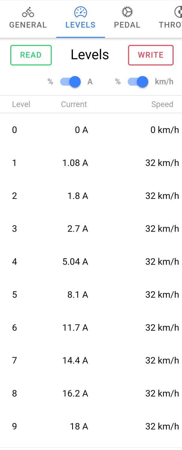

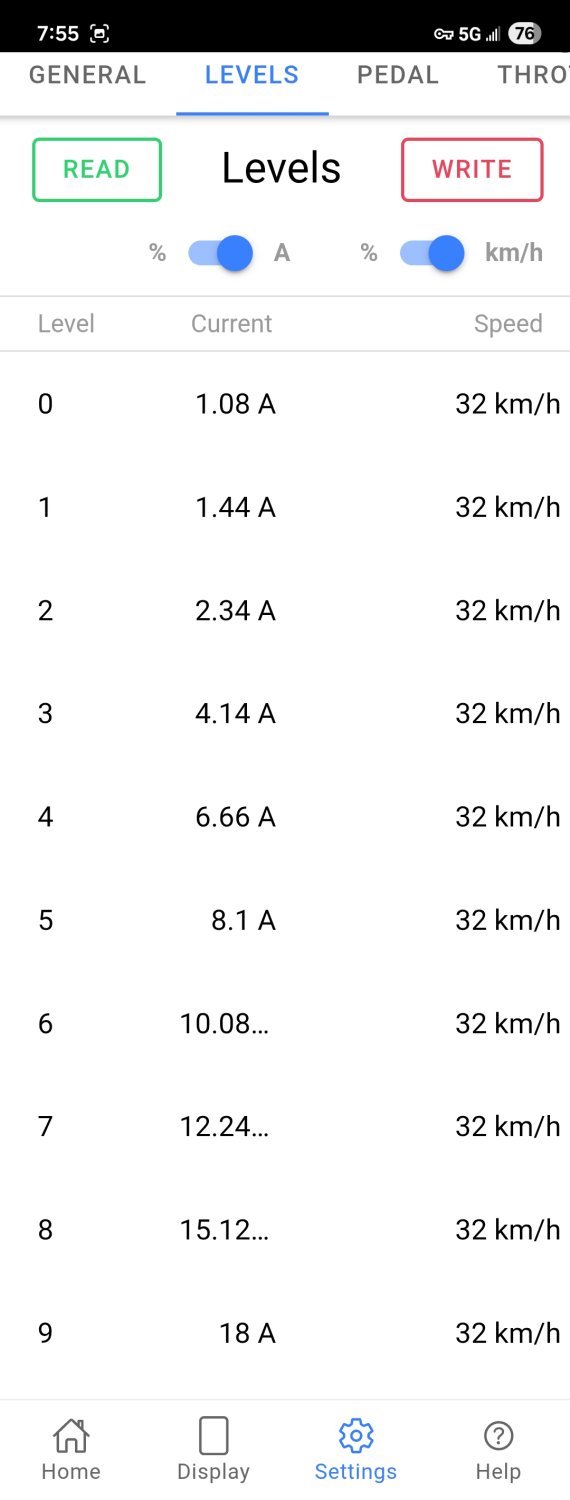

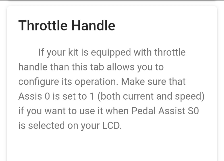

Lesson 1: Get in the habit of always tapping down to PAS 0 whenever you dismount the bike.
I decided to disable that on my BBS02B, so my throttle is always active.
My throttle for the hub drive works in PAS 0 as well, so I'm used to it.
I use it to "walk" my ebike into the 🏠
So my ebike will go 32 kph in PAS 0 if ~50 watts will make that happen. 😁
Honesty I see no reason to do that.
PAS 0 everything is OFF except walk mode.
All other PAS the throttle works and if I want throttle without pedaling.... I don't pedal
