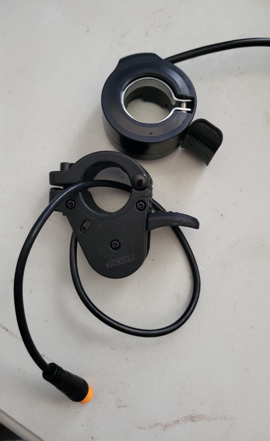

The bike I was referring to went to a 70 y.o. non-rider, unfamiliar with throttles. It raised its front hooves and bucked up as he was walking it, hence the thumb push in not down throttle. He can ghost pedal it for a few days until the PickUp tires arrive with the new throttle. The half-twist was too scary for him. It is temporarily disconnected.

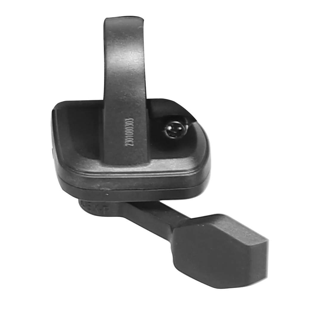

,.. hence the thumb push in not down throttle.
I don't know what you're talking about ???

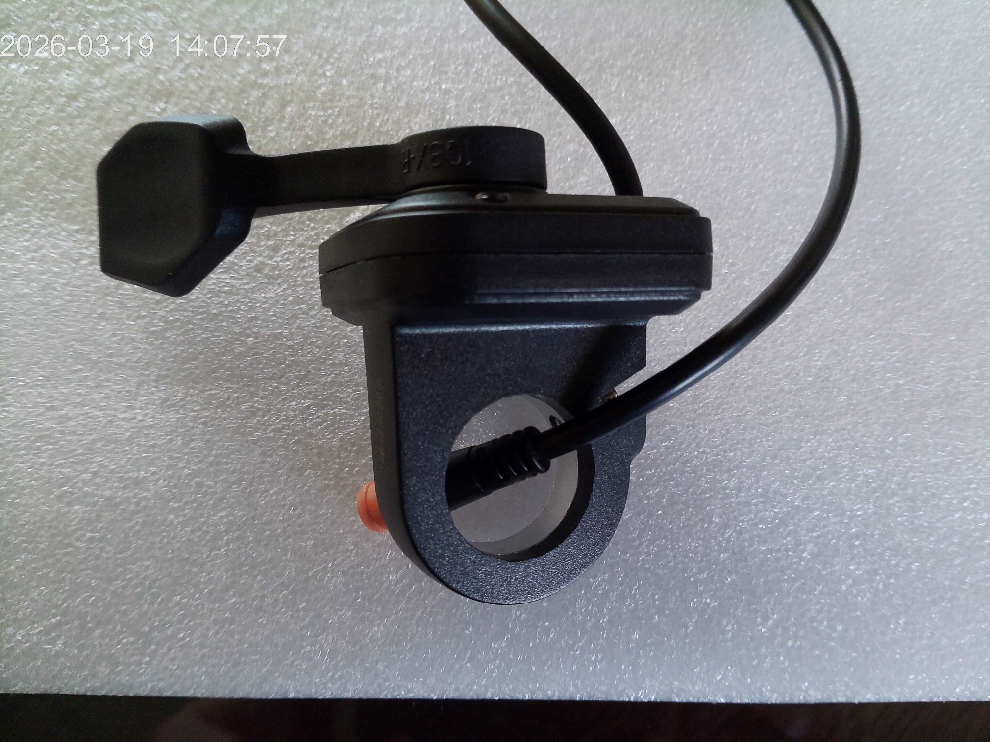

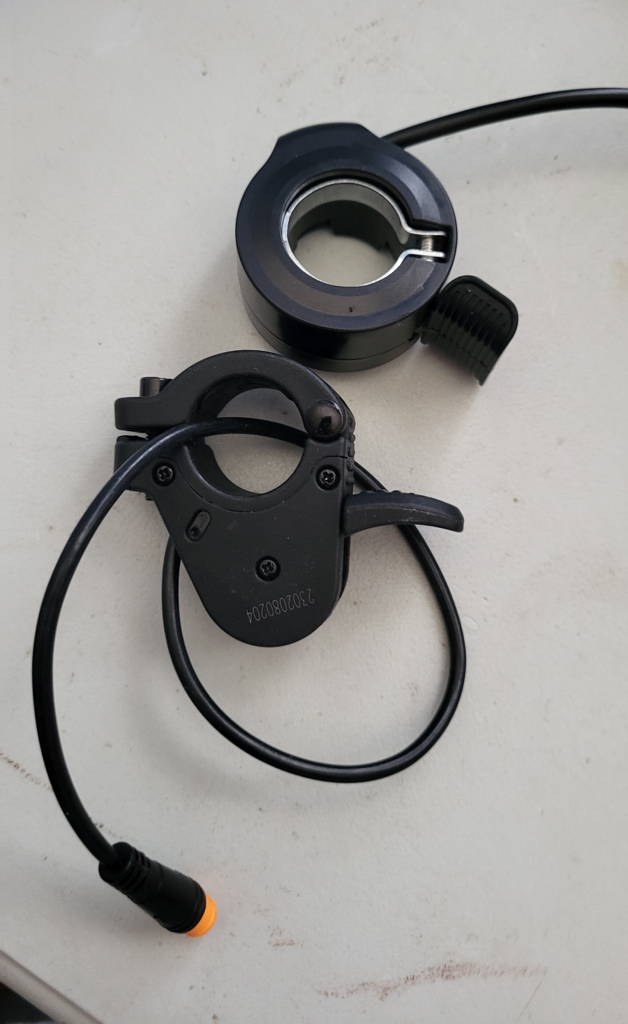

Does he have one of these throttles,..

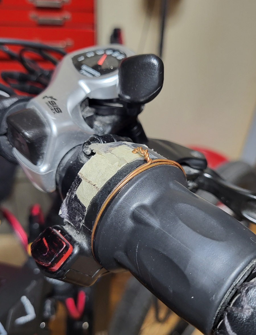

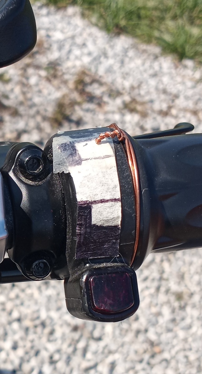

Or a throttle like my half-twist throttle with an on/off switch?
Or does he have something else??

I think I found it,..
It says 65° rotation angle.
Does it actually have a 65° active "sweep angle" from the start of power to maximum power?
My throttle is only has an active "sweep angle" between the two lines with huge "dead spots" before and after the active area of the sweep.
Almost half the sweep angle is dead leaving me with a pretty twitchy throttle response.
2mm of "pointer" movement has about a 5 kph speed difference.
The throttle doesn't end up being very granular at all.
