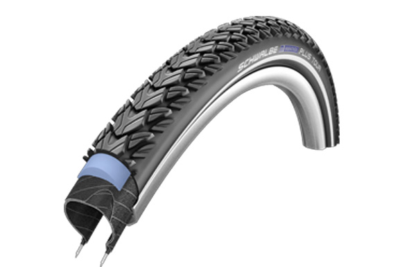

I just replaced the Big Ben Plus tires on my Homage Rohloff HS with Marathon Mondial HS 428 28x2. They are also available in 27.5x2. They are super durable, very good on roads, good off road, and very puncture resistant. Schwalbe north America is on the town next door. They consider this tire as their very best touring tire. _detail_MarathonPlusTour-Cut_0.jpg

I just replaced the Big Ben Plus tires on my Homage Rohloff HS with Marathon Mondial HS 428 28x2. They are also available in 27.5x2. They are super durable, very good on roads, good off road, and very puncture resistant. Schwalbe north America is on the town next door. They consider this tire as their very best touring tire. View attachment 27340

nice ! so now how much clearance do the fenders have? a lot more than the Moto x ?
Steve, The tires on the Homage are 2" 50mm Big Ben's with virtually the same tread as the Super Moto X which is a 2.4"a tire. The Homage has a 28" rim rather than the 27.5 found on the Charger. It is also a narrower rim than the MD40. The fender clearance seems to be about the same with the Mondials as it was with the Big Bens even though it has a deeper tread profile. It is not really a knobby, off road/trail type tire but rather more of an all purpose, super durable one. Definitely quieter than a knobby but slightly noisier than the Motos. Not really noticeable until you go down hill and get close to 30mph.
