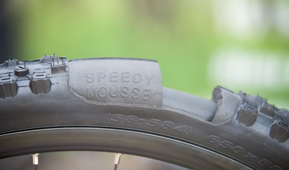

After all I have not fitted my tires tubeless, on AlexRims MD40, but I inserted the inner tube in a product called speedymousse
I wrote something about it here:
https://electricbikereview.com/forums/threads/rock-razor-vs-moto-x-tires.25694/post-173798

Hi Steve i have done only 120 km with Racing Ray/Ralph and Speedymousse on our MD40s.
I can certainly say that I have not yet get any flat :) hehehe and that I can still drive my bike with pleasure, as before.
I have not yet fully understood all the differences, but what I can say is that passing over some obstacle (root, stone, sidewalks) is totally different now. The tire absorbs the bump in a totally different way, as if it were full of sand it does not bounce but it take the hit without returning it. On offroad routes I found the bike much more manageable. I think it is the effect of both, the rubber compound of these new tires and especially the presence of the speedy mousse. Virtually the opposite of the Super Moto X that I mounted before they bounced a lot, which is convenient on city routes but dangerous on off road's ones.
