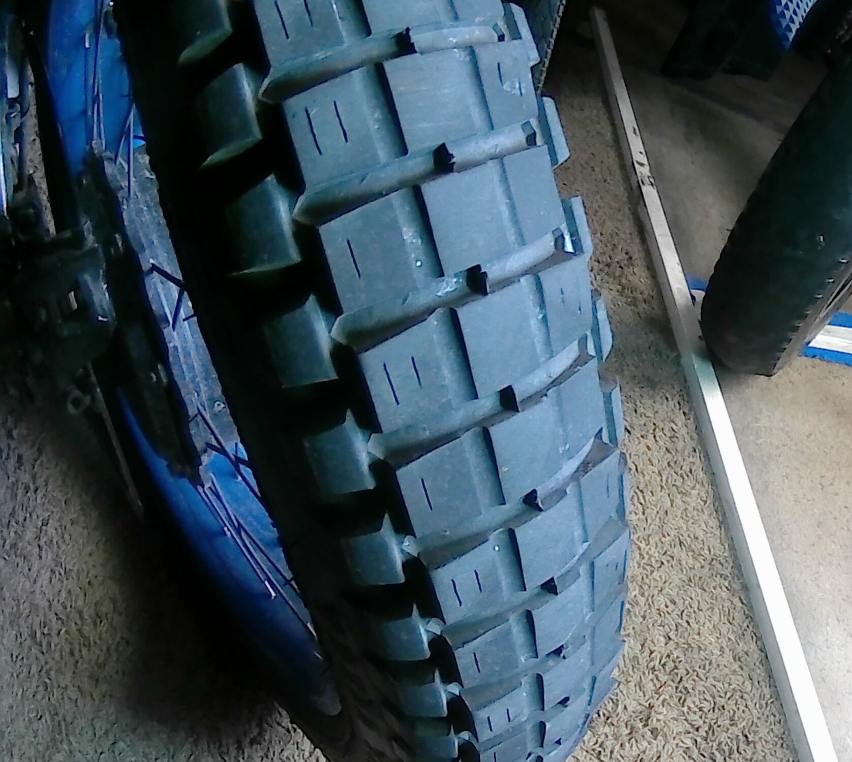

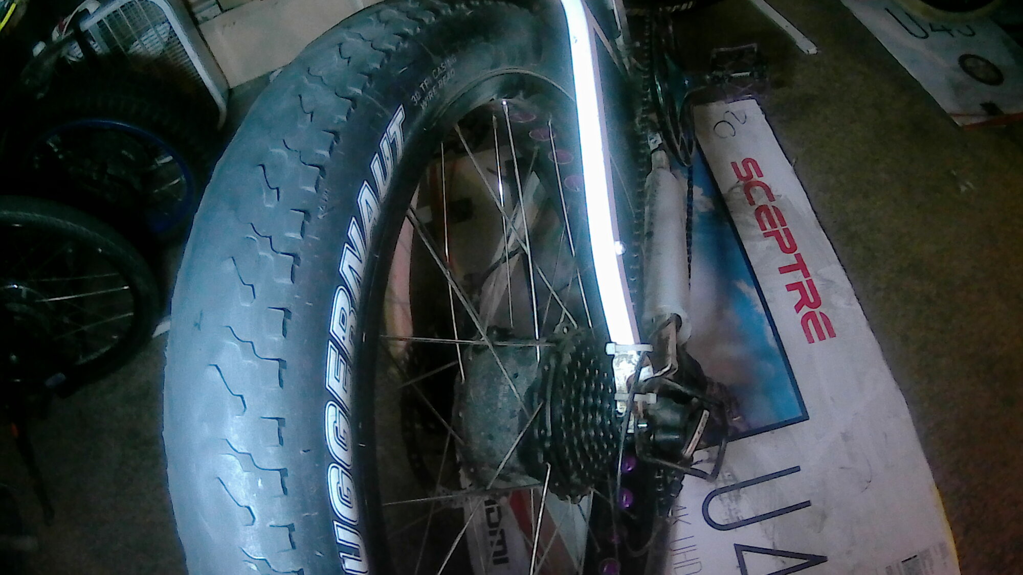

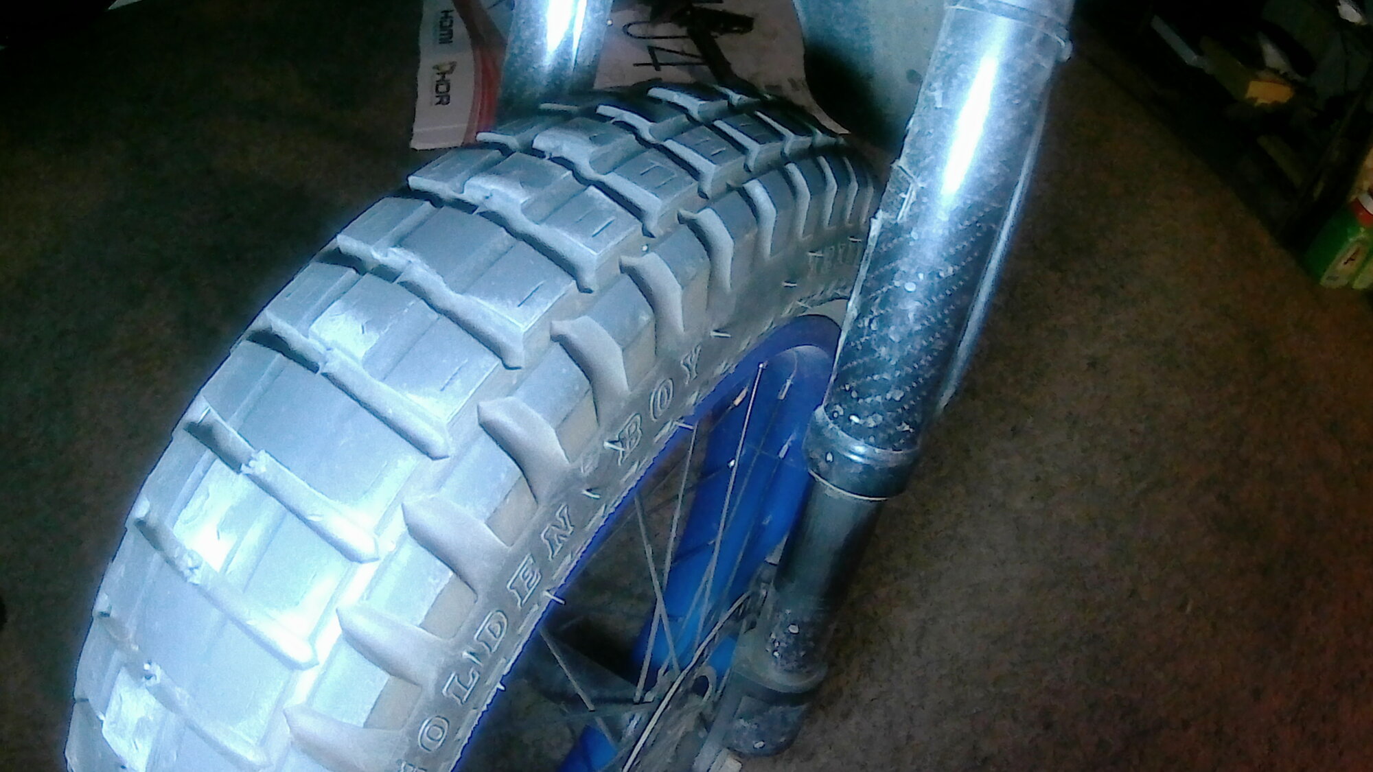

The proof is in the 3 photo's below.
The 2 photo's showing a blue rim are the SHINKO 241 motorcycle tires at mile #8,726 of wear. (1 is the rear tire.. 1 is the front tire.)
The other photo (showing the white bike frame) is another of my ebikes with a Kenda Juggernaut 26"x4" bicycle tire. It (the tire) currently has 3,000 miles of use. I will continue to ride on it until bare threads/holes show through all the way around (another 1,000+ miles). Why? Just because I can. By the way, the white-frame ebike has 15,600 total miles. It has never had a flat.
The blue rim ebike is my 2021 ArielRider X52. It now has 16,383 total miles.

Hi dwoodul51.
