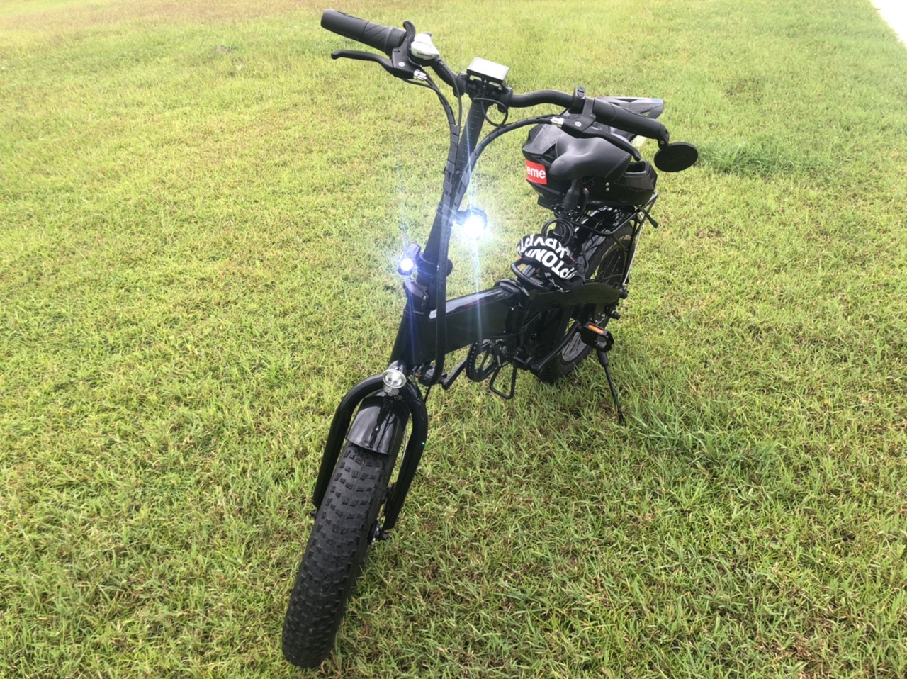

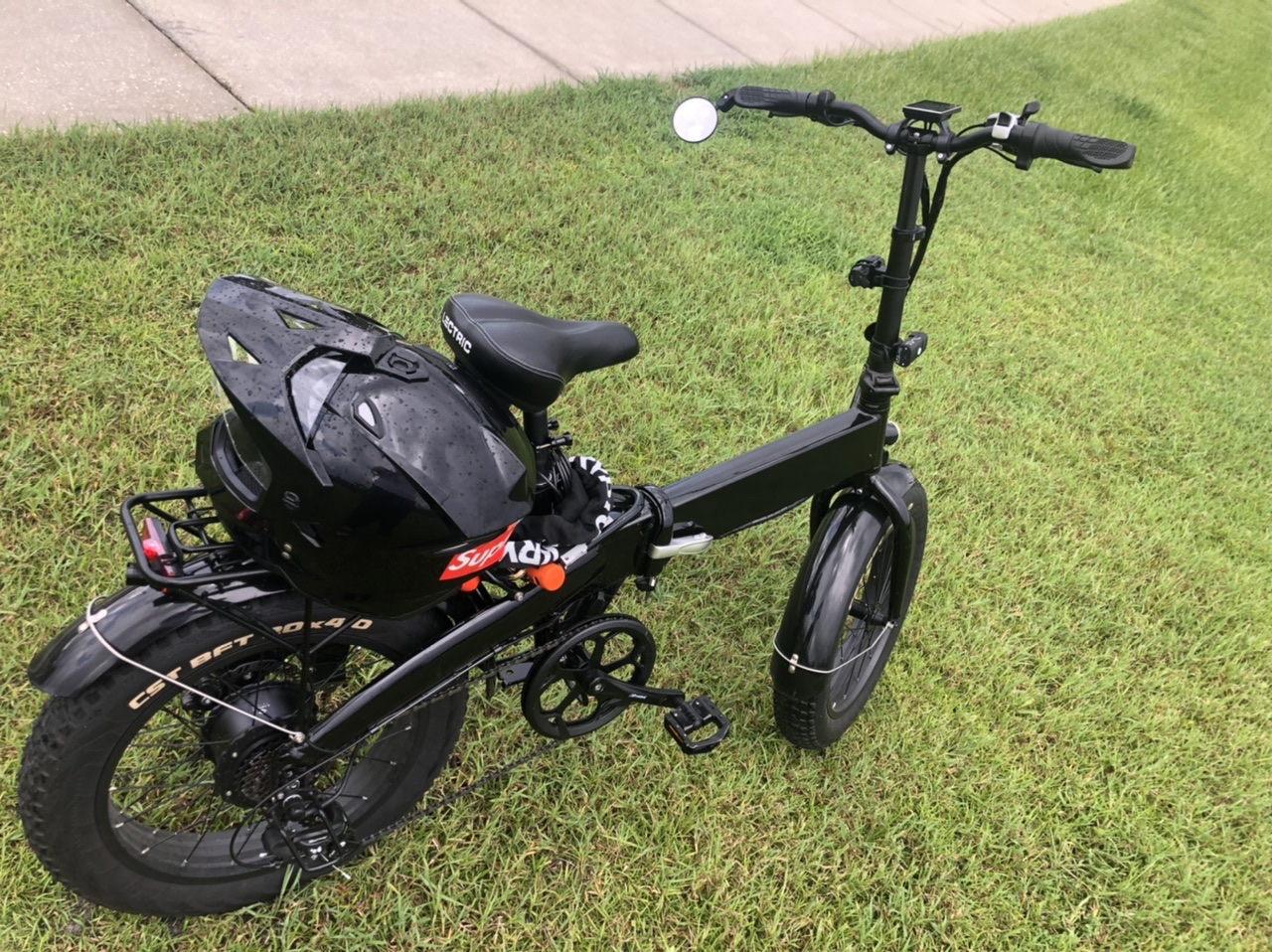

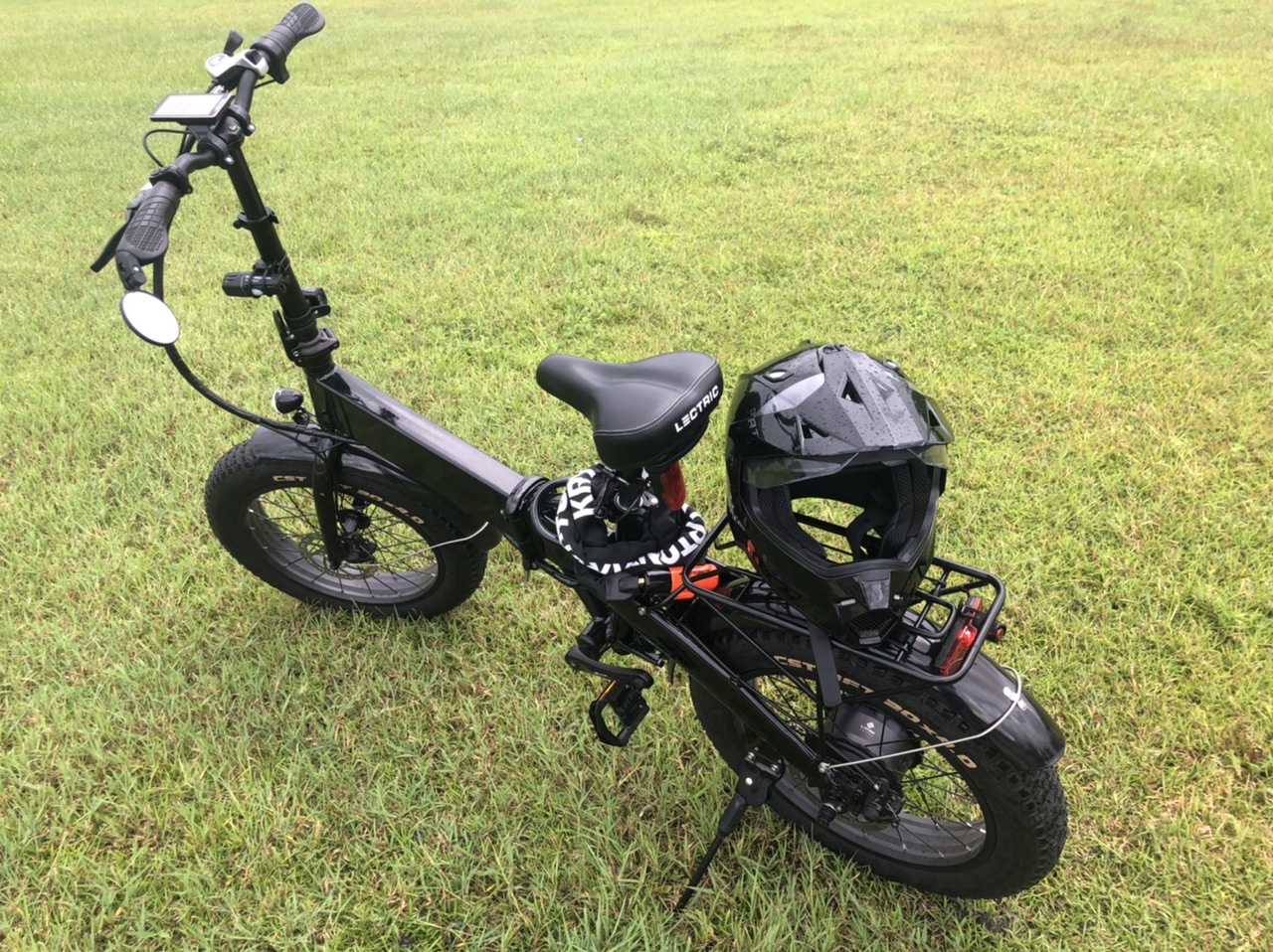

I added a 5-inch handlebar rise, a zoom seat post and cloud 9 seat, an 11-34T freewheel, and a 48v 20ah battery. I would like to change out the controller to a 30 amp. I also added bigger wider pedals with grips. I also have a usb charge port coming for the bike. I did see a nice video on adding a suspension fork to the bike thinking about it.

Logo cover up. Wanted yellow reflective tape but did not find anything suitable locally. The white reflective tape I found at Walmart for less than 4 bucks. 2"x 30" Duck Brand in the Auto Section. Cut in half and trimmed to a point to match the existing stripes.
