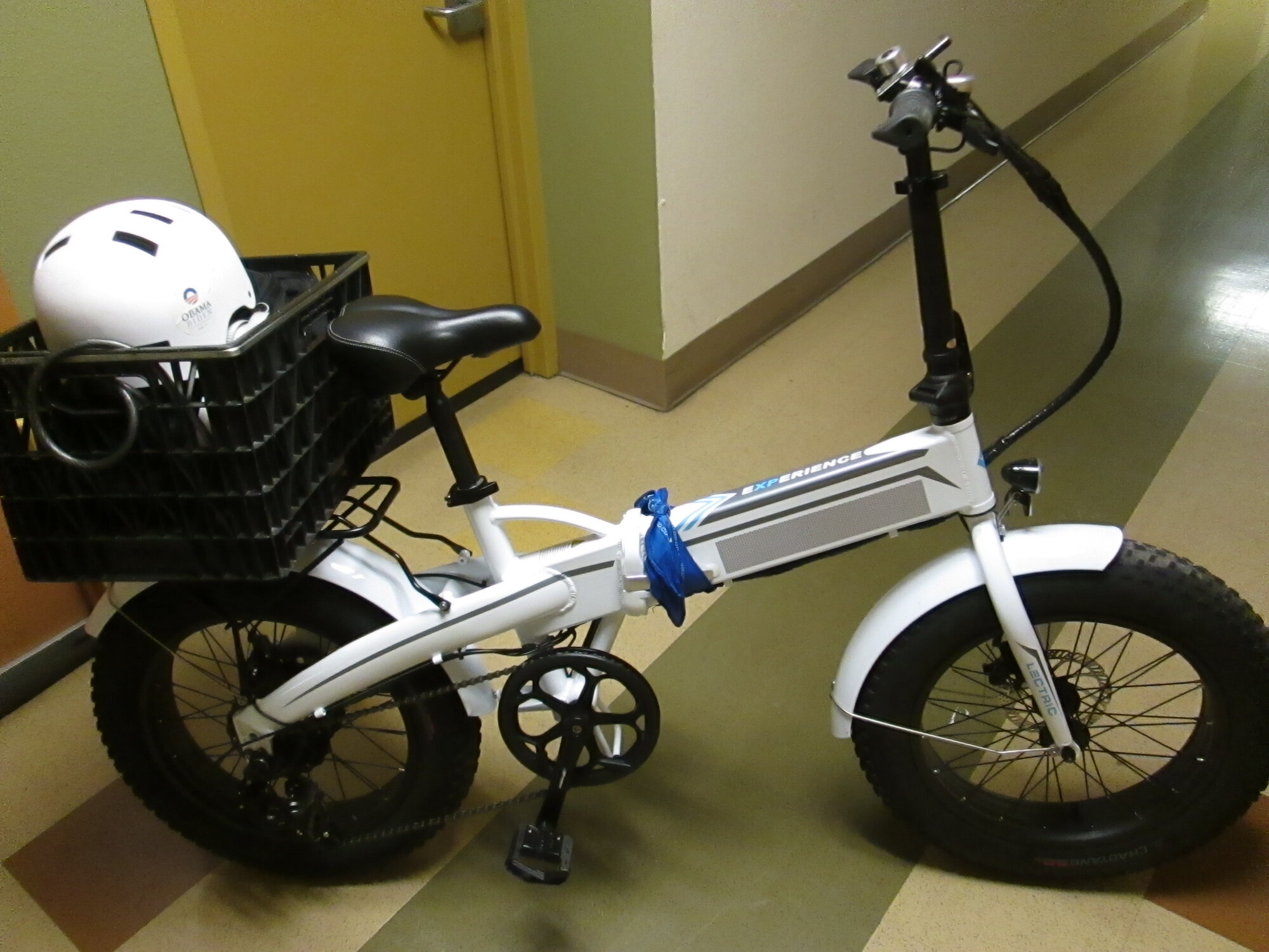

Someone asked me about my custom bracket that I used to attach my milk crate with quick releases. It is a custom made metal bracket that I welded together. It has a lip which catches the bottom flange of the milk crate on one side and I welded the little hook flanges for the toggle clamps on the other side. The whole thing is very strong, I can literally pick up the whole bike by the attached milk crate and it doesn't budge even a little bit. Here is the link for the toggle clamps and hook flanges that I brought from amazon. https://www.amazon.com/gp/product/B07DQ93FYT/ref=ppx_yo_dt_b_asin_title_o08_s00?ie=UTF8&psc=1

I plan on making a custom decorative lockable wood box to keep on the bike all the time when I don't use the milk crate. The pannier bags are falling apart, may make my own bags...I am still undecided about that because I am not too good with a sewing machine but it seems like a fun project.
