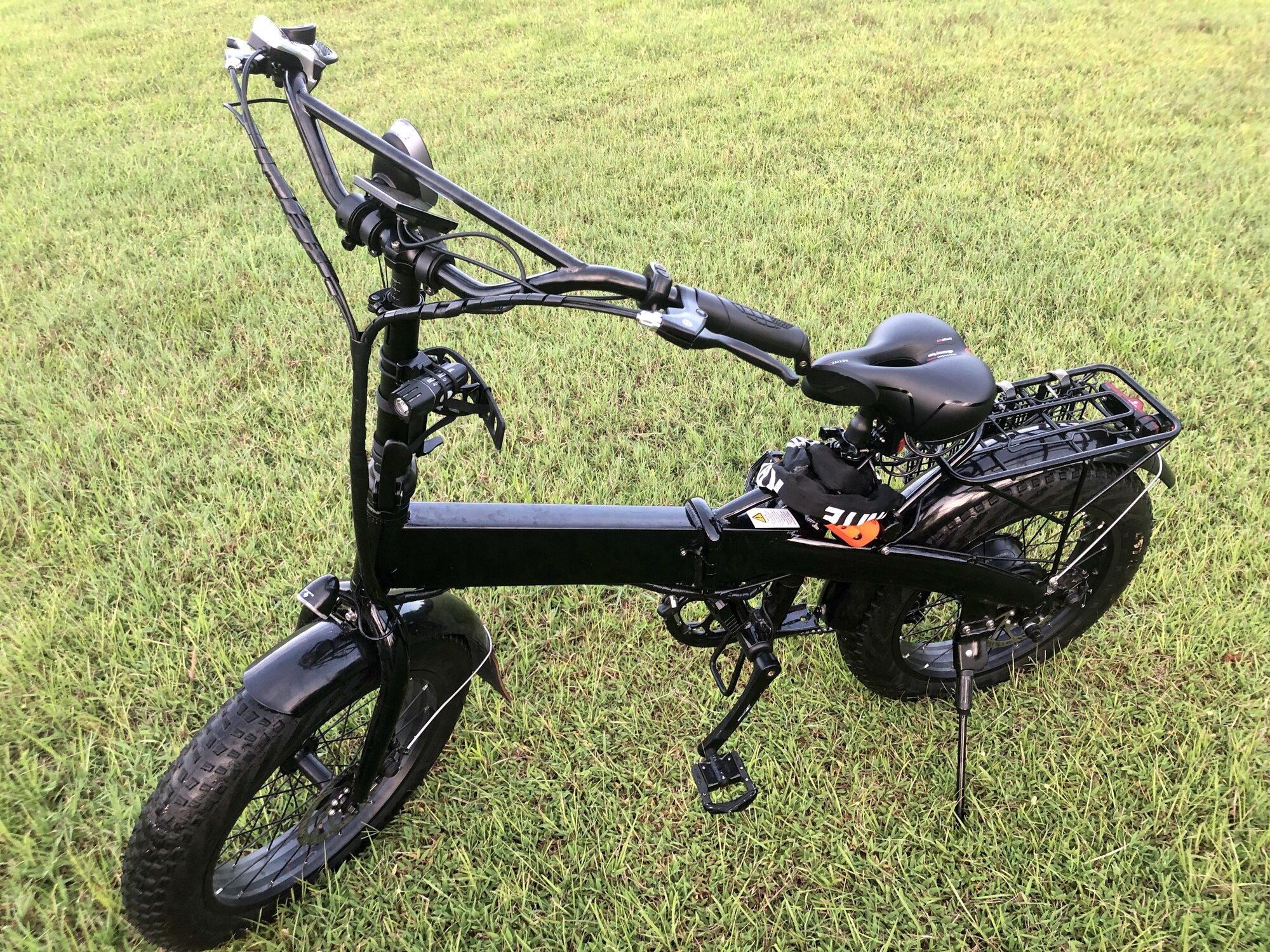

New Klunker handlebars oh god is the ride so much more comfy now that I can straighten out my back more.
The install was relatively easy just taking off all the stuff on the handlebars with an allen wrench and for the shifter a philips head. The only thing that gave a bit of trouble was putting the screen back on as it was a tight fit for the screws, although I am sure if you had longer screws it would be much easier.
The handlebar is taken off pretty easily with a few allen screws.

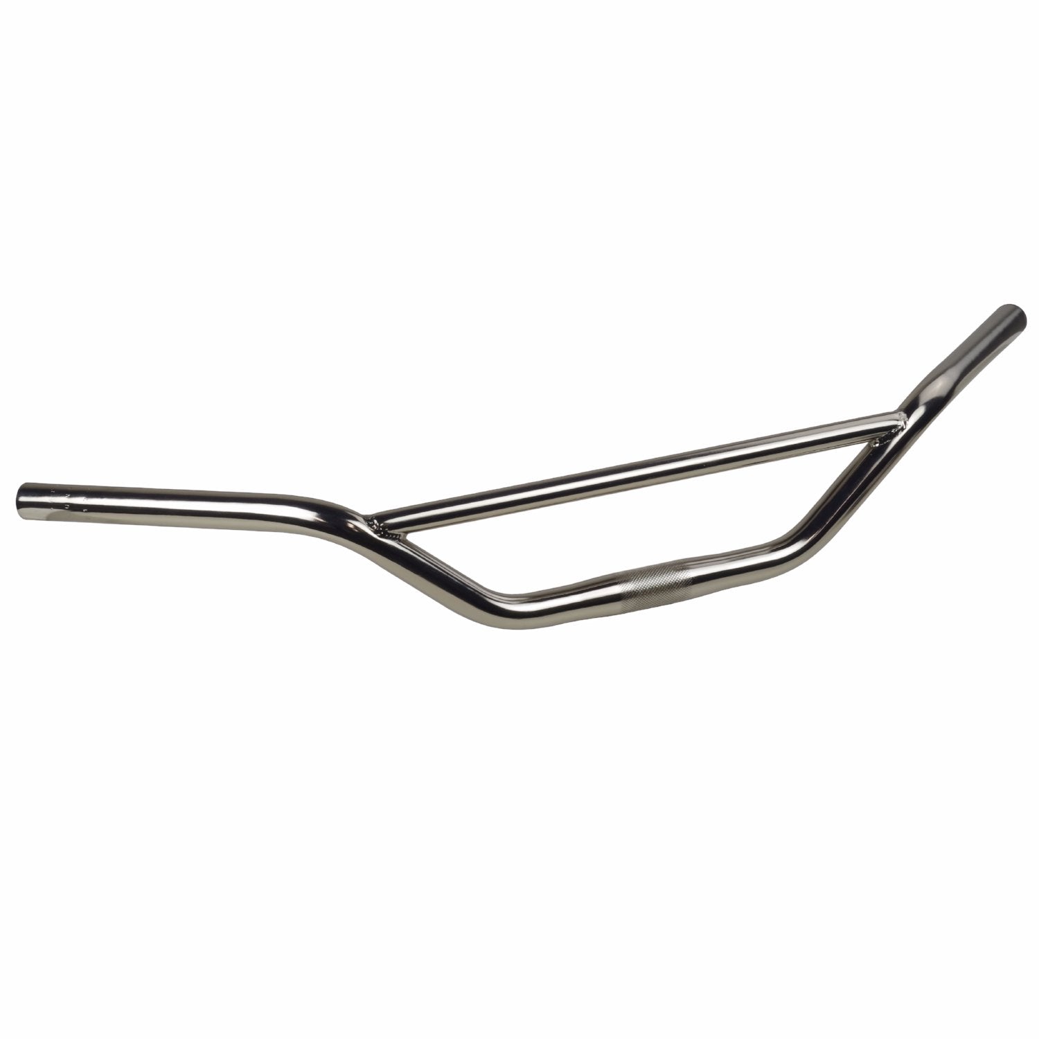

any inexpensive handlebar options out there? the sunlite that people seem to love isn't available anymore at amazon. the klunker is too much $ for me. anything else?
also: cheap footpedals?
Here are some handlebars that are longer and have a better rise (height) and sweep. You can choose between lower and higher. Personally my bars have about a 4 inch rise...these bars are not a bad deal for 25 bucks.
thanks much. re those bars you linked to -- which are the ones with a 4" rise more or less? would that be the 100mm ones at $30?
