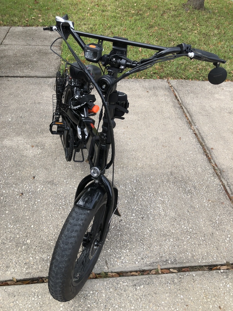

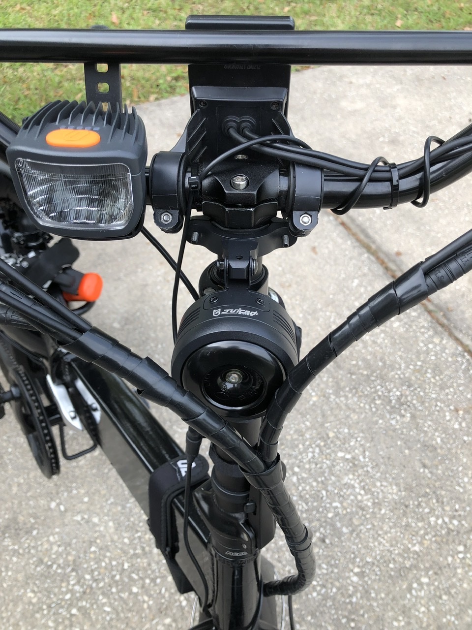

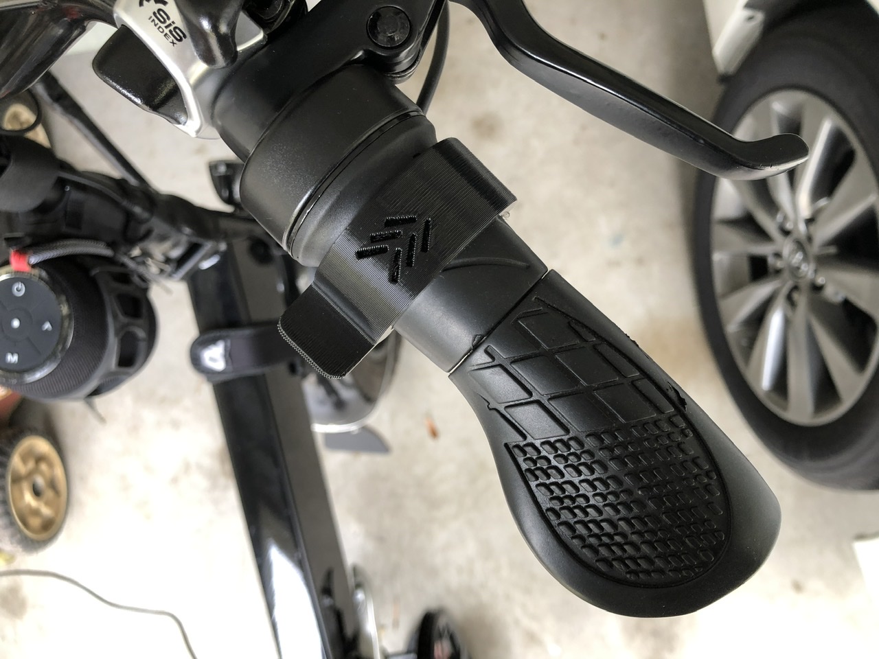

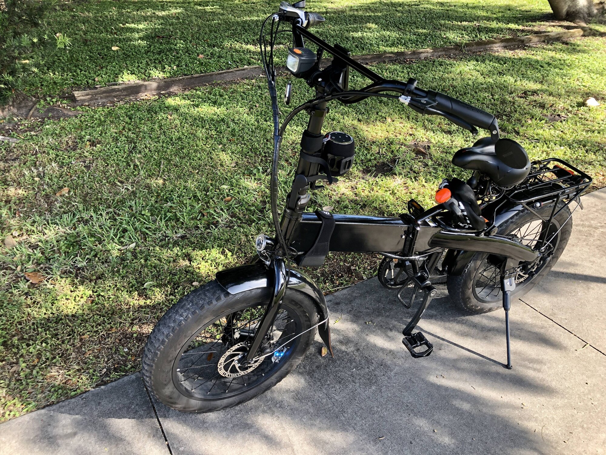

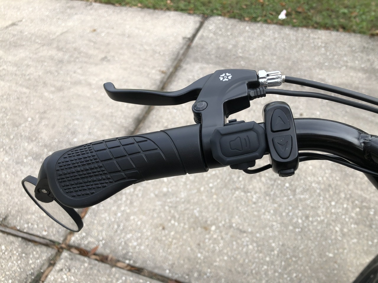

XP Step Thru...mods: class 3 hack, fender, rear rack, decal delete, DNP 11-28t, teflon cables, Avid black barrel adjusters, Vee Spdstr white walls, Rad headlight, Juiced horn, Boomerang alarm (temp location), bracket for rear light an open source 3d print from Thingaverse.
great job. Did your Juiced horn have the alarm feature too?
Yes...loud AF. The Boomerang also has a decent alarm while texting me that someone is meddling with the bike. Just need to figure a more permanent mounting spot. Might drill and pull a pair of M5 rivnuts, just trying to see where that would work best - out of the way, and without looking too weird. Also worth noting, the OEM harness for the Rad Rover light is about 2-3 inches shorter than ideal. When you turn right, the higo 2 pin can pop out. There are 12-15" harness extenders out there for $10-15, but we don't need that much spare cable...thinking about it though...maybe we can hide surplus in the control box.
UPDATE: @P_smilez advised me that there is ample headlight cable packed inside the control box. You do have to tug quite firmly to pull the cable you'll need, but it is there. We now have exactly what we needed with steering slack. No need to order a harness extension. Hope this helps others.
Another minimalist aesthetic design fan :)....she looks clean!
Thanks @ki11a! I tried zipping through the motorhome decals with a 3M stripe-off wheel disk but discovered it's a much bigger job because they are buried under a clear coat. The heat of the friction was just yellowing the paint. I eventually masked it up and repainted. It isn't perfect, but finally decal free, save for the headset logo. Worth it. The Juiced horn is indispensable, have them on all our bikes now to supplement the pedestrian bell.

I would HIGHLY recommend the Juiced Bikes Horn/Alarm. Extremely loud, alarm works perfectly every time and just sensitive enough to only go off when the bike moves, and not with the wind.
Got a new horn/alarm, the Juiced Horn, which is an actual motorcycle horn and is loud enough for the streets. Pretty awesome.
Oh and got a thumb throttle attachment for more riding comfort.
Oops I just replied to the the other junk alarm posted. +1 for the juiced! It’s awesome. Side note, I didn’t charge it before storage, didn’t charge it for 3 months while in storage, and have been riding for a week and using it constantly and it’s just as great as day 1. Good quality.
Juiced horn/alarm for alarm does it have a automatic warning mode like when someone moves the bike it beeps and if they move it again it goes off?
Yes, @Dex the Juiced horn/alarm has a bump-sensing accelerometer that will blast up to 2000 times on full charge at 118dBA or until the meddling stops. It's loud. I had a $12 Amazon alarm zipped under the seat, which did something similar, also very loud, but it was less robust and experienced a rapid unscheduled disassembly after hopping a curb, and it was never a vehicle horn as well. Not sure I will bother with it anymore. The Juiced horn with a proper lock is a good lock-up deterrent, short of bringing the bike inside. Standby time, so far, is vastly superior to our Boomerang alarms, which are also doing other things.
