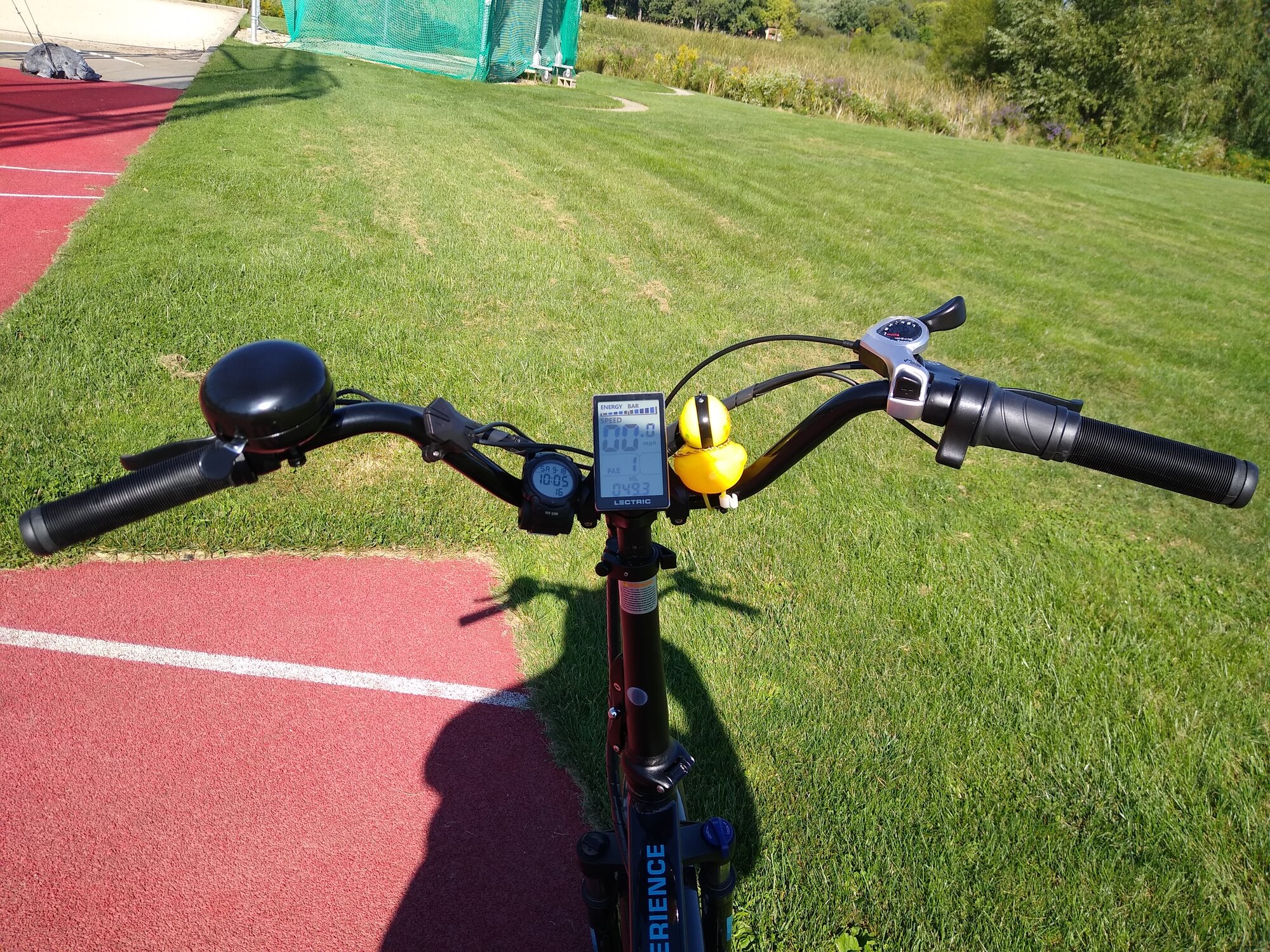

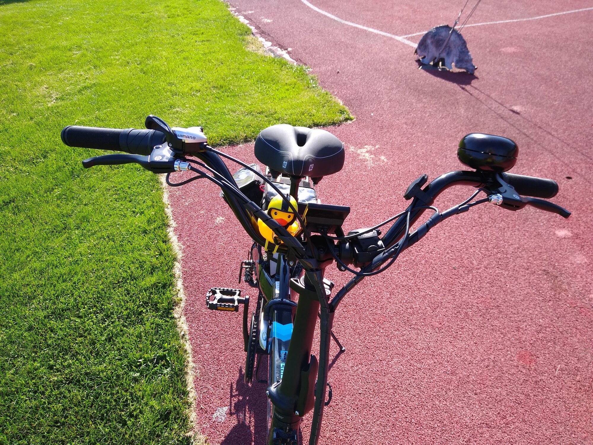

Thanks to all of the fine suggestions I found here and on YouTube, I now have my Lectric XP in comfortable shape for travel.
-Changed the handlebar to one that has the handgrips angled back about 35 degrees (Andros Bar, TRN-0006)
-Changed the handgrips to a softer feel (Marque MHG-02)
-Added a bell for gentle warning to others (Leichten, B08D79V1GD)
-Added a rearview mirror on the left end (Hafny MR083)
-Added toe clips to the pedals (Zefal, Christophe), but in order to do this I had to switch to a non-folding pedal. I like knowing exactly where to place my feet on the pedals for best effort.
-I had received the larger seat and shock absorbing seatpost with my order (Happy Thanksgiving 2020!) I also got the panniers, but I did NOT like the straps for connecting them.
-When I got my rear bag (Ywduoying, B08NFC2HSF), I found the attached panniers too small to be useful. So, I cut the strap attachments off the Lectric pannier bag, laid it on the rear rack and cut some judicious holes through which the rear bag straps would pass & attach the combination to the rear rack.
-I bought the CAOMM 48V 20AH extra battery and electrical parts to wire it up in parallel. The battery fits nicely in the bottom of the rear bag, and doesn't seem to heat up as I am running both batteries at the same time. Now for some long trips!

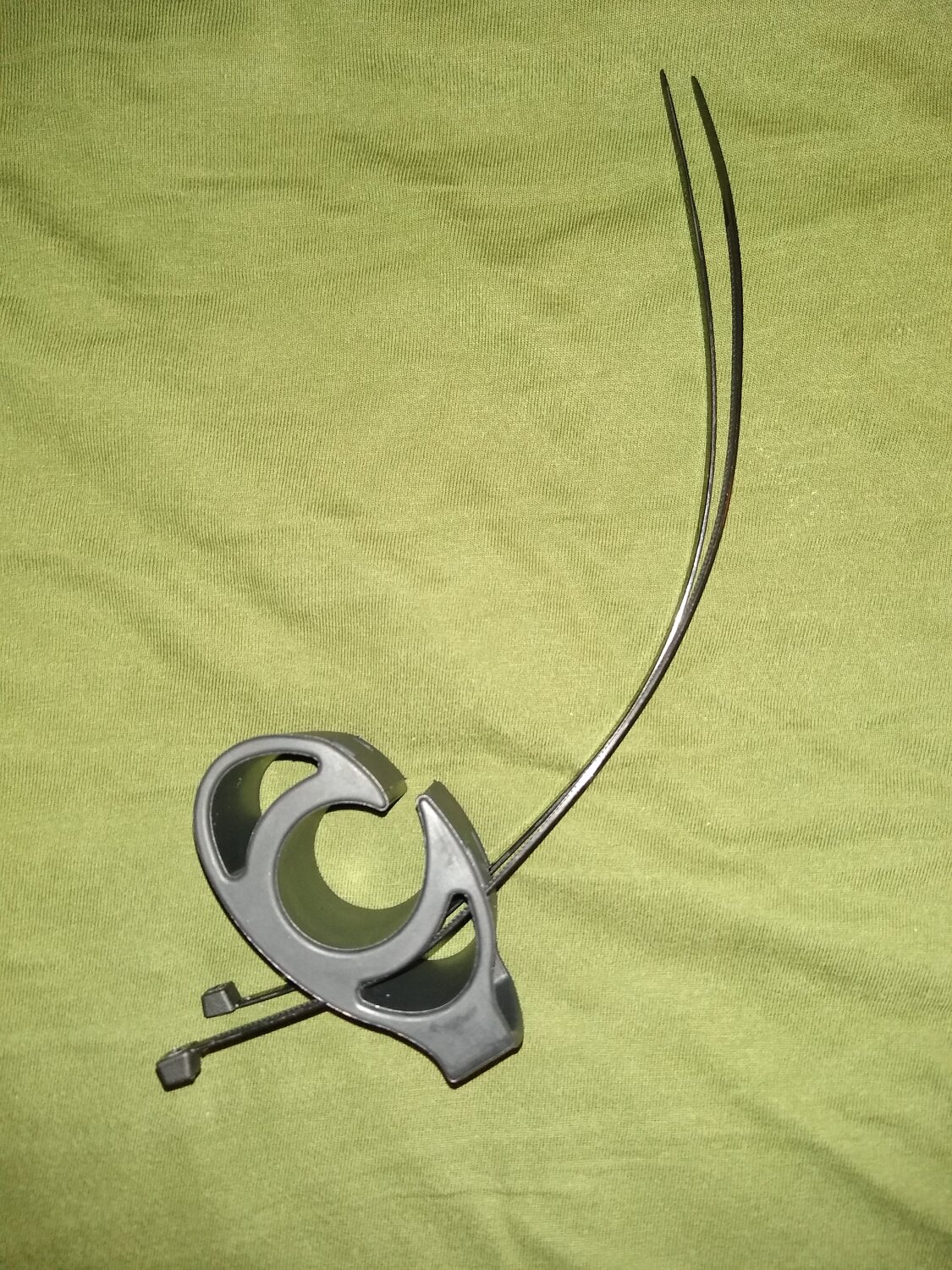

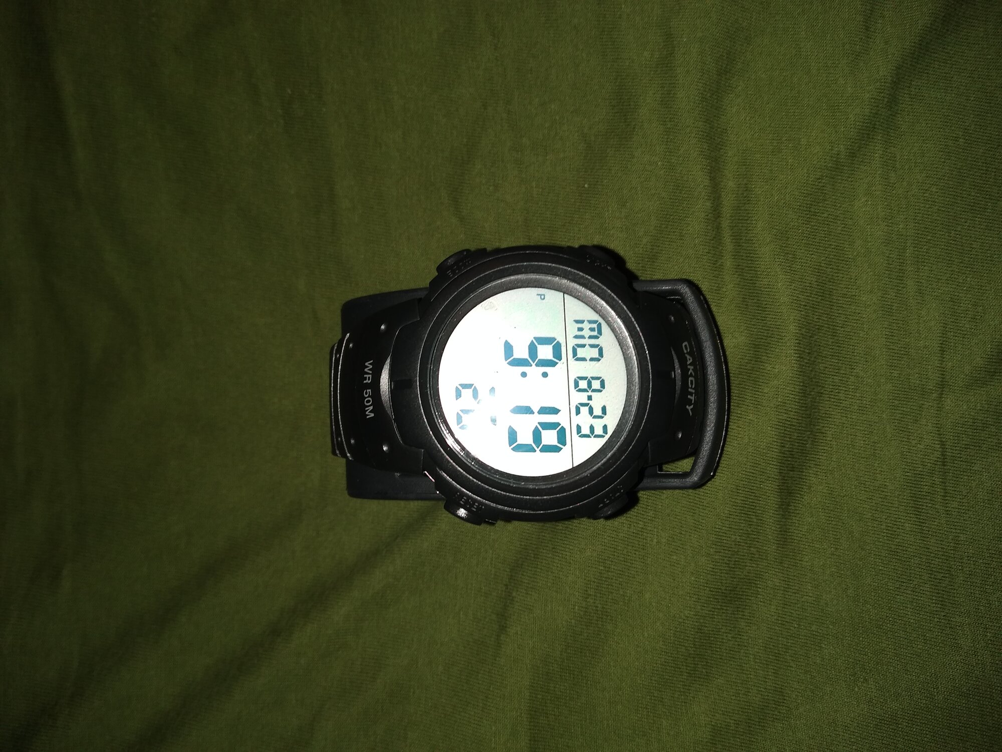

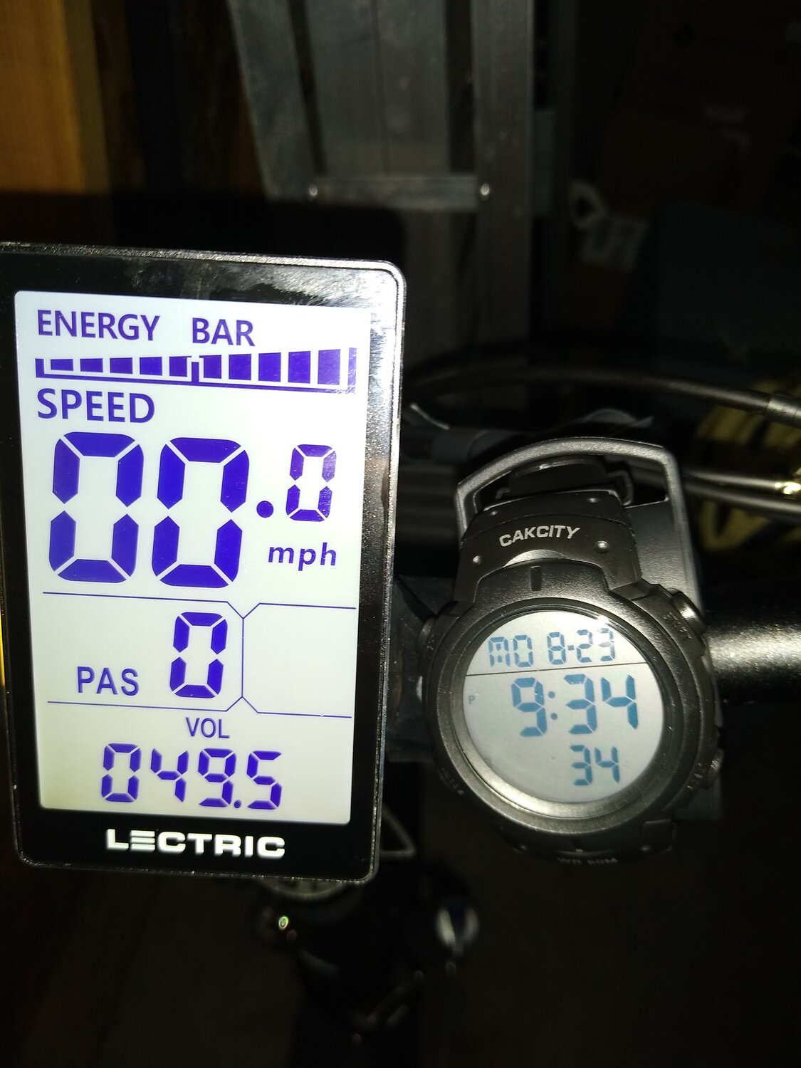

Wristwatch for your XP plus a "fake wrist" to mount it with.
I wanted a clock for my XP, ordered one designed to mount on a bike, wasn't really impressed with it in real life. Really wanted to put a cheap Casio F91W but they're backordered and I didn't want to wait.
Besides, how would you mount a wristwatch on a bike?
With a rubber fake wrist that goes on the handlebars. Held in place with cable ties, but putting the watch on nice and snug really clamps it down.
Got a cheap water-resistant watch with big digits for us old coots. It also has a cool backlight mode. It'll live on the bike.
The fake wrist is also a handy place to store your watch while riding. And it's easy to swap on a different watch for whenever Lectric sells a branded one.
Works great. Just wish there was a smidge more room on the handlebars so it could sit completely straight and level.

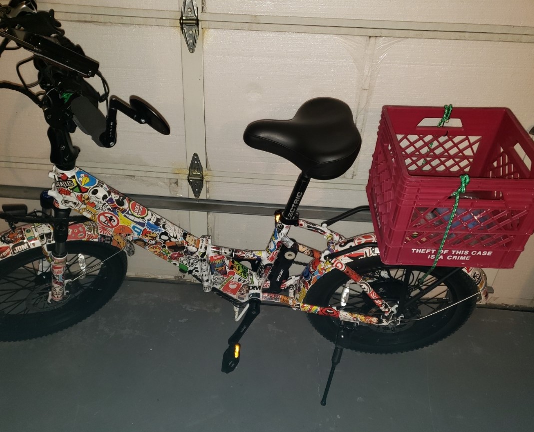

Also here is my bike so far.
Wow, that wrap is really cool! Did you make it with individual stickers?

Thanks! Yeah, it is individual stickers I got off amazon. it was fun putting the stickers on. https://www.amazon.com/gp/product/B07ZDJB8ZT/ref=ppx_yo_dt_b_asin_image_o00_s00?ie=UTF8&psc=1 I did have to glue some down that didnt stick after a few rides and I sprayed clear coat on them as well.
