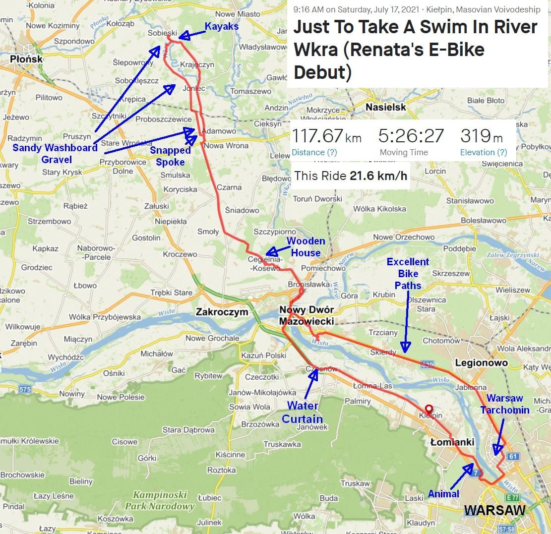

It was such a gorgeous day. I was able to transport my two e-bikes to my first cousins' place. Then I let Renata (the wife of my "brother" Jacek) ride my one-month old Vado SL, and I was riding my heavy Vado 5.0. Renata was a good and strong cyclist. Somewhere on the trip, I also heard the "ping". It happened on sandy "washboard" gravel road. What choice did I have? Just to continue the ride! I was so lucky as the rear wheel withstood the stressed. Of course, I had to bring the wheel to an LBS for repair on the first working day.
So good spokes do not snap every day!
