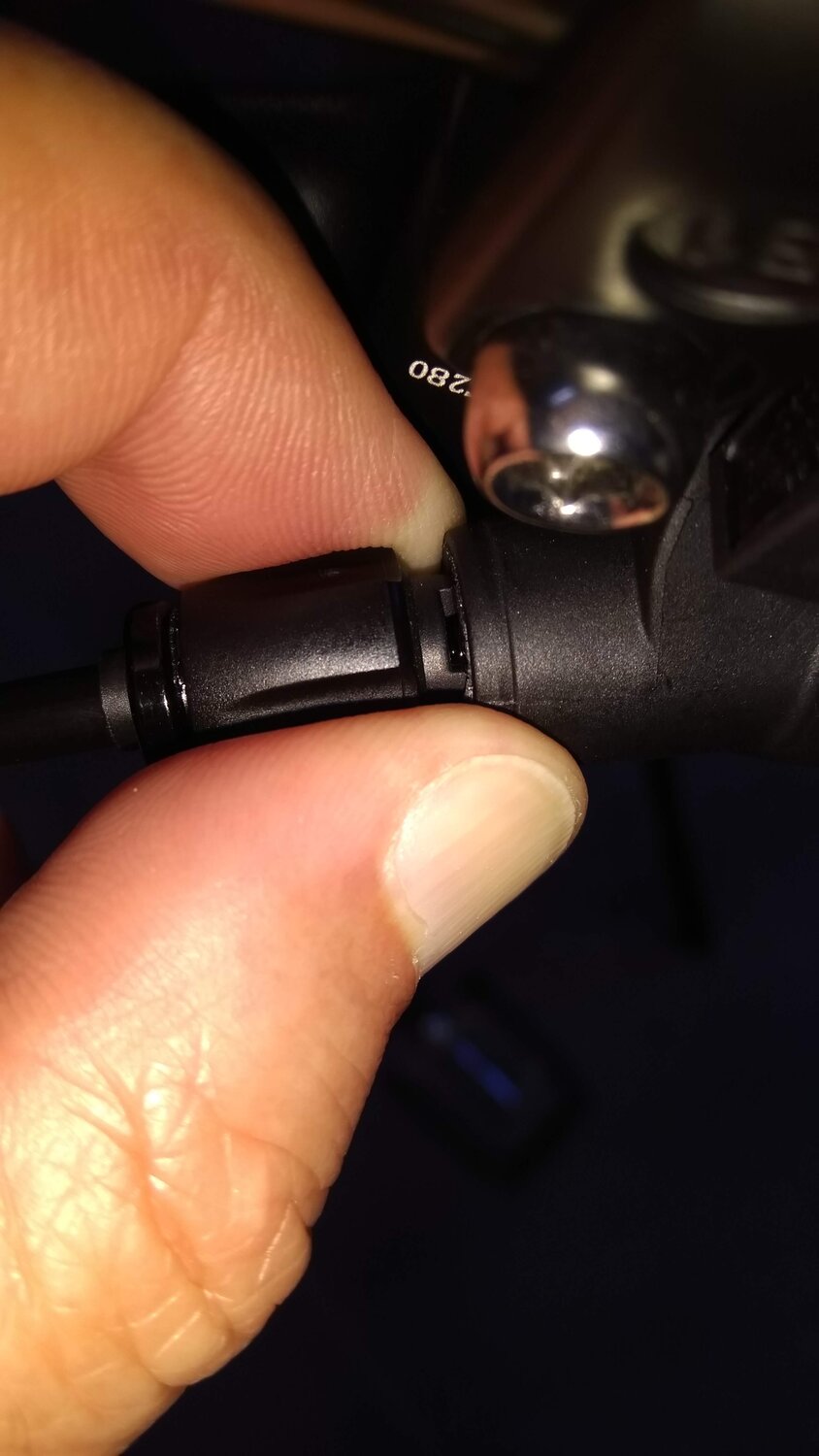

Hi guys,
I have purchased a brand new Arroyo C8 Elite, which has a Nexus 8.
I need to turn the barrel adjuster to slightly align the gears, however I have problems to pull forward the plastic sleeve, therefore I cannot rotate it.
Please see the picture below, I cannot rotate it in neither side, likely because I cannot pull it out more that what you see :(
Any hint on how to loosen the barrel adjuster more? I cannot understand why it is so difficult.
Thank you!

Shift to eight gear, then see if you can get some movement. And then go back to 4 for the fine tuning. Report back weather or not that works, I have other ideas.
Hi,
Thank you for your reply.
I just tried but the barrel adjuster simply does not rotate because, IMO, it does not pull out enough.
I do not want to force it because I do not want to risk damaging it. Weird.
Alex
It is a $5 part and needs to function. Most likely it is overly tightened. Maybe put something like a needle nose vice grip on it. If it breaks, then just replace it.
