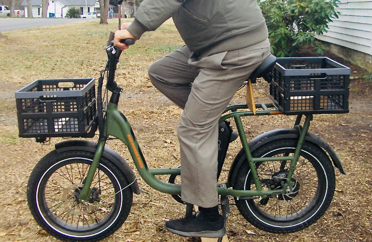

My Radrunner was terrible on bumps. At 30 PSI, those wide tires were stiffer than other tires at 60 PSI. A suspension post and seat with springs made little difference. A worse problem was that the handlebars were at belt height and not far ahead of my belt. That made my upper body unstable and thus the steering dangerously unstable.
It was much better after I moved the seat back to get it away from the bars. Comfort on bumps was an unexpected benefit. Instead of sitting erect, I was leaning forward, a bit like standing with my butt against a wall for stability. My legs were absorbing most of the bump energy, and they did it better than my spine.
Wrist shocks were still so bad that apparently I tore a tendon. It felt as if I had a broken bone in my wrist. It finally dawned on my that I could use a riser to raise the bars a few inches. Raising the bars meant less weight on my hands, and my arms were freer to swing on bumps instead of transmitting shock lengthways.
I also bought different bars to change the angle of my wrists. It still had stiff tires and no suspension but was now comfortable on bumps. My legs could lift my butt, and my wrists could "float."
The photo shows my position with the seat back 7 extra inches on a layback post, braced with a plywood triangle. Leaning forward to put weight on the pedals took the weight off the seat, and that meant comfort. However, these bars were too low, not letting my arms swing up to float over bumps.

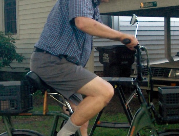

Here's what a riser did for me on my Radrunner. I'd say the bars were now 10" above seat level, which was typical of how riders adjusted classic 3-speed commuting bikes (although those bars had a better wrist angle).
My forearm was almost level, so a little elbow flexing would let my hands float with the bars. By suddenly retarding forward motion, a bump also causes the rider to lurch forward relative to the bars. In this position, flexing of elbows and shoulders would absorb that, too.
