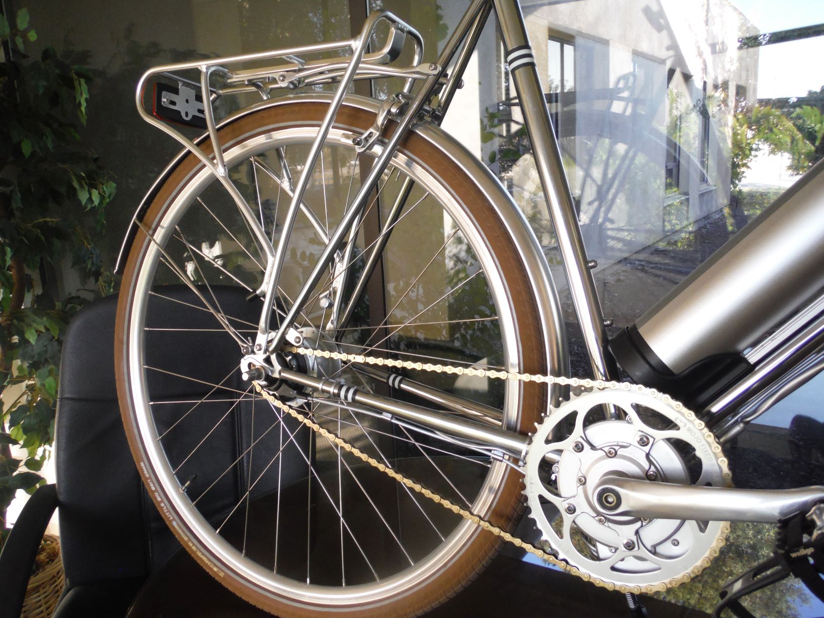

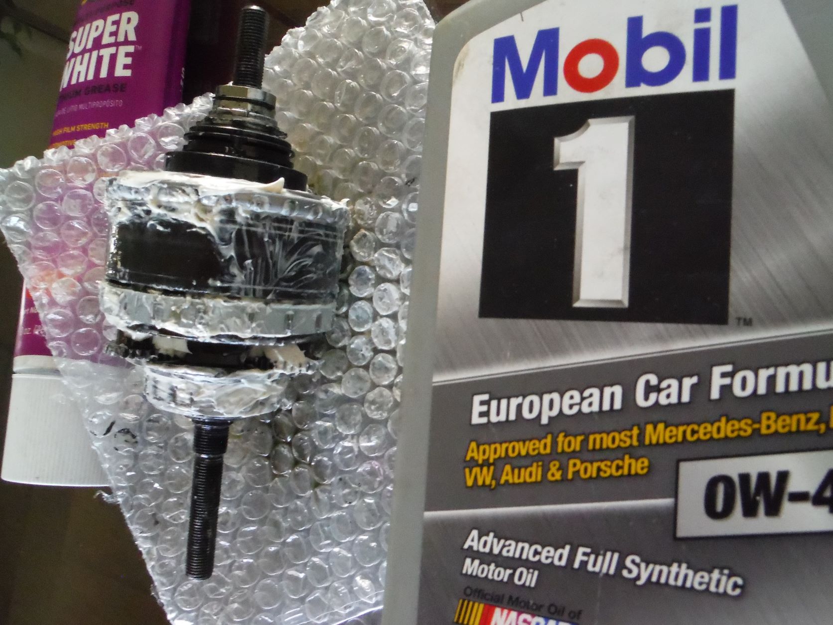

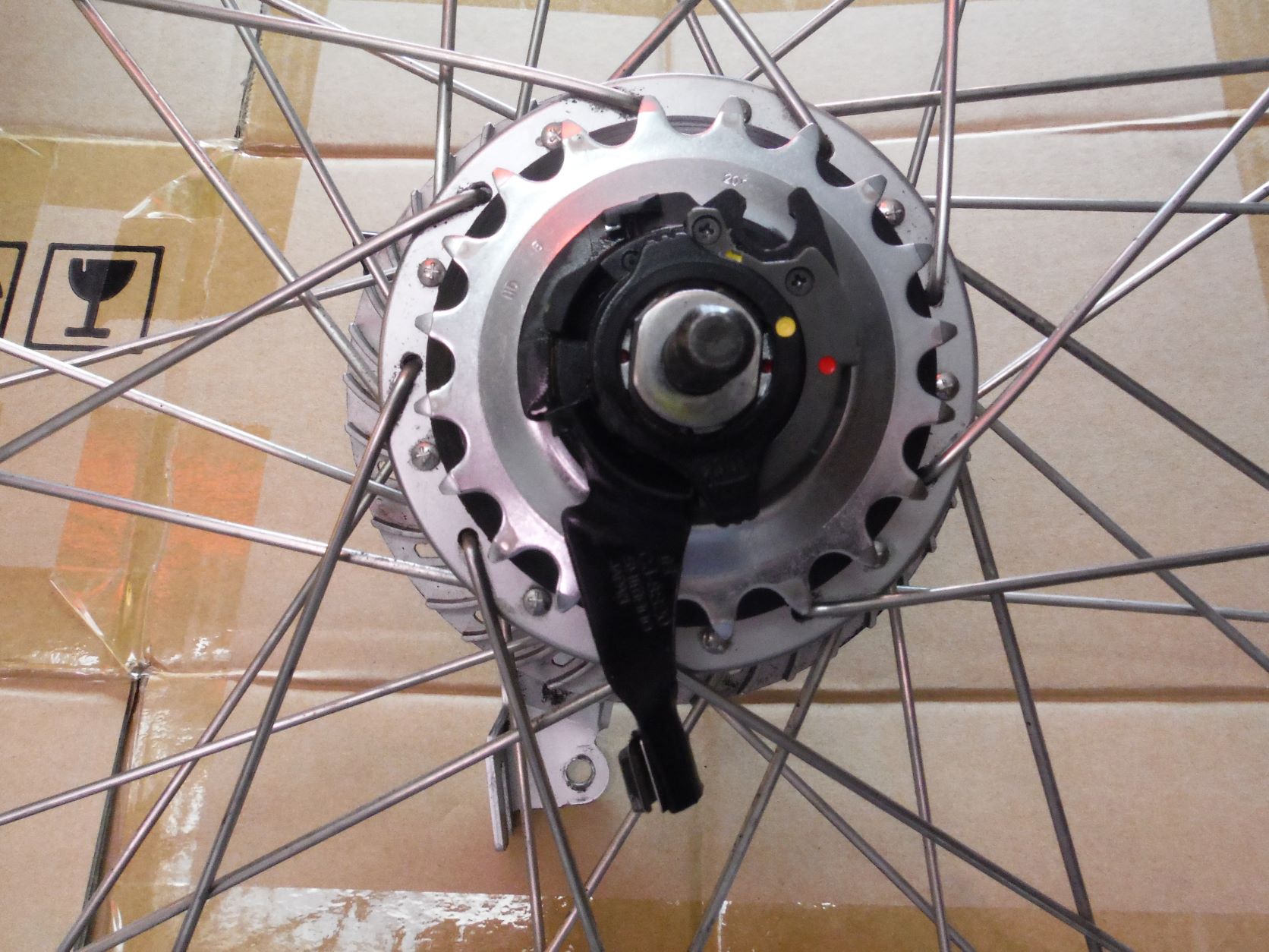

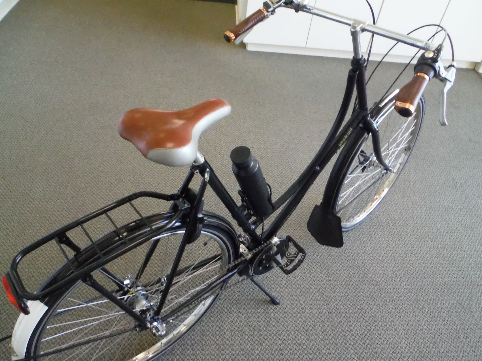

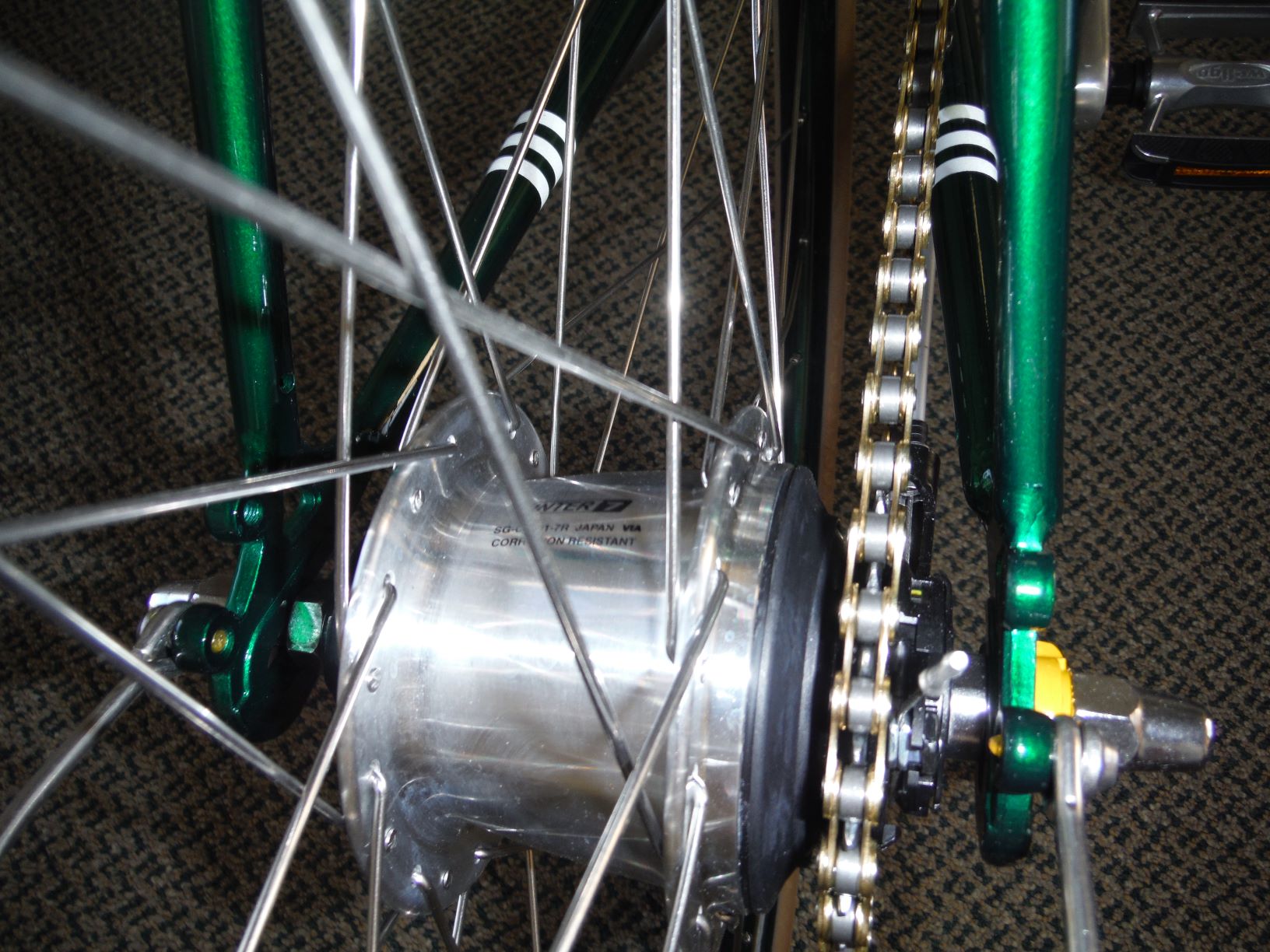

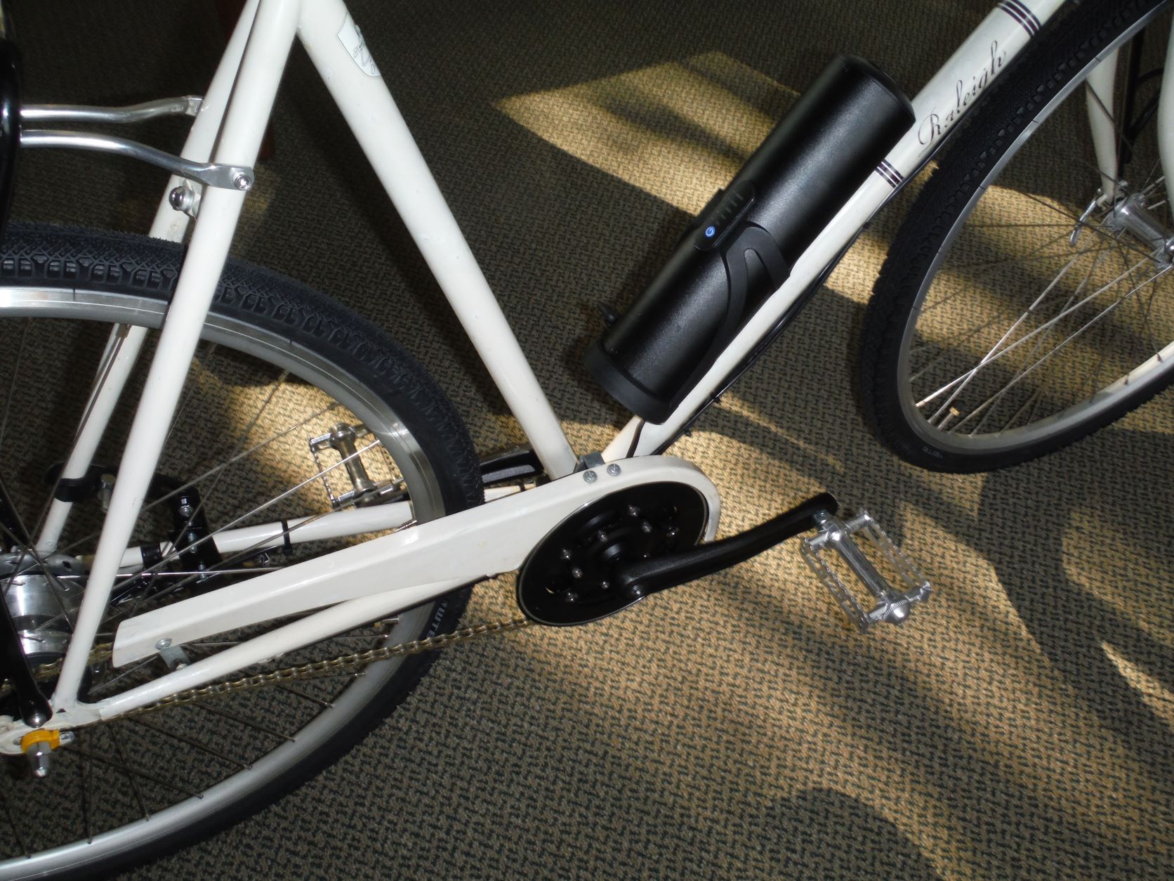

I have been using IGH's for years. I like my 3 speed Shimano and am building a second one today because I like it so much. Only shift when coasting or you will eat your IGH. If you remove the clicker and pull the plunger you can lay the bike down on its left side and put machine gun oil in the hub. They love that stuff. It could be that you have a kink or rough spot in your shift cable housing. Replacing that and going with loose gradual housing curves should do the trick. I have also owned and used 7 speeds and 8 speeds. If there is no photo then it didn't happen, so I will include some builds. Sturmey Archer has a heavy duty 5 speed with coaster brake. https://www.sturmey-archer.com/en/products/detail/rx-rc5. On my three speed Shimano I have dropped the cog to 16 teeth. In your case you might want to lower the gearing by using a larger cog on the hub. I have a CVT hub that I have yet to install. It is kind of heavy. It might land on a Giant Liv that I will give 90Nm on the torque sensing mid-drive.
