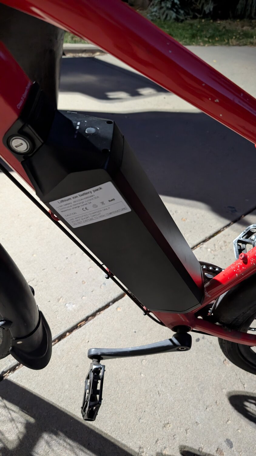

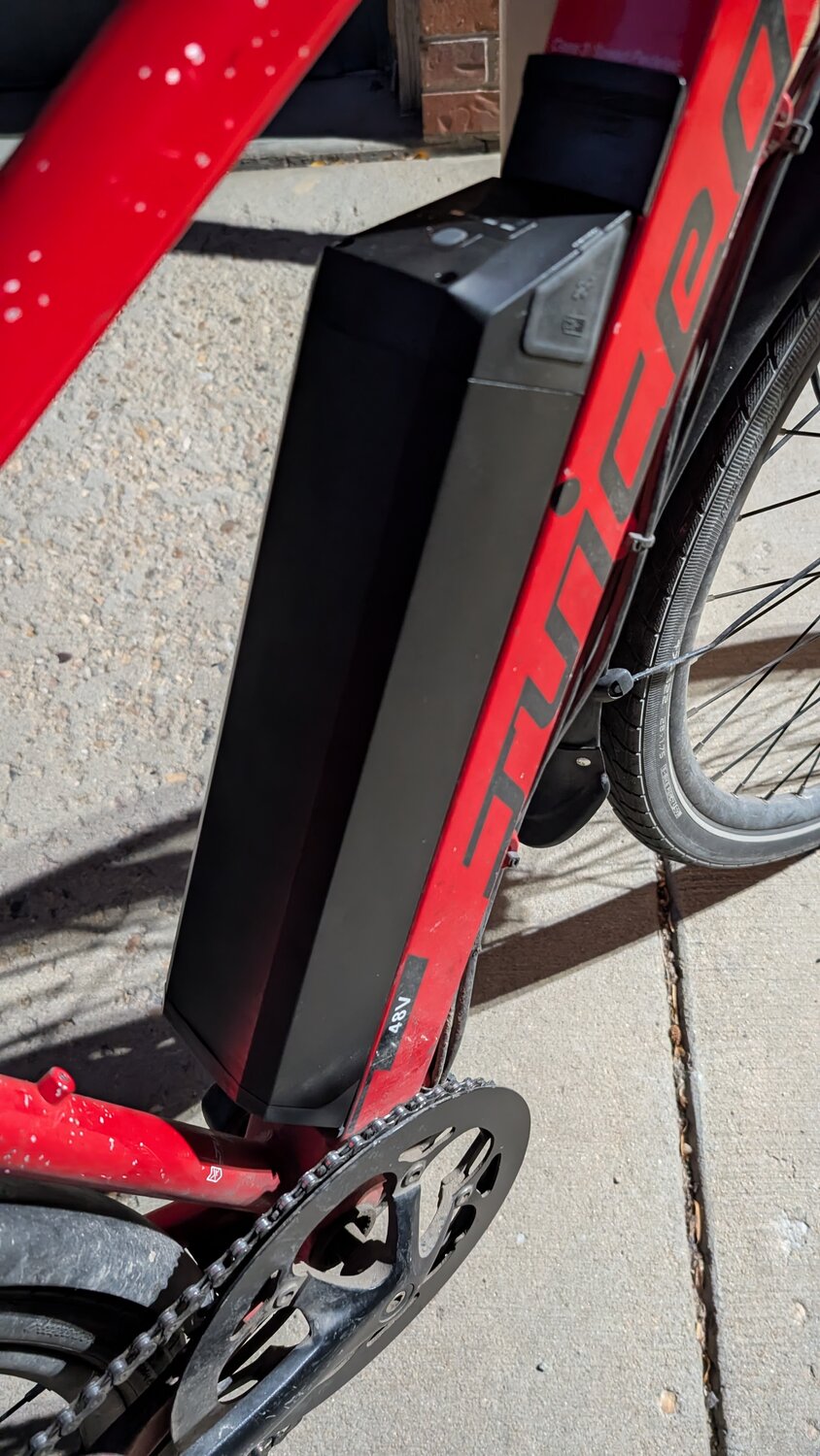

Just following up on this - I bought a new 20Ah 48V battery from Huizhou Jinfeng New Energy Technology Co, Ltd ( https://www.alibaba.com/product-det...spm=a2756.trade-list-buyer.0.0.704076e9jq9dWs ). The battery was US$190 and shipping via fedex was $115 for a total cost of $322.18
Shipping was quick(ish). Quality seems high based on 40 miles. Fit & finish shown below.
Replacing the battery eliminated all the issues I mentioned above.

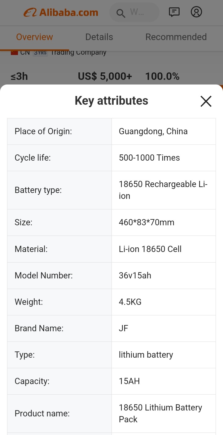

That looks like the 25Ah 48V battery Dorado battery that I bought for my ebike, but I paid A LOT more money for my battery.
The link in your post just lists the cells as Li-ion18650 lithium cells for the 36V battery.
(I didn't download the Alibaba app to check out the 20Ah 48V battery that you purchased.)
I hope you don't have crappy no-name cells in your battery?
My battery has quality brand name Samsung 50E 21700 cells inside.
If you do have no-name cells, there's a good chance that your battery won't last more than a year before your range is drastically reduced and the battery won't take a charge anymore.
(There's also a slim chance that with crappy cells, paired with a crappy BMS, that your battery will burn or blow up.)
Keep an eye on how far you can go on a charge to see if that distance starts reducing rapidly after a bunch of charges.
A cheap battery generally just wears out faster than a battery with quality cells inside.
Let's hope the new battery legislation that is happening everywhere (including China) can at least help to keep your battery safe?
I concur... You can't even buy enough name brand cells to make the pack for $115.
Definitely low grade cells. Be very careful charging.
