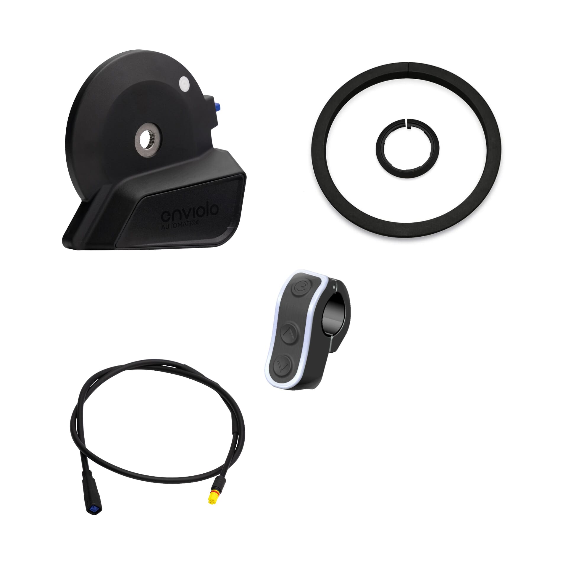

Might not be possible due to the rear hub mounting design - I bet I saw a topic on this forum when somebody tried to retrofit the Automatiq to the C380 or C380+ and found out this won't work because eshifter can't be mounted to the frame... If only Kindernay was still alive I would totally recommend it - I have it retrofitted on C380+ around 3 years back and it works fine since then. Unlike Enviolo, it has 7 gears and super cool hydraulic double-pusher shifter, which looks and works great.
Yeah unfortunately the design of this bike doesn’t allow the Automatiq. I made a thread and tried it.
The rear rack mounting and the (set screws for calibrating alignment? Still confused on the purpose of those) are both are in the way.
Looked at a bunch of other bikes from Tern, Spec, R&M and others would all work with Automatiq. Looks like the Gazelle eclipse would fit it too. Bummer. A bike like this should have the Automatiq.
I tried the Rohloff and it also solves my problem, though those are probably more than the bike is worth right now. Kindernay looks fantastic too.
