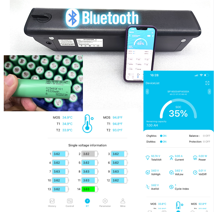

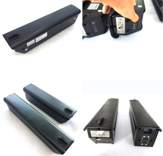

This is Jenny from Aijiu Energy and we have been promoting the Dorado 48V 25Ah since 2021. I am very grateful that we receive a lots of positive comments here. I am posting to introduce some new upgraded ebike batteries we are working on recently.
According to the demands for the upgrading battery capacity, motor power, and smart BMS allowing battery monitoring on cell phone.
We worked with JBD BMS to develope a small size 14S50A Bluetooth BMS to support max 48V/52V 1500W rated motor. It can be used for those popular integrated battery like Rhino, King Kong, Dorado and downtube battery Polly,Hailong...
Samsung 58E helps increase the single 21700 cell from 4900mAh to 5330mAh, which means now we can build 48V 26.6Ah or 52V 26.6Ah for those case designed with 70pcs 21700.
We would be appreciated if you could send us new battery requests.

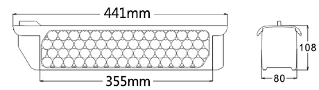

It is Reention Rhino IR-21700 on the picture holding 60pcs 21700, dimension 441x80x108mm, so max 14S4P.
The SYR Kungpeng 78-21700, or Reention Polly 21700-70, both availabe for building 14S5P 52V 25Ah by Samsung 50E or 26.6Ah by Samsung 58E.
Thanks for clarifying. I have the IR-5, so I’m stuck with that size. Since my battery size is limited, I think my battery can only get better if I get a blank case and use a better (than Samsung35E) cells. I’m no battery builder, so I’m sure I’ll reach out to someone like you when the time comes.
SYR024 Kun Peng, I believe it is the biggest integrated battery, holding 78pcs 21700.
14S5P 52V 25AH or 29Ah & 13S6P 48V 30AH or 34.8AH

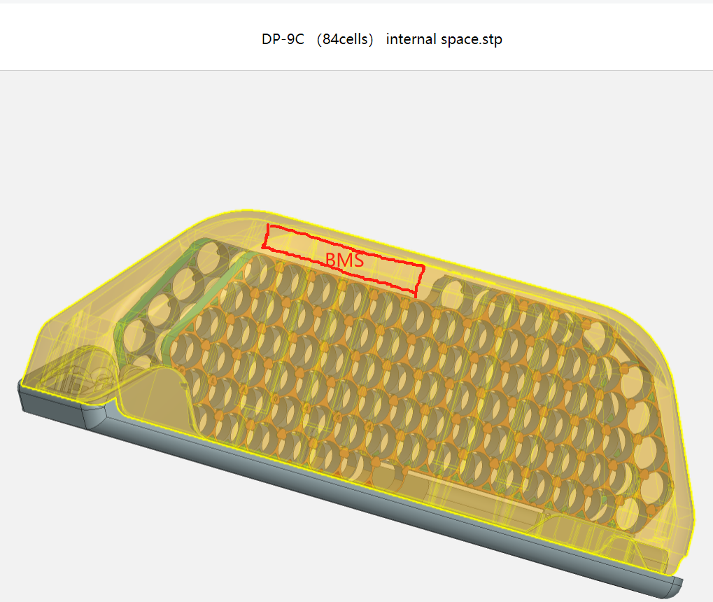

What would be the max capacity you could build in this 52V Reention DP9C case:
