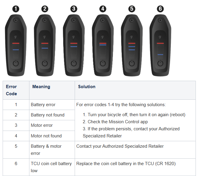

Just to make the matters clear:
If you are riding a Vado SL regularly, on some day you will notice alternating blue and red LEDs on the TCU.
The Error 6 is for the low coin battery in the TCU.
In case you have not ridden your Vado SL at the critical time, the coin battery might get flat meanwhile, and the TCU and the e-bike would appear dead.
Now, the new coin battery is inserted at the factory. CR1620 has a very long shelf life, so it is "as new" when you buy the e-bike. The coin battery would last for 1-2 years with the intensive use, and for longer when the Vado SL is ridden rarely. Therefore, I suspect your CR1620 simply went flat, and you had a bad luck talking to the "bad" guy. Please give the LBS a call and ensure they actually tried replacing the TCU coin battery.
