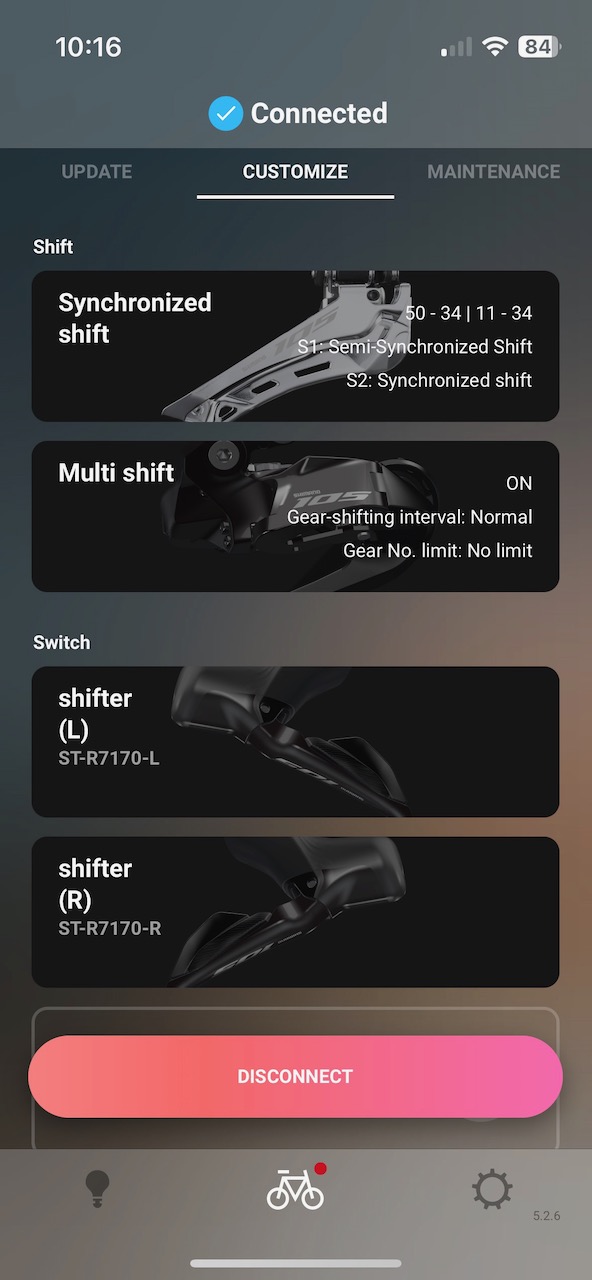

Do you have the E-TUBE phone app. available? I believe you can configure it under the "Assist" customization feature. I have the Domane+ with the 105 Di2 and I'm able to configure my left shift/brake lever to scroll forward/backward through my Garmin and control my bicycle lights using E-TUBE "Cycle computer" and my right shift/brake lever controls the front/rear derailleur using the synchronized shift & multi shift. When I first got my Domane+, I was torn if I should've spent more for hoods with the buttons until the bicycle shop mechanic proposed the solution that I currently use. I hope this information helps you.

Yes thanks I have that app and I have used it to configure the buttons to control my garmin scroll. But I do not have the option to use the buttons to control motor assist. I think this is because I lack that shinano part for the bike
