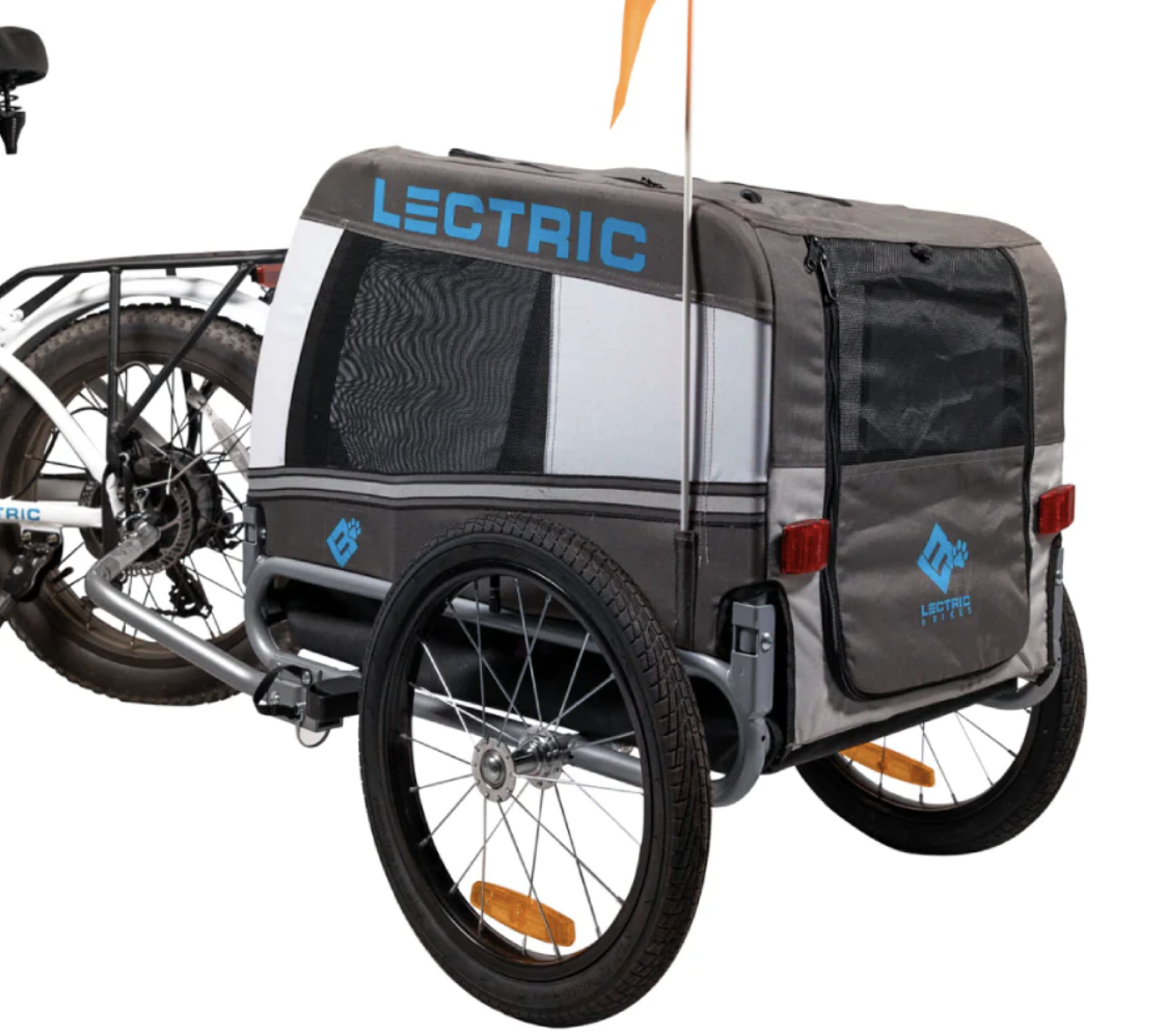

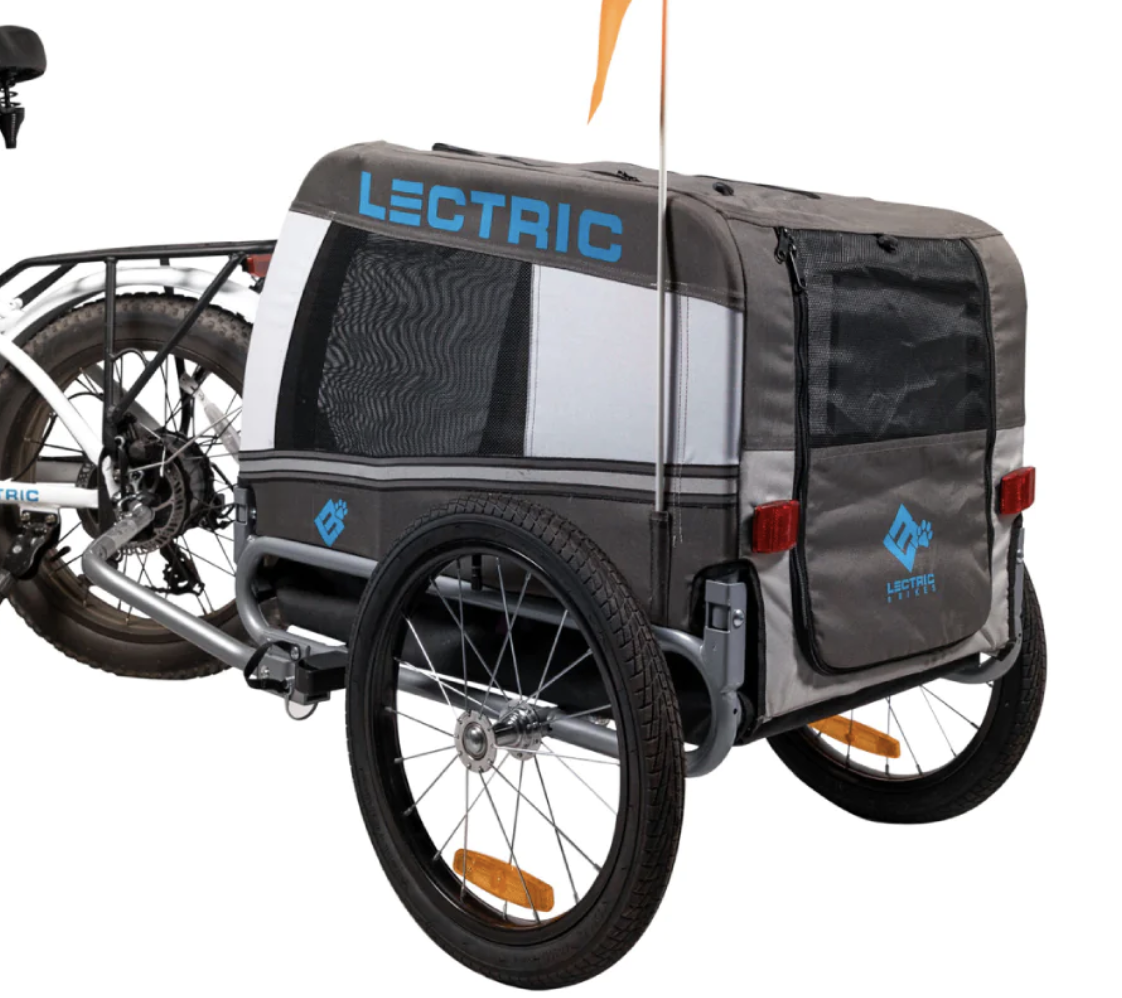

I recently bought a Turris (so recently that I'm still assembling). I'm looking for experience/advice about carrying a dog. I was thinking about this trailer from Lectric.
But.... Ride1Up says that they don't recommend axle-mounted trailers because they put excess weight on the left side, which strains the motor. Is that just being super-extra cautious? I won't be a super frequent user, and bike+trailer would only be about 40lbs. They recommended one with a seatpost attachment instead, but I've read that they're less stable and more prone to flipping over.

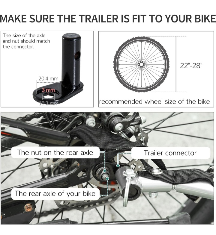

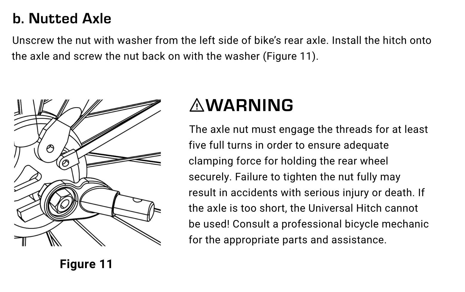

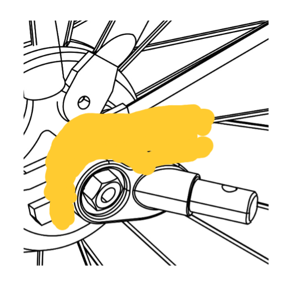

They also said that the Turris has a threaded axle rather than a nutted axle. Is that even a difference? I'm trying to figure out if the carrier is even compatible. Pic from Lectric instructions:

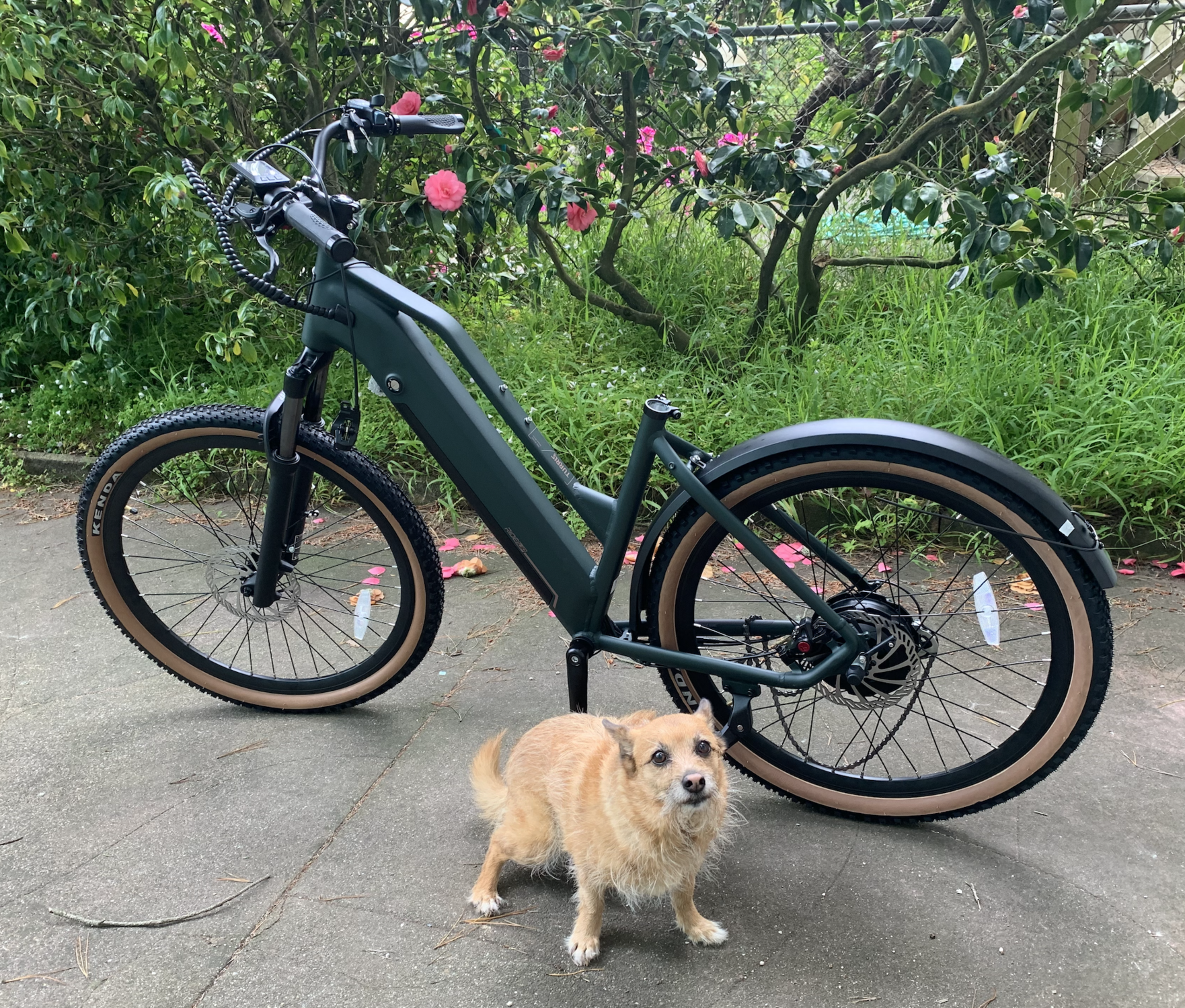

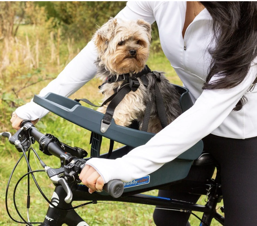

As you can see in the picture below, my dog is the anxious worried type. He got suspicious and weirded out just being asked to sit by the bike so I could take a picture to show his size. With that in mind, is a trailer the best option for stability etc. or should I consider something mounted on the handlebars, or even a basket? I was looking at the BuddyRider (shown in the last pic) and I like that he'd be up with me and maybe feel protected by my arms, but he'd also feel "suspended" and a lot more movement from the handlebars. He hates flying.

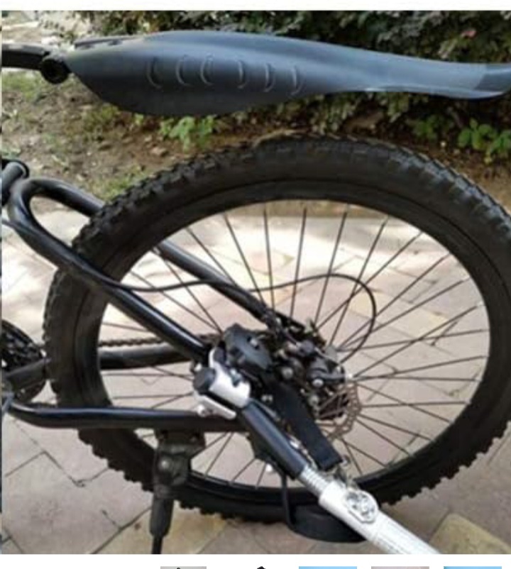

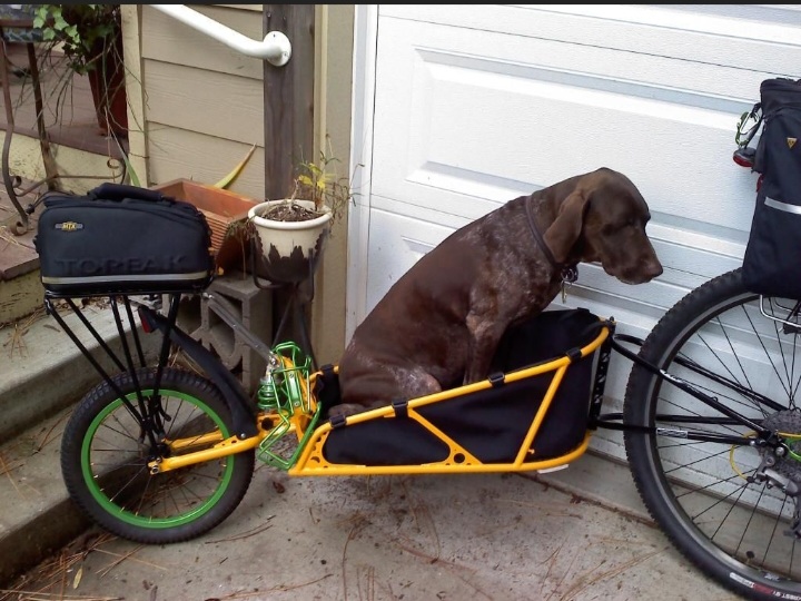

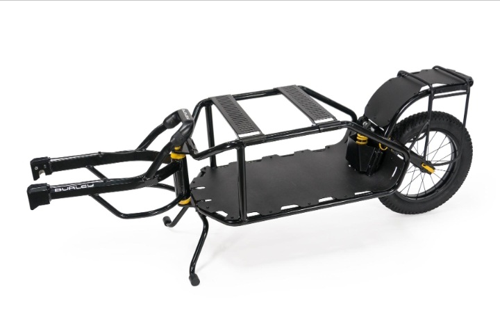

They do have one wheeled bike trailers that attach to both sides of the axle,..
There might be a clearance issue with your ebike at the axle flange?
It's hard to tell from the picture of your ebike.

Haha, yeah, the "hangdog" expression is real. I wonder how stable those one-wheeled trailers are.
Given that I see e-bikes of all brands with trailers pulling kids and bigger dogs, I'm tending to be a little skeptical about Ride1Up's advice. I mean, they basically all have similar design and technology, right?
The trailer is a stable as your ebike is.
When your ebike leans over, the trailer leans over at the same angle.
Your dog should get used to it. It won't be sliding left and right when you go around a corner like a dog in a two wheeled trailer would.

Yeah, you should have enough thread to bolt a trailer attachment to it, but see if there is anything blocking the area where the hitch will be.

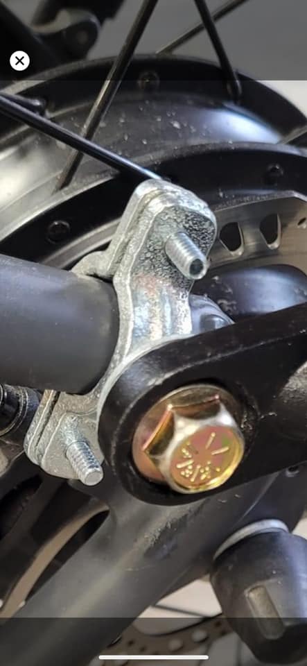

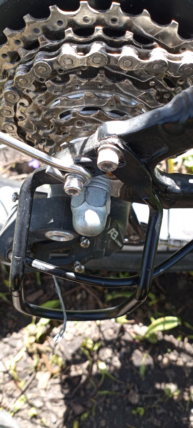

This is my ebike.
I'd have to remove my fender brackets and my derailleur guard to install that trailer hitch.
Can you take a close up picture of your axle flanges so we can see better.

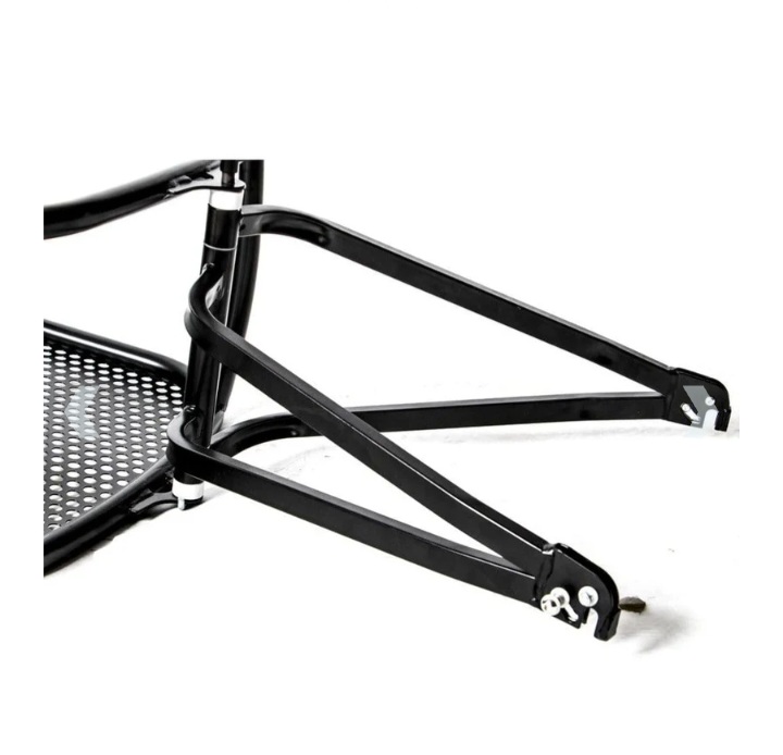

The attachment will look like this,..
You'll need clearance for it.

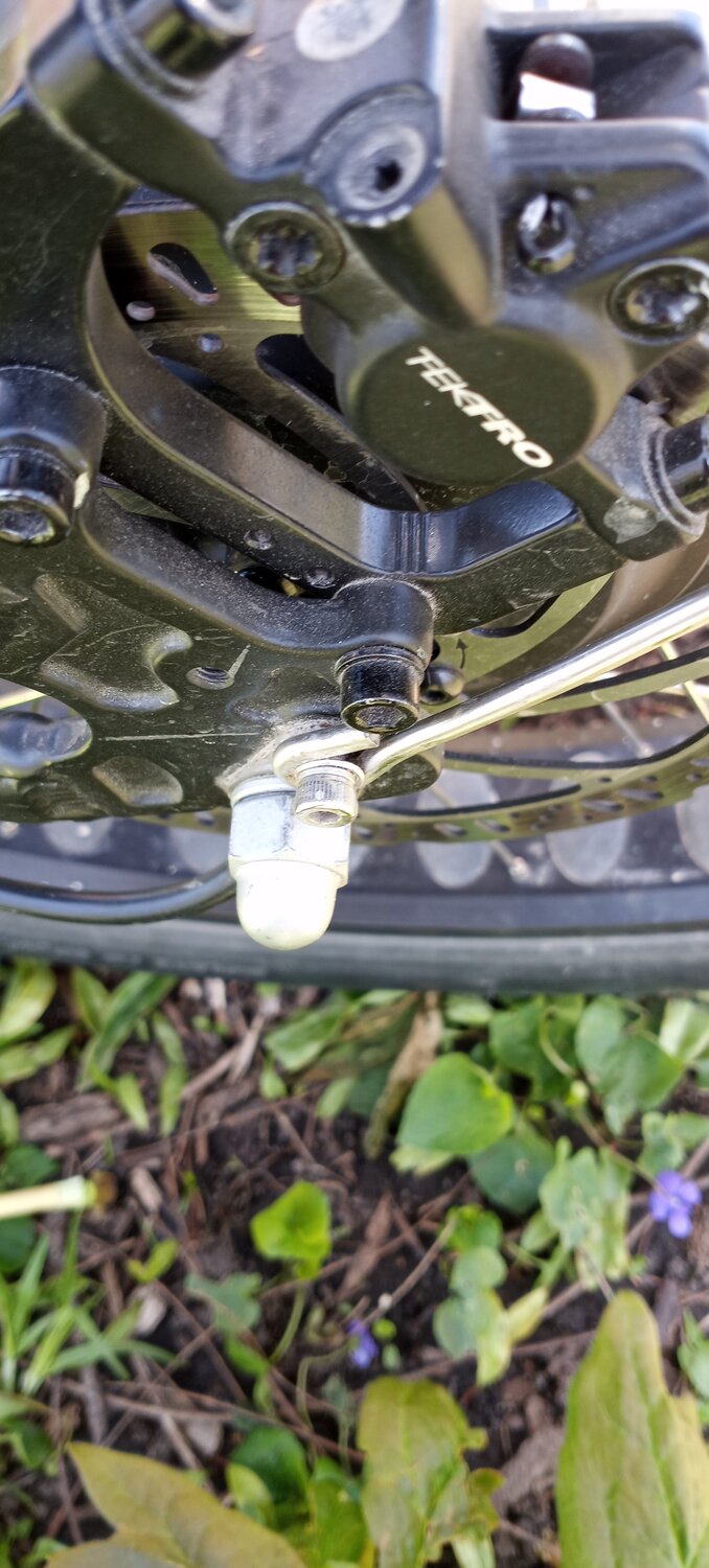

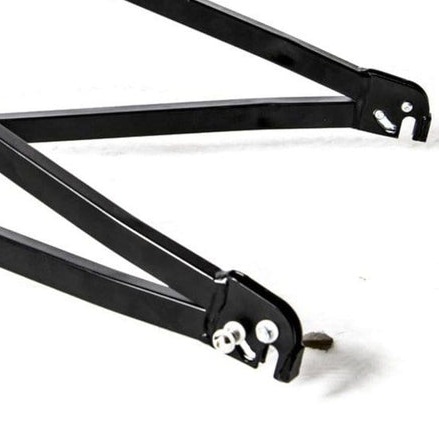

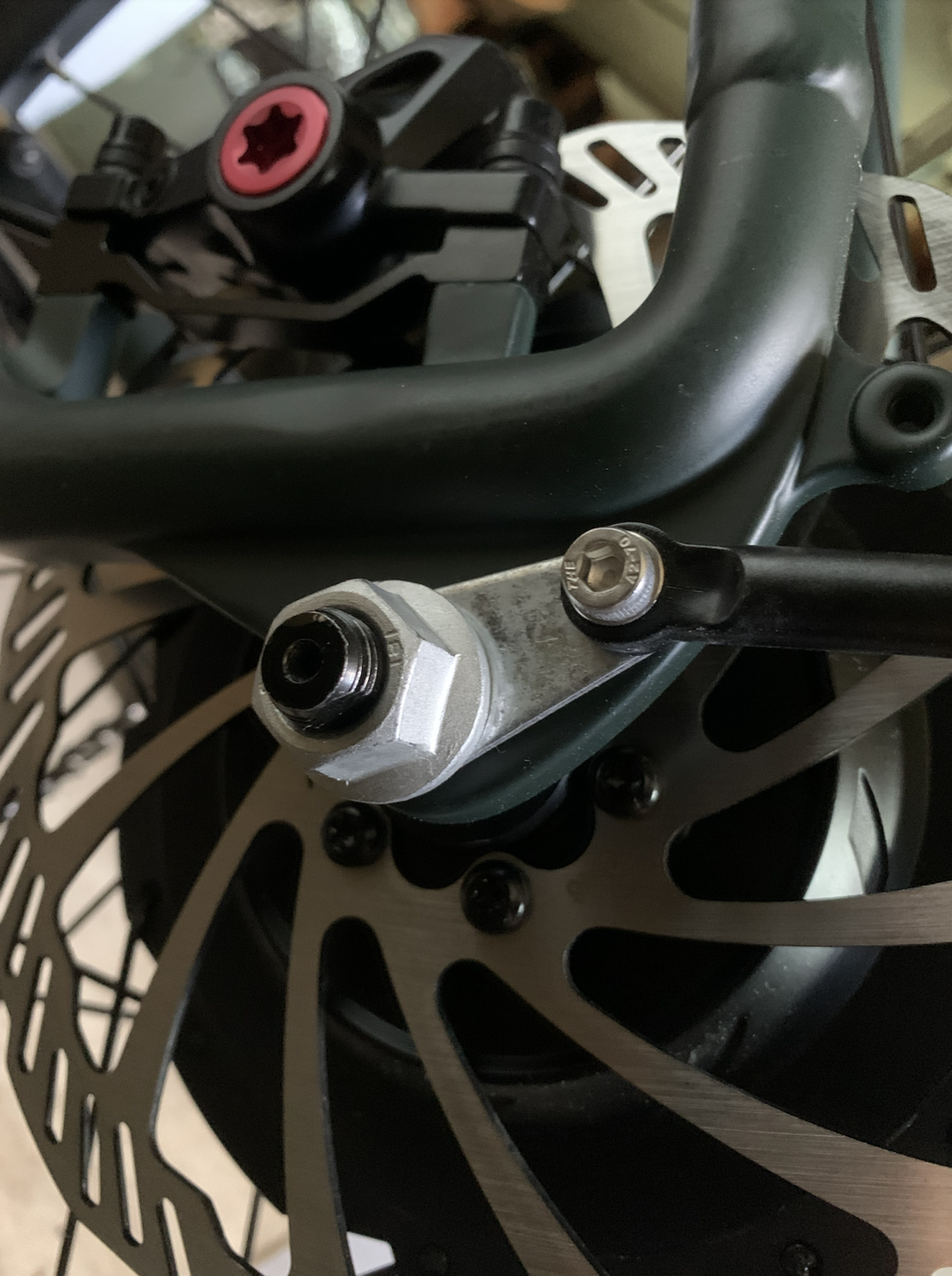

Here's the bike axle, and my first post has a screengrab of the instruction manual for the trailer I'm looking at:

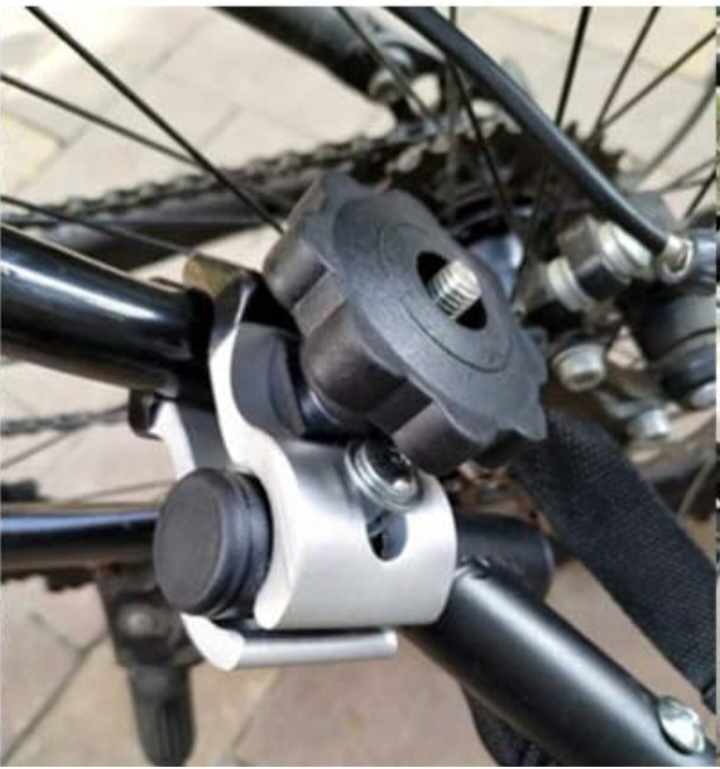

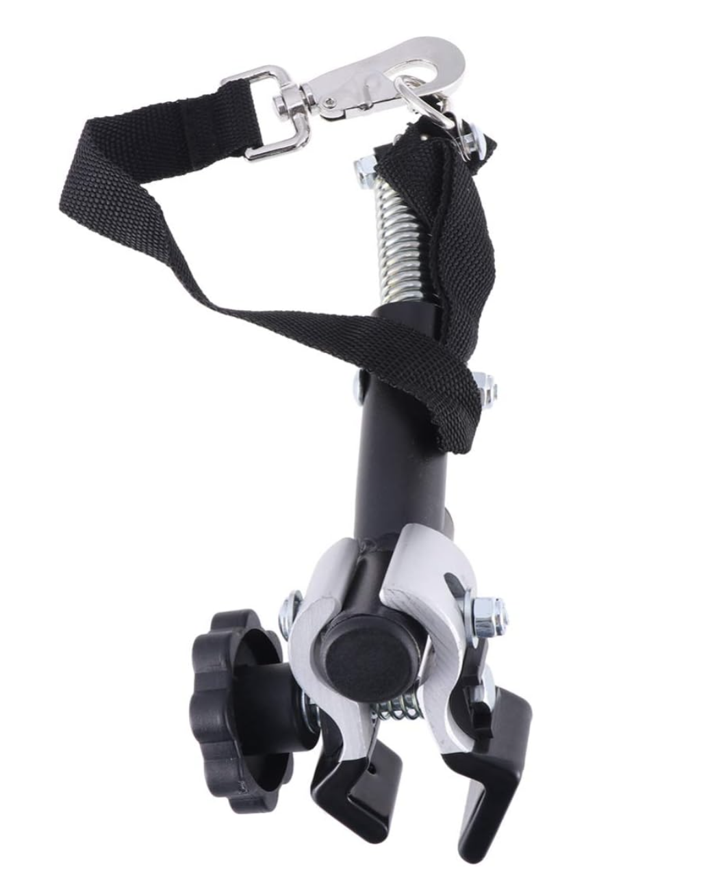

I was told in a FB group that I'll need to either get an hitch adapter (top) or use a pipe hanger bracket (bottom):

,.. my first post has a screengrab of the instruction manual for the trailer I'm looking at:
That's what I've got on my old e-bike and it should work for your ebike.
You've got a frame tube just above your axle, but that attachment should clear it.
The one wheeled trailer attachment hooks down from the top so you could remove the axle bolts and slide it on but it may not clear the frame tube because it's kinda big?

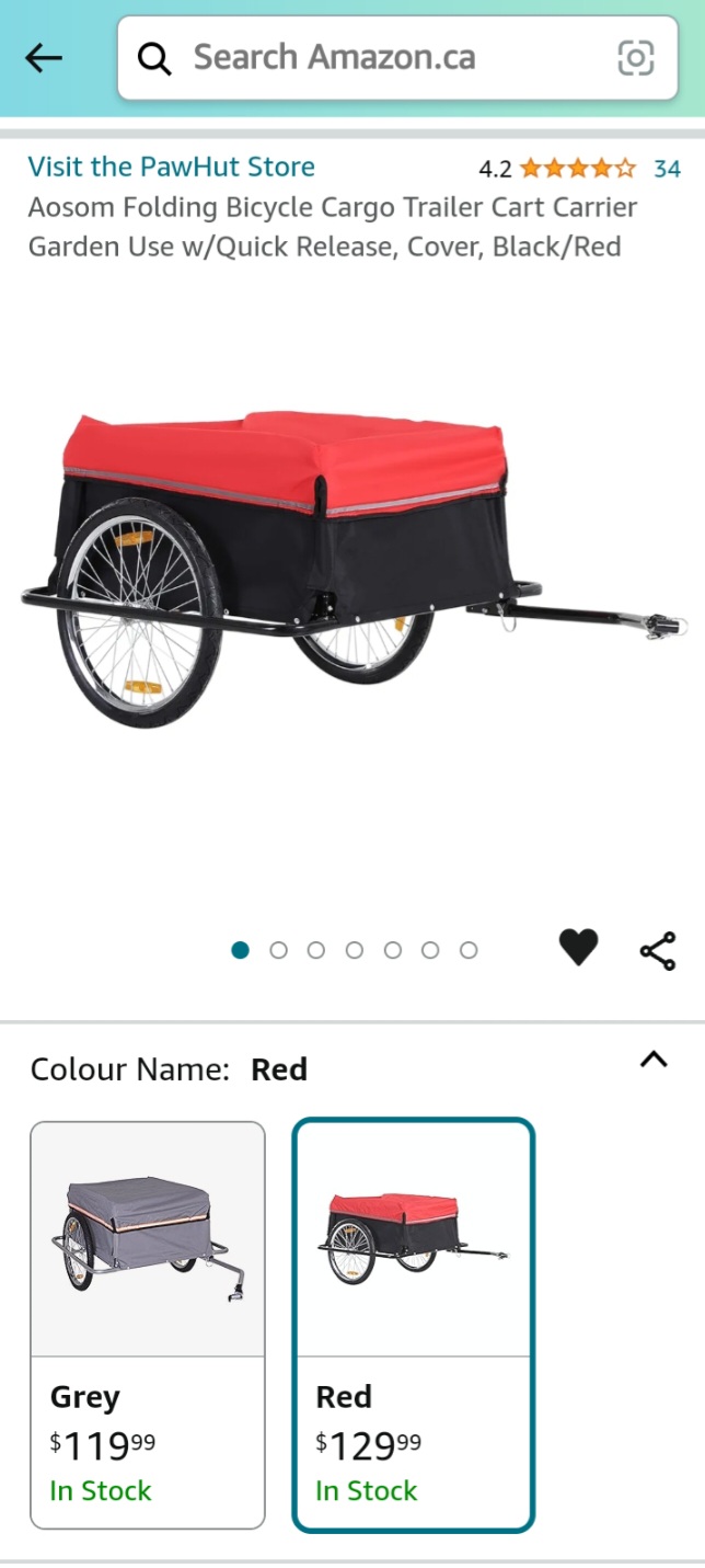

That hitch adapter and axle connector is what I have,..
I did have to drill out the axle hole bigger because it's for a 10mm bike axle my ebike has a 12mm axle.
I'm sure you'll be fine with a two wheeled trailer and attachment like mine, especially if anyone on Facebook has done it with your specific ebike.

Whatever you do, don't remove the metal plate under your axle nut and always check and make sure the allen bolt (on top of the fender stay) is always tight. That plate makes sure the motor won't spin the axle in bikes frame.

I like this one.
Same thing as the ones I looked at on Amazon Burley about $500 .
And you have the option to install hub motor on it.
I looks sturdy it even has coil shocks to absorb wheel hops when not loaded
