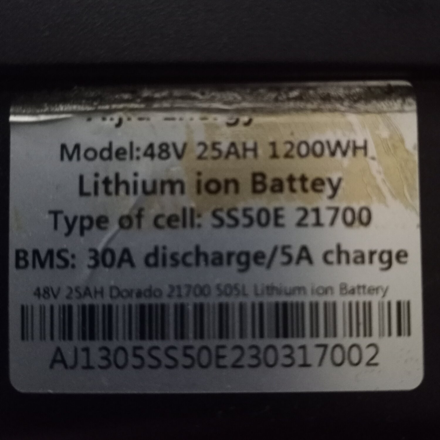

My 48V 25Ah battery has a 30 amp BMS but can only charge at 4 amps.
Why is that?
I know it has something to do with the internal resistance of the battery that creates heat, but wouldn't that internal resistance be the same whether the battery is charging or discharging?

It just seems weird that my BMS can safely discharge my battery at up to 30 amps continuous, but when you put the charge back in, you can't go past 4 amps. 0.2C or less is the recommended charge rate.

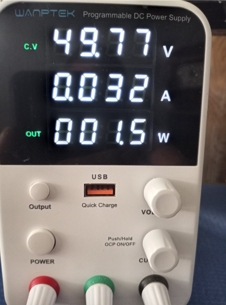

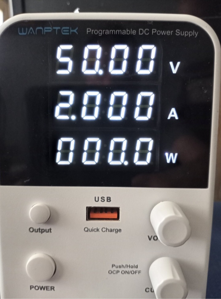

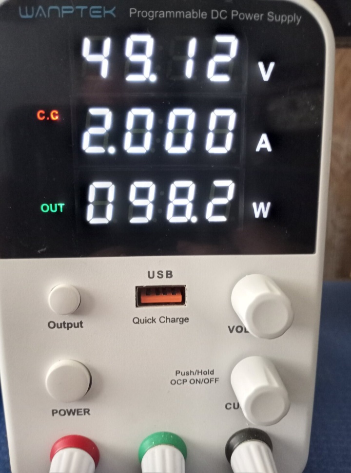

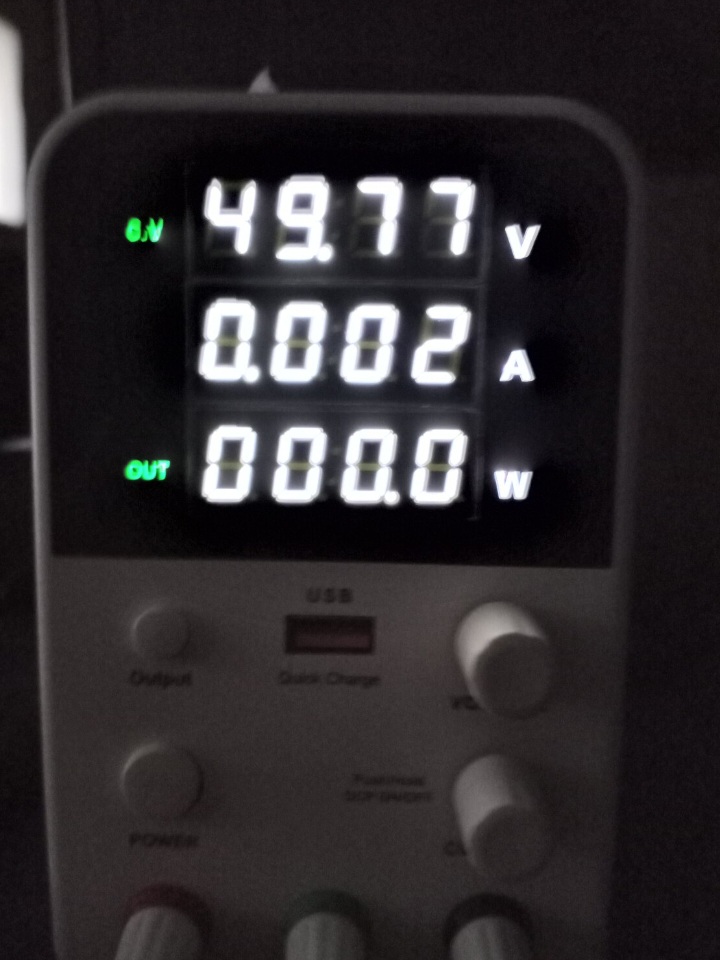

I use my bench power supply to charge my batteries.
I only charge to ~50 volts at 2 amps, charging indoors with me watching the charging as it happens.
It's essentially a manually operated Grin satiator, but I get to see the voltage and current in real time.
The power supply is right under my TV and I can keep an eye on it as the charging happens.
It's quite exciting watching it switch from constant current to constant voltage. 😂
Way funner than watching the red light turn to green on a regular charger.
Then, after the current drops to zero, I shut it off and top it up to 54.6 before my next ride.
I just started charging to 51.6 volts so it doesn't take as long to top it off before my ride.
That's ~80% charge, so not too bad to let it sit at that for a few days until my next ride.

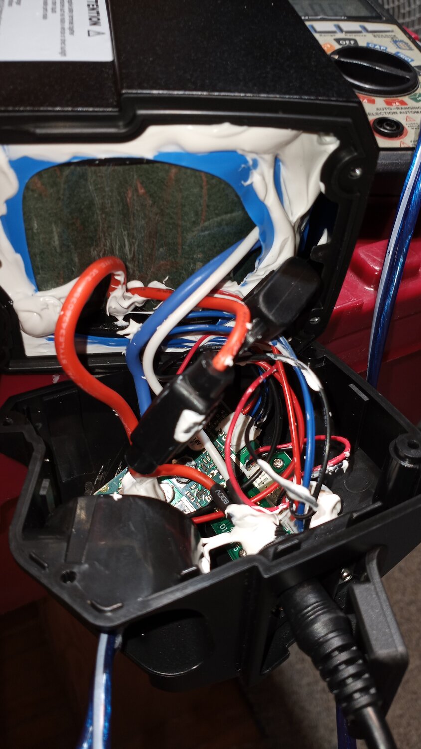

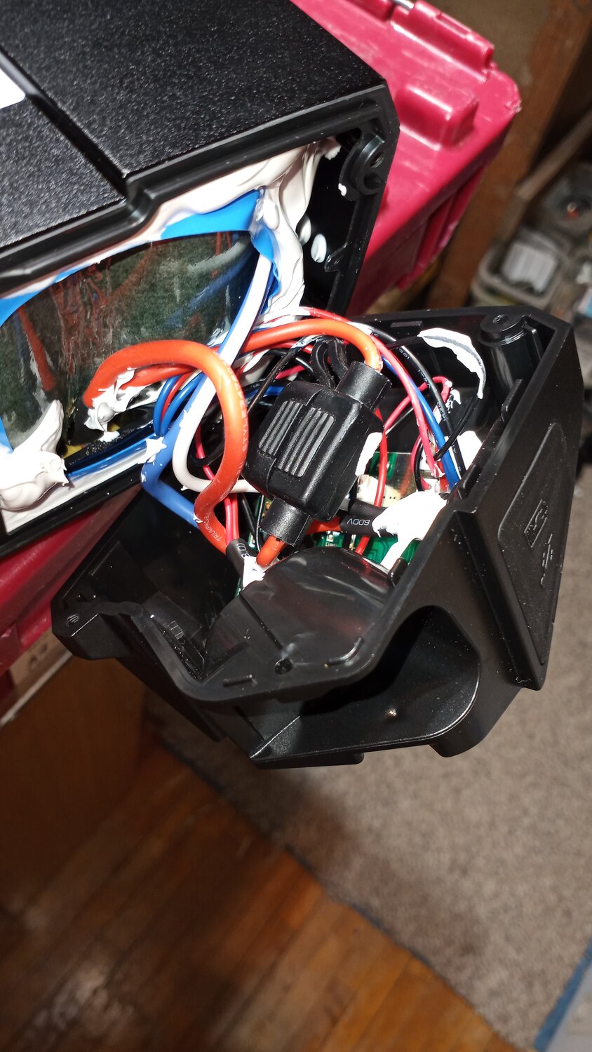

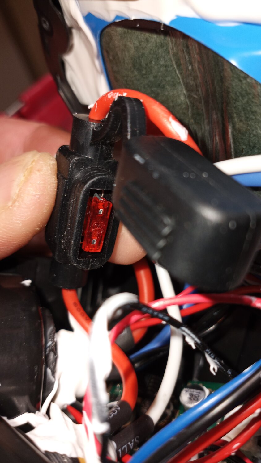

I just checked my 25 Ah battery and it says 5 amp charge,..
But there's a 10 amp fuse on the charge port inside the battery,..
So it looks like I could charge at up to 10 amps.
I would NEVER Do that BTW.
I charge at 2 amps, because it's better for the battery (less heat) and I've got the time.

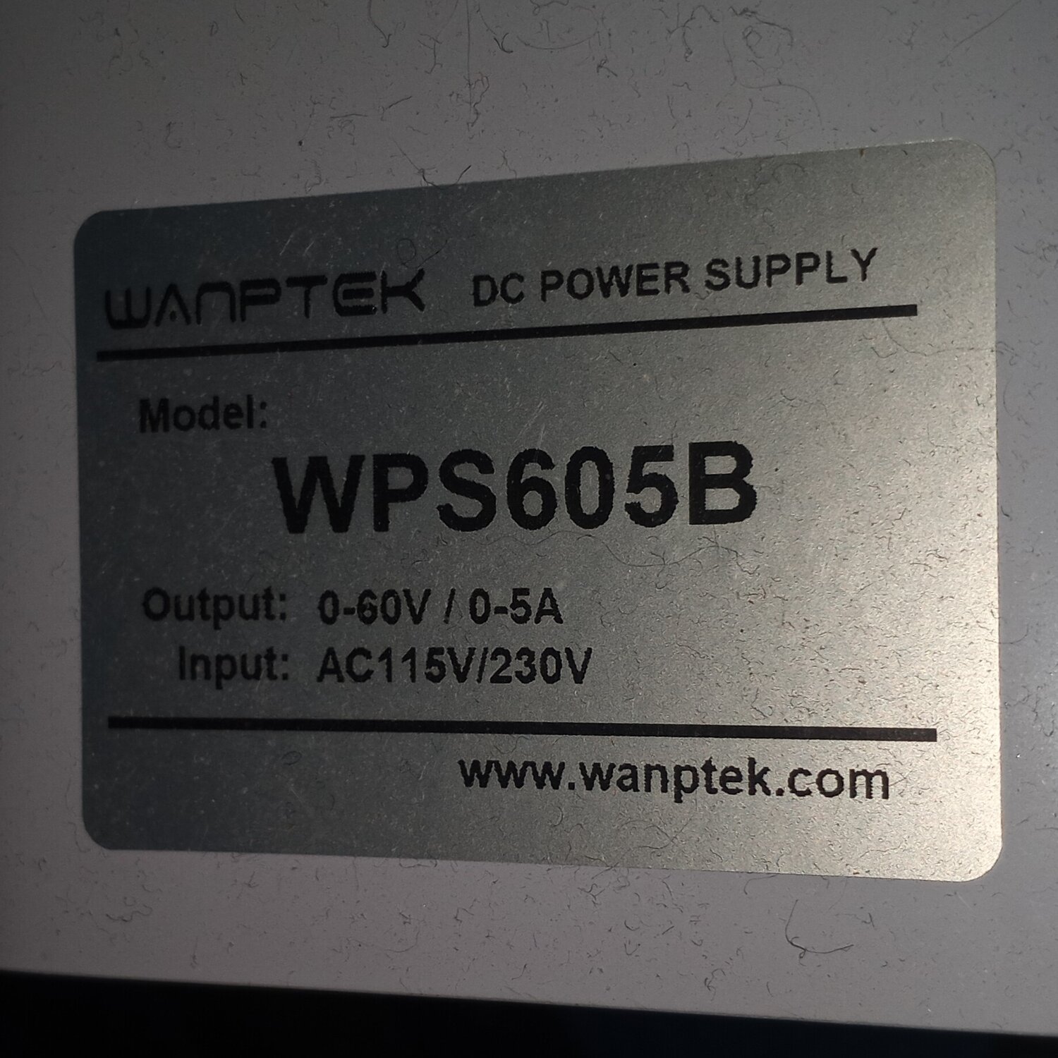

I don't want to pull 5 amps out of my power supply either. It should last longer if I don't max it out.
The most I've turned it up to is 3.5 amps to top up to 54.6V quicker before a ride.
@m@Robertson has 3 identical Wanptek power supplies and 2 of them have crapped out on him already.
He does like to turn things up to Maximum though. 😂
I make sure the automatic fan in the power supply isn't running constantly.
Heat is bad for the charger too.
