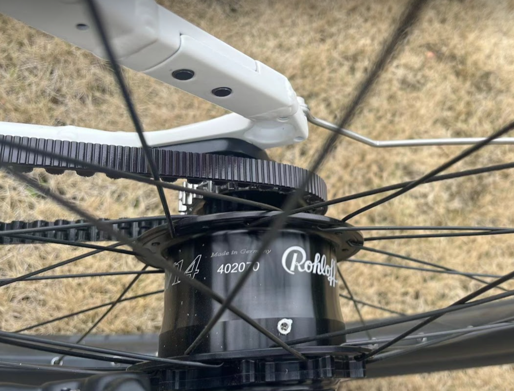

To this wonderful EBR community, we wanted to let you know that our team is building a few units of this very special bike - Zen Photon 'Ultra'.
This E-bike is based on our Zen Photon platform but uses the Bafang Ultra motor and Rohloff 14-speed hub along with Gates belt drive - hence the name "ultra". Our custom Zen motor is powerful enough but some folks wanted to make use of the generous 750W limit offered in the US.
If anyone in the EBR community is interested in this high-power build with the Ultra motor, Gates belt, and Rohloff speed hub, please reach out.
We have already received a few deposits and it would only make it easier to build more units in this batch. We are only taking deposits and the remaining amount will be paid before the shipment leaves Canada.
This E-bike is going to be a very powerful rig, not for someone looking for a light weight E-bike. Someone who wants super heavy duty, long-range rig. See key specifications below:
  1. Bafang Ultra - 750W (legal), 1000W (off-road version)
  2. Rohloff 14-speed hub
  3. Gates belt drive
  4. 1040 Whr battery (52V, 20Ah) - UL certified battery (from true UL agency, not a 3rd party tested)
  5. 4-piston brakes
  6. Air-suspension, 15x110mm front wheel with Boost spacing, Zen custom suspension seatpost
  7. There is always a special connection to the EBR community, and the price of this rig is going to be very competitive with anything else on the market.

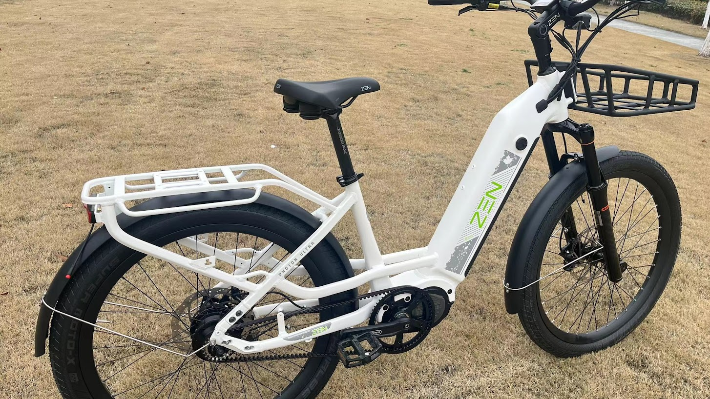

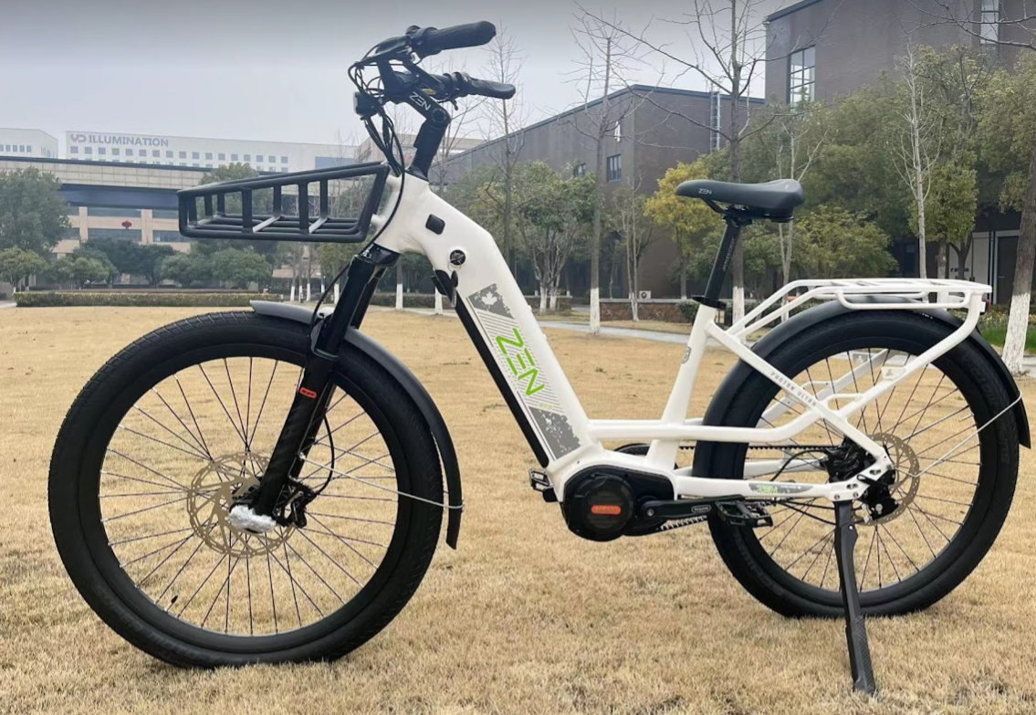

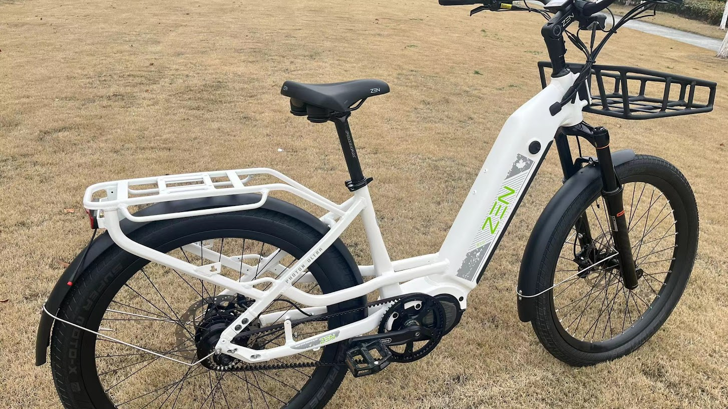

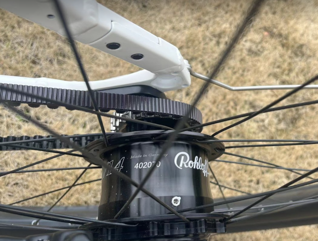

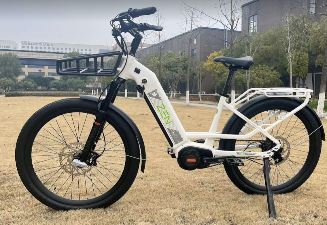

Good day to all. Are there any updated photos for the Ultra either here or the website?

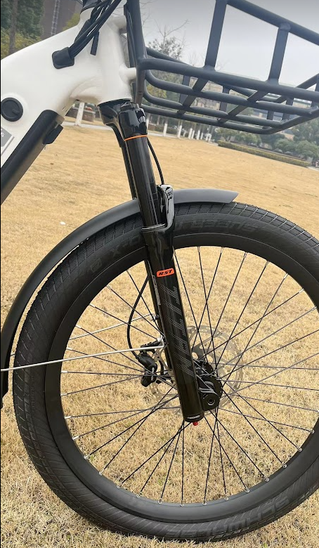

These are some images of the Ultra bike soon after assembly at our factory. you will notice the suspension forks are top of the line - Titan model from RST.
These frames arrive in SKD condition and then go through the final QC/QA in Canada. These frames are expected to arrive in Canada towards the last week of March.

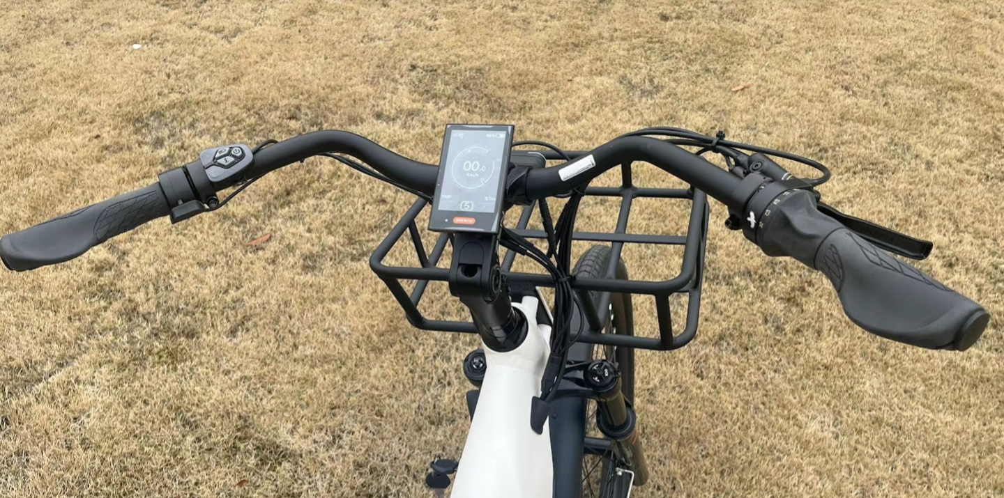

Hi to all.

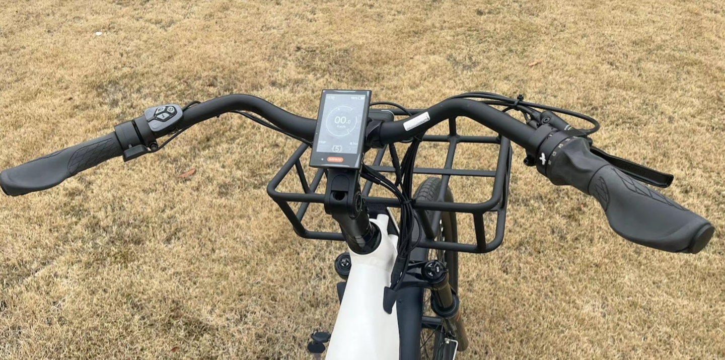

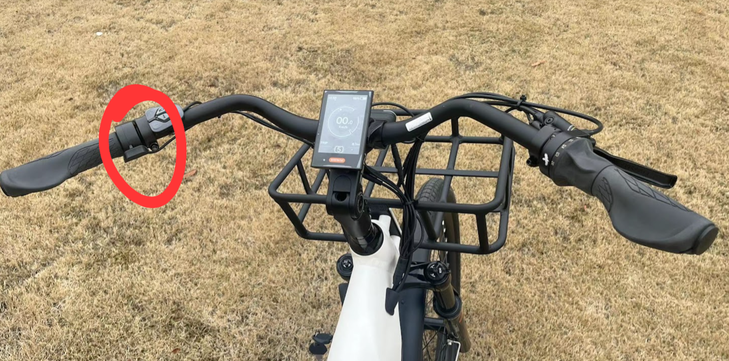

It appears that this bike will at least have the option for a throttle, or will that come standard? And will there be an electric shifter option for the Rohloff also? Cheers
Hi to all.
Throttle yes but I don't believe the e shifter is compatible with Bafang at this time.
as Gionni mentioned, the bike has a throttle (actually, we have improved the throttle hardware from what you see in the picture)
and the Rohloff E-shift is only limited to Bosch and Panasonic motors. As of now, no other motor works with Rohloff E-shift.
