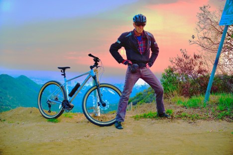

I keep seeing 'You are ignoring content by this member'. What is up with that? Oh well. I will never know. Yes, by taking the reigns into your own hands you can get a better bike than anything factory. This modular, interoperable, opensource bike has an 10-52 twelve speed with a torque sensing 90Nm cargo motor. Batteries can be swapped for various sizes based on the ride that day. It has zero zip ties and no connectors. It lives in the Hollywood Hills and will kick the butt of any factory bike.
