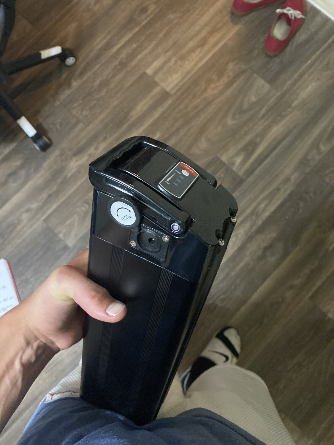

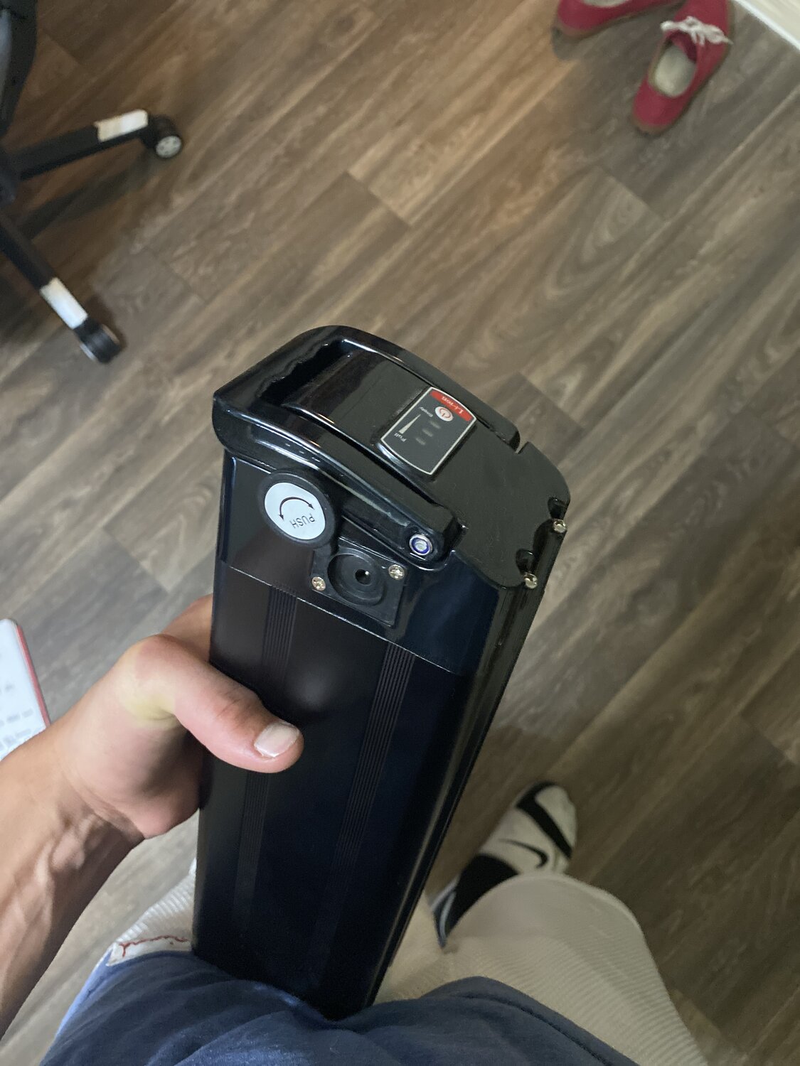

48v battery only lasting about a mile
That's the very common silverfish battery. It comes in different lengths, but the common size should hold a max of 65 cells (I have an empty one here to look at), which would make anywhere from a 48V12.5AH to 48v17.5Ah, depending on what capacity cells they put in,

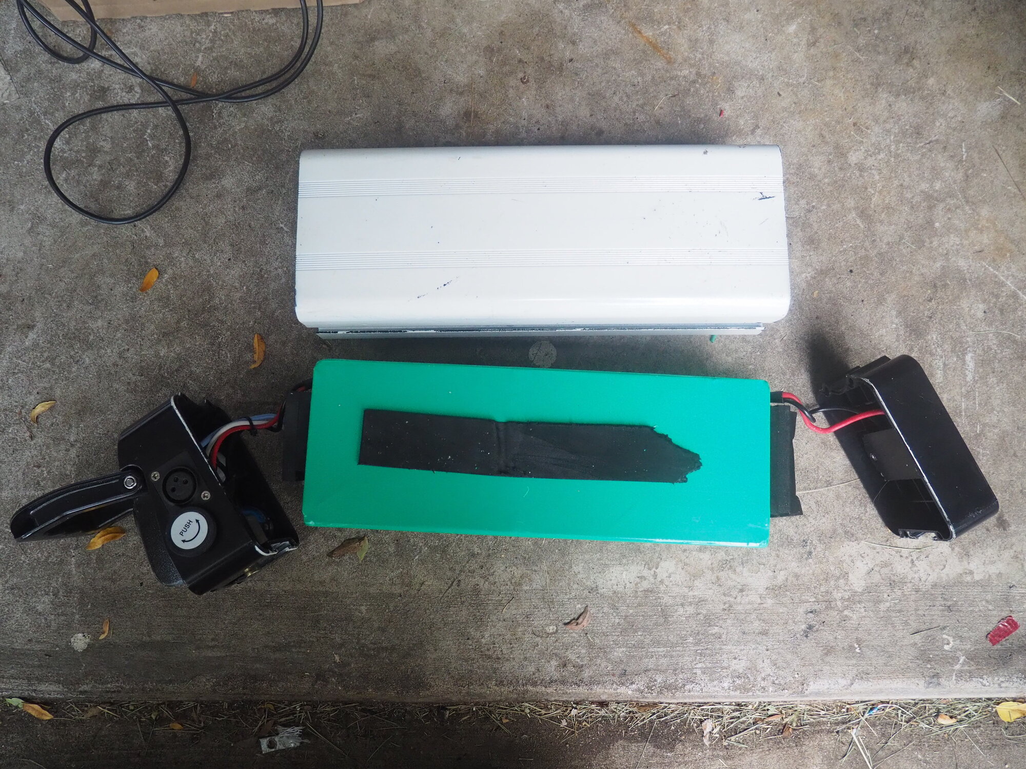

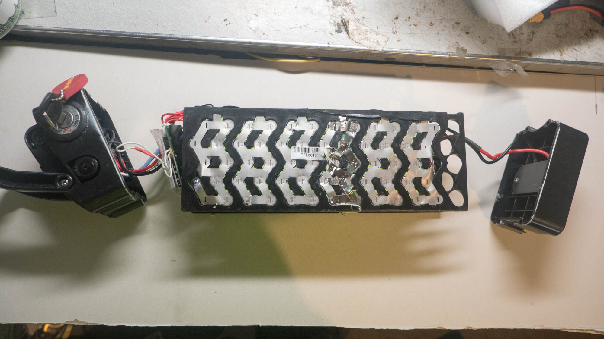

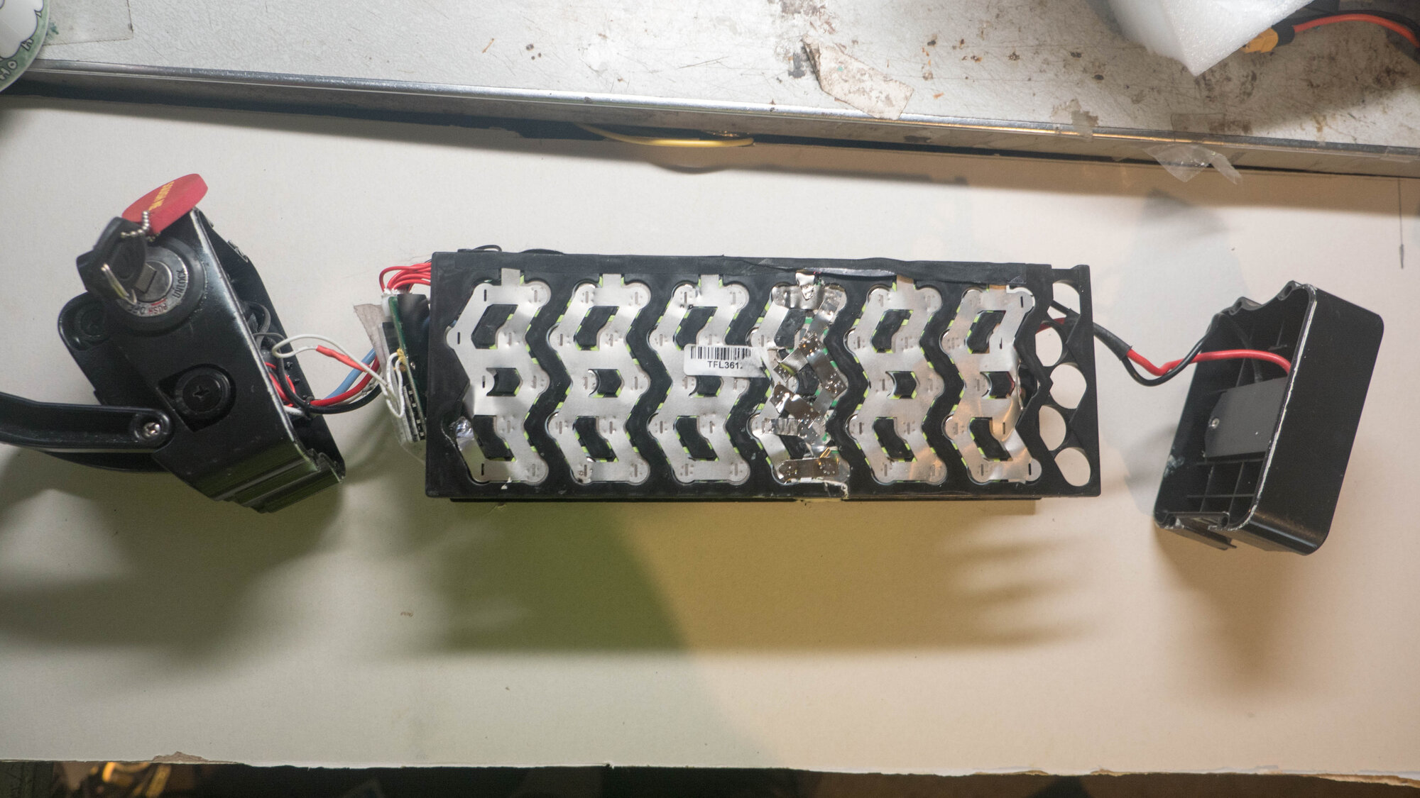

The cells in my Silverfish were in the plastic cell form shown a few posts above above. The dimensions are around 67 x 82 x 260 mm. I onlu had 50 cells in mine to make a 36V battery, Fylly populated, that form could hold a 5x13 array of 65 cells. The resulting capacity could be 48x12.5AH up to 48V17.5AH depending on the AH of the cells used.
The inside dimensions of the white metal shell are 71 x 93 x 285 mm. This pic shows the original cells in a green shrink wrap.
If you went to buy a shrinkwrapped pack, most of them quote 70 x 110 x 268, probably because they put the BMS on the top of the cells to make it 110 instead of 90. They usually have a fiberboard shell around the cells too.
One could still buy one of them,. take it apart. move the BMS. and re-wrap it. However, most of the shrink wraps on ebay aren't any better than buying an inexpensive 48V silverfish,

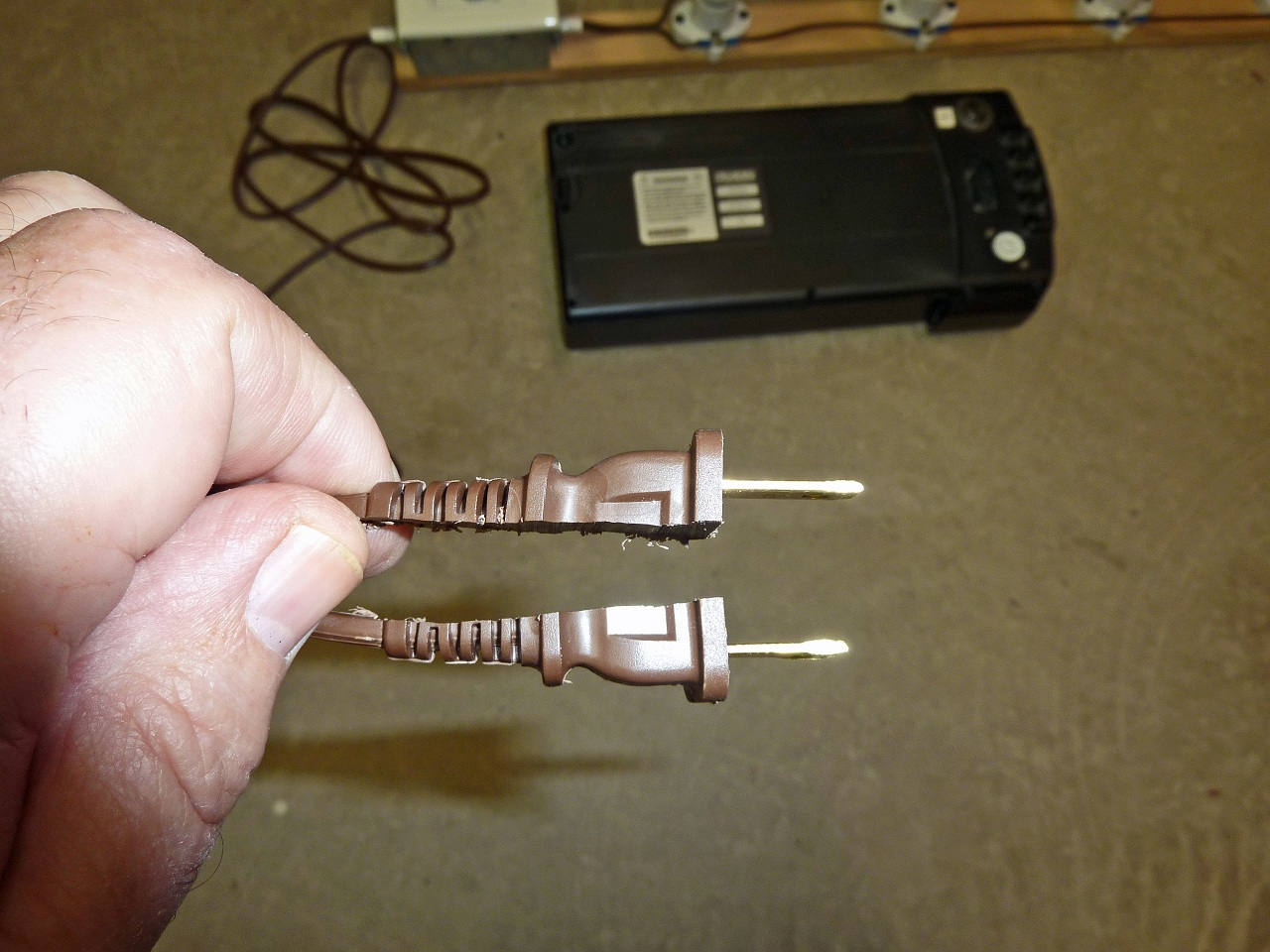

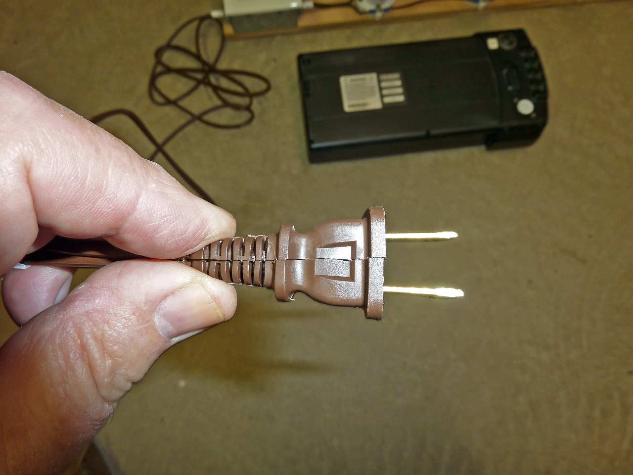

Depending on the BMS, a simple way to discharge is to buy a cheap 2 prong extension cord and cut the plug in half. The prongs will fit into your battery terminals.
Be careful NOT TO SHORT THEM! Turn the battery switch off first if you have one.
Wire the other end to a bulb socket like this one and use a low voltage LED bulb:
It takes time to discharge and hopefully, the BMS won't shut down with the low drain. Using multiple sockets or different bulbs can shorten discharge time if necessary.

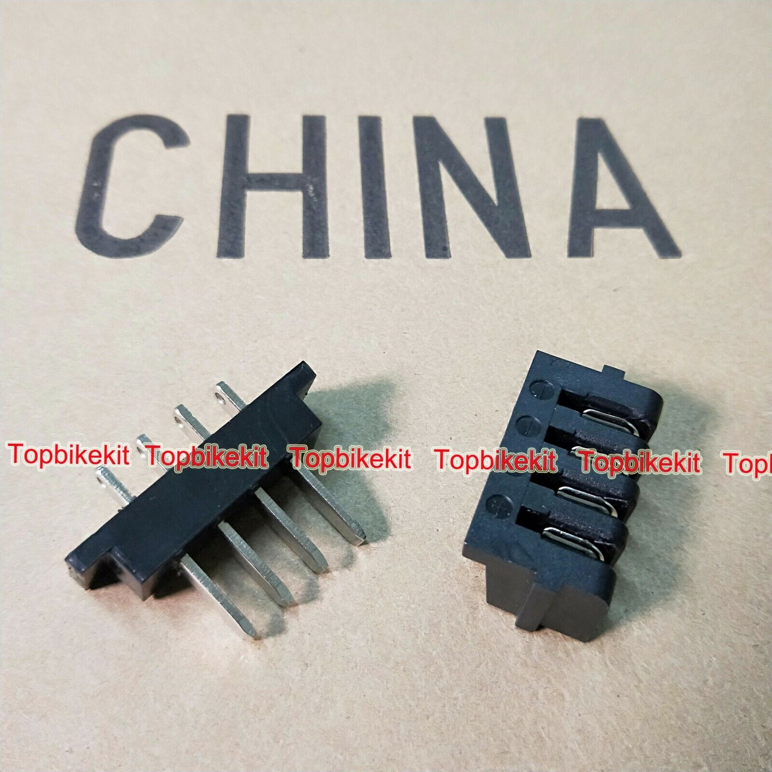

Also any suggestions for a quality battery for this bike? I’m not sure how universal the plug in ports are but I have 2 prongs approximately an inch apart
FWIW, this is a plug that should fit your battery:
