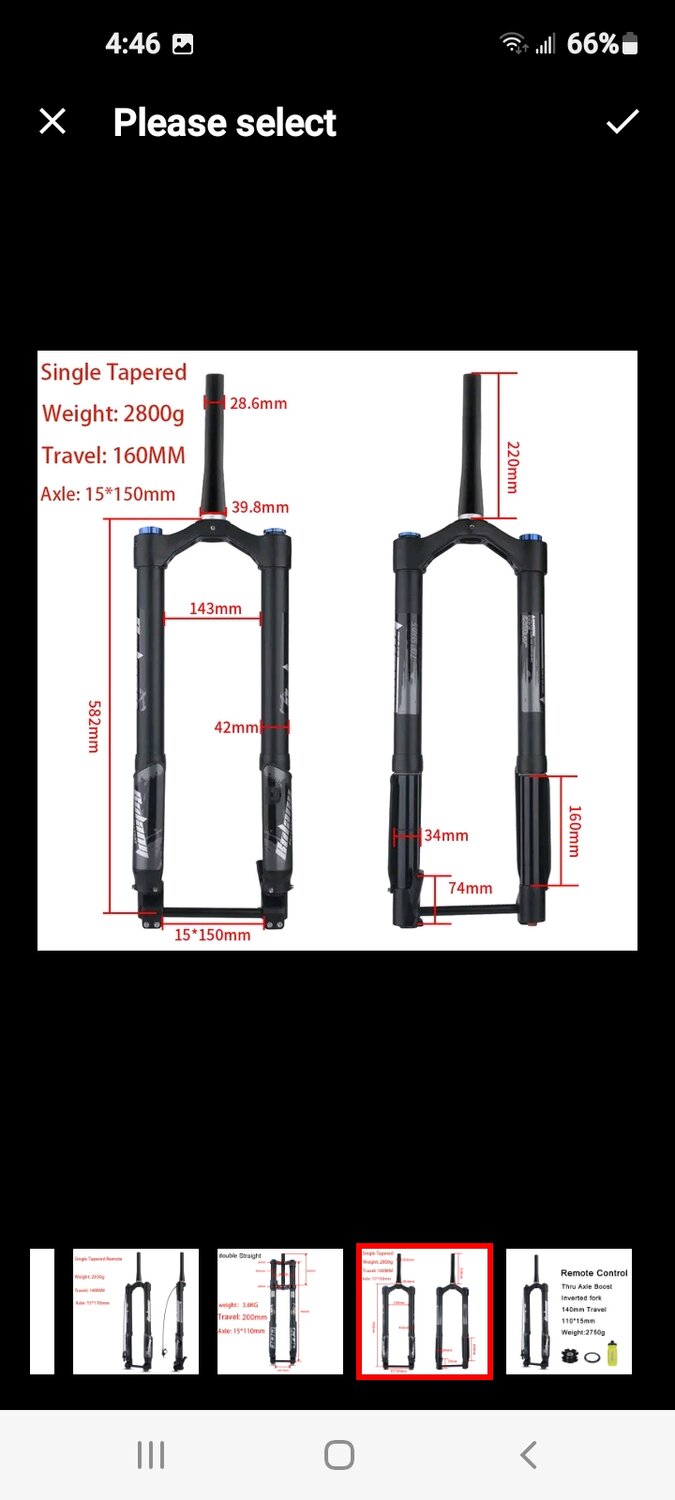

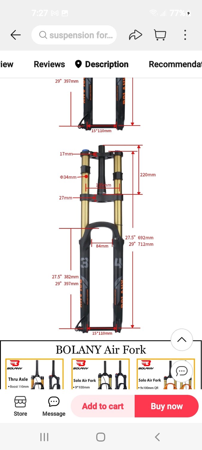

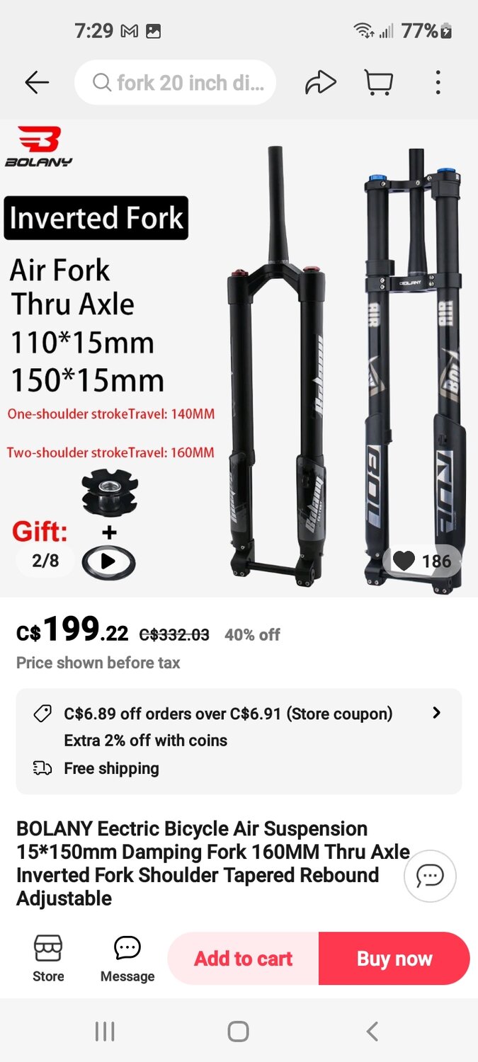

I want to get a double shoulder downhill fork with as much travel as possible but my tapered steerer tube and 135mm dropout is limiting my options.
I like these and they are nice and cheap (I don't want to put a $10 saddle on a $2 🐴)
$118 plus $59 shipping.
But they don't come with a tapered steerer tube, so I'm thinking of getting a 30mm to 38mm steerer tube/bearing shim.

I can get a downhill fork with double shoulders and a tapered steerer tube but it has a through axle and seems to only be available with 110mm or 150mm dropouts.

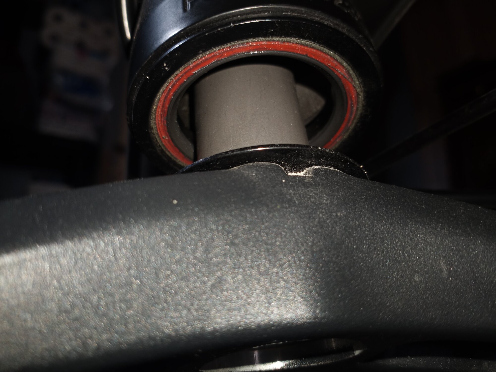

I took some pictures of my steerer tube when I installed my handlebars but I didn't take measurements,..
