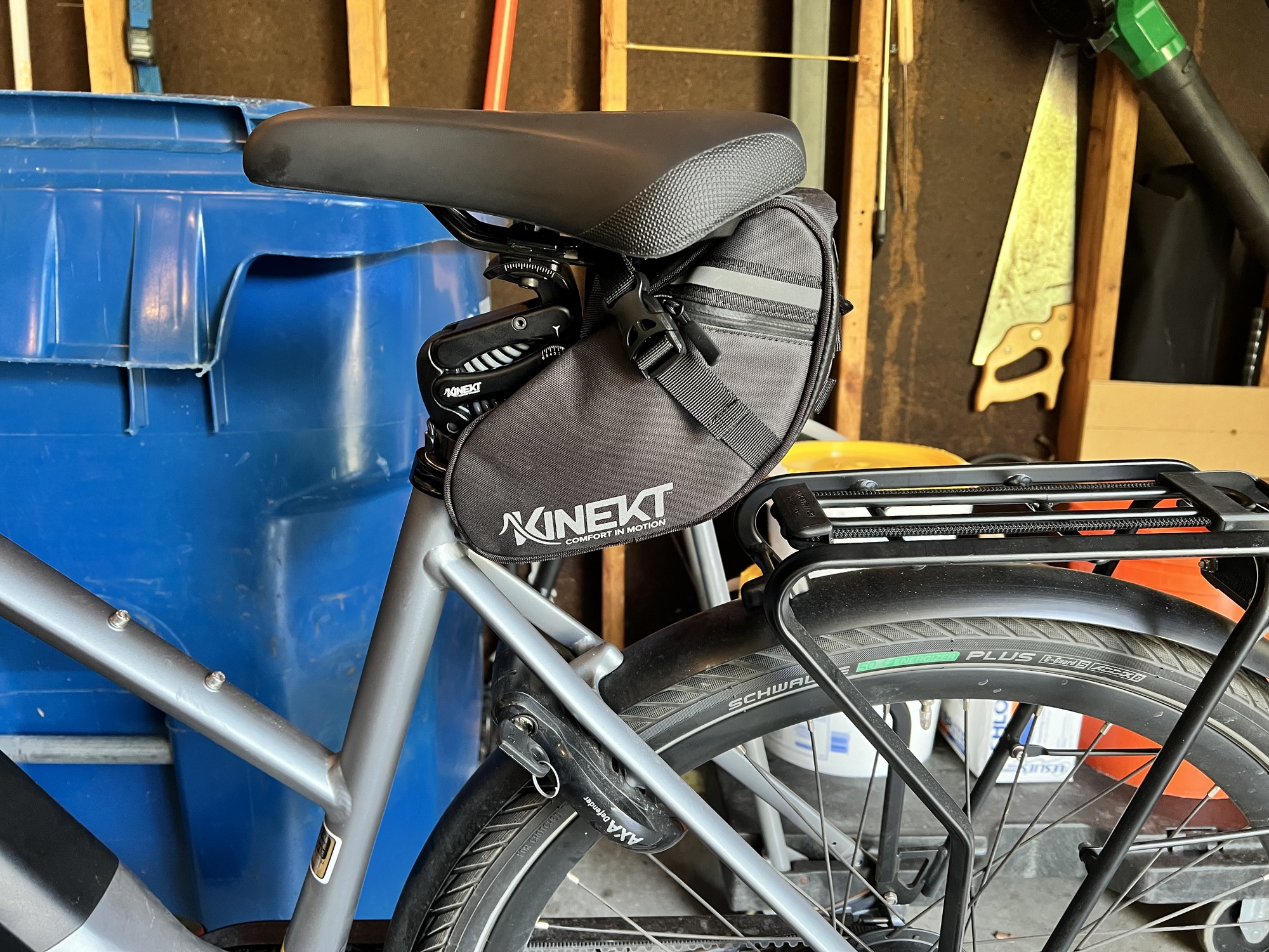

I ride an Ultimate C380+ with the Kinekt suspension seat and love it. I found the C380's aluminum frame and higher speeds transmitted every bump and road imperfection. The Kinekt solved all of that IMMEDIATELY. Very comfortable, particularly when off pavement. They also offer a great saddle mount bag that wraps around the spring components perfectly.

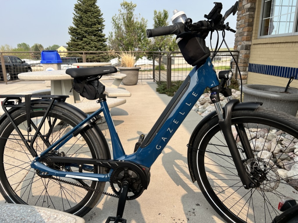

I am 5'2" and ride the smallest frame 2023 c380 with a redshift shockstop post. This seatpost is the shortest I could find and works well for me.View attachment 158608
Nice pic. Noticing your water bottle placement because I’ve been mounting and remounting mine most of today. Started out mounting it where you have it then thought it was too crowded at the handlebar, shifted it below the seat post which seems to defeat the step through benefit. Tried attaching to the mid-post but got in the way of the Kiox 300 display. Finally remounted it to the right handlebar. Had a similar debate on how to mount a mirror which would look aesthetically pleasing but effective.
