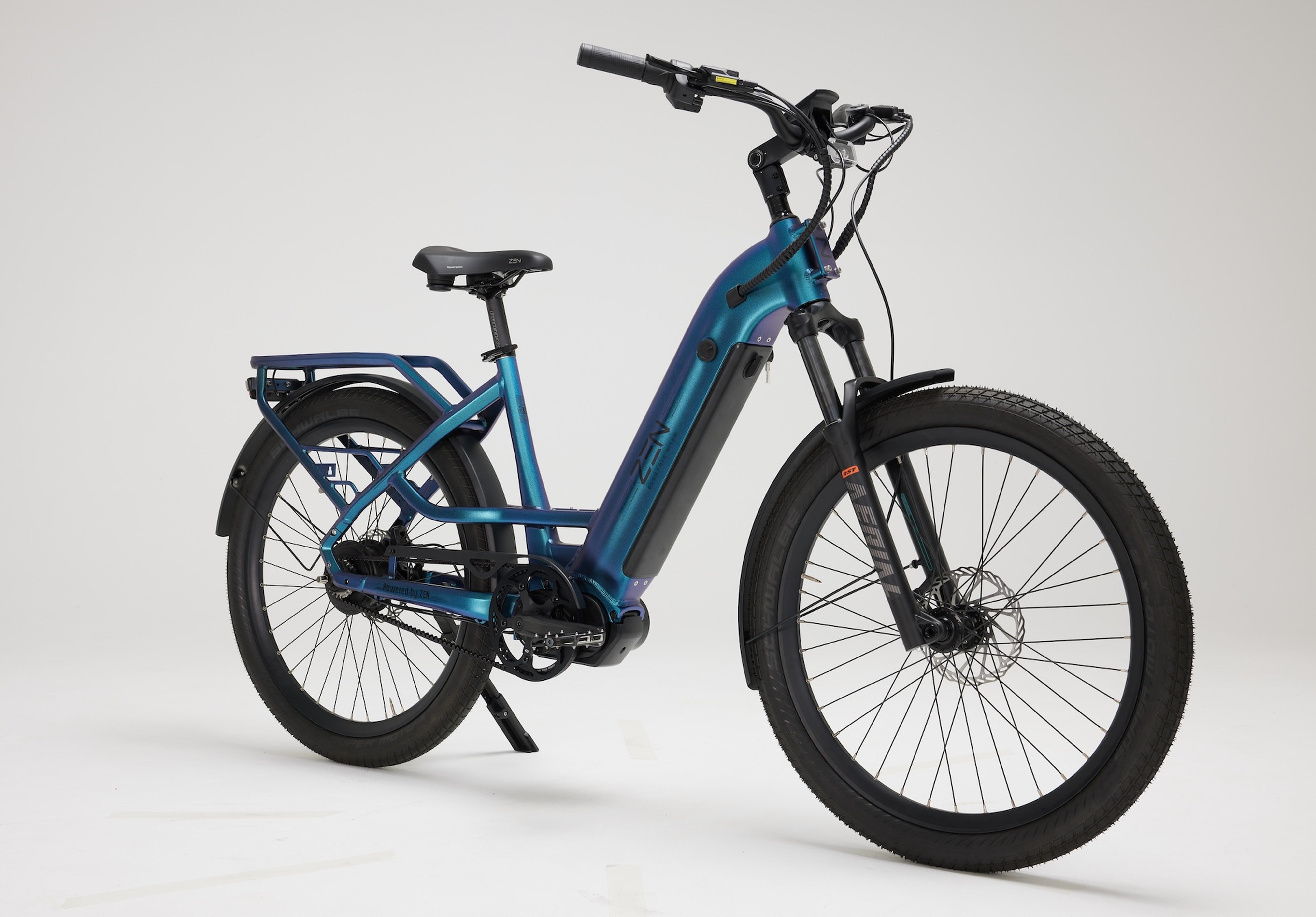

I’ve test ridden several e-bikes, finding none that were comfortable until recently, most in the largest frame size available still too small for my 6-3” height and 35” inseam. So many bikes come in only “one size fits all” or 2 frame sizes, many having lower max recommended rider height/inseam. By chance, I rode one that came in 3 frame sizes, the largest one seeming just right. I noticed this bike seemed to have higher handlebar height relative to the seat position than any of the others I test rode.
The bike at the top of my list is the Zen Photon (19” frame size):
zenebikes.com
This is the bike that felt right on fit (Large size):
Comparing the reach, the difference is less than half an inch—check.
Comparing the head tube length, the Serfa is over 3” longer—would that mean the handlebars would be 3” higher if the head tube angle was the same and handlebars same geometry? The derailleur drivetrain on the Serfa is a deal breaker for me, plus the Photon is a better spec bike in many ways beyond that. The Photon is exactly what I’m looking for, trying to decipher the comparison in geometry to predict fit.
Comparing 2 bikes, If the reach is the same, same handlebar geometry, and same handlebar height relative to seat height, wouldn’t they “fit” the same? Obviously this would be for one rider, the head tube angle and seat tube angle changing things as adjustments were made as rider anatomy changes.
Does this make any sense? Is it possible to even compare the geometry specs to predict fit?
