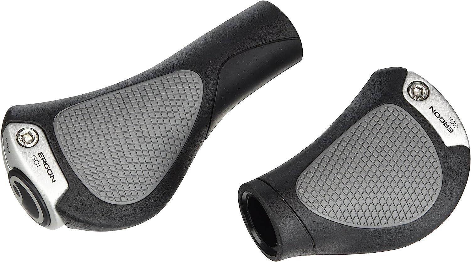

I have an Ancheer that I love riding but my hand keeps going numb. I have some carpal tunnel pain occasionally so this is not surprising. I read several post in various forums praising the Ergon grips so I bought some only to discover the Ancheer has a plastic piece build into the right grip that attaches to the throttle. This means I can’t install the Ergon grips.
Has anyone found an ergonomic grip that fits the setup of the Ancheer or a way to make a grip work?

Not sure what you mean about the Ancheer without a picture, but Ergon does sell some of their grips in shortened versions to account for things like Enviolo shifters, so that might work for you.
Thanks for the info, Ergon told me they don’t make a grip for bikes with throttles like mine.
Does the side for the throttle have a larger diameter opening than the other side? If so, they would be perfect,

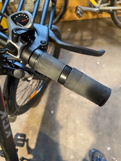

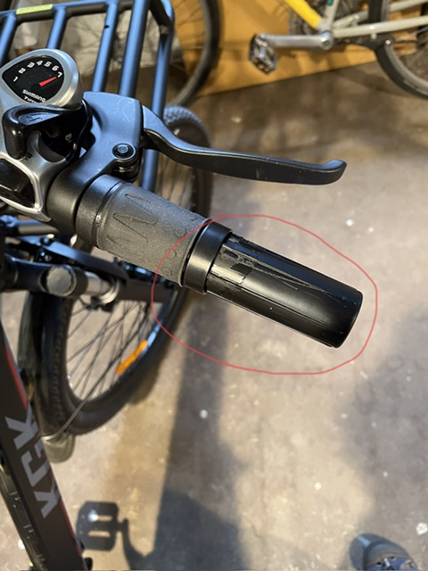

It is a twist throttle. I added photos of the throttle and grip to my post.

The handlebar is 22.2 mm, you’re right. Sadly, the throttle setup necessitates a grip with a larger opening on the right hand side.

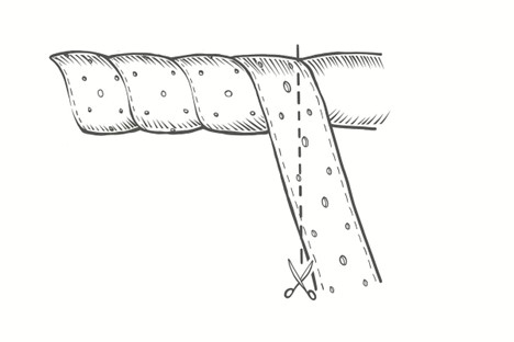

@LoriB, Okay then. The road bike grip tape is the way to go then. Across the top of a road bike I will lay down a strip of this grip tape before wrapping for extra padding. With road bikes you have more pressure on your hands than with casual bikes. The padding helps. I think it could help you too. Oh, it is vital that it does not touch the throttle. The diagram is for the left side. The right is a mirror image.

Thank you. I really appreciate it.

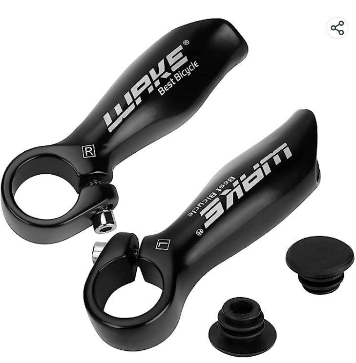

Recently I added these which allow me to change hand position which I found helps as well.
There are nicer ones and I wish these were just a bit longer.
