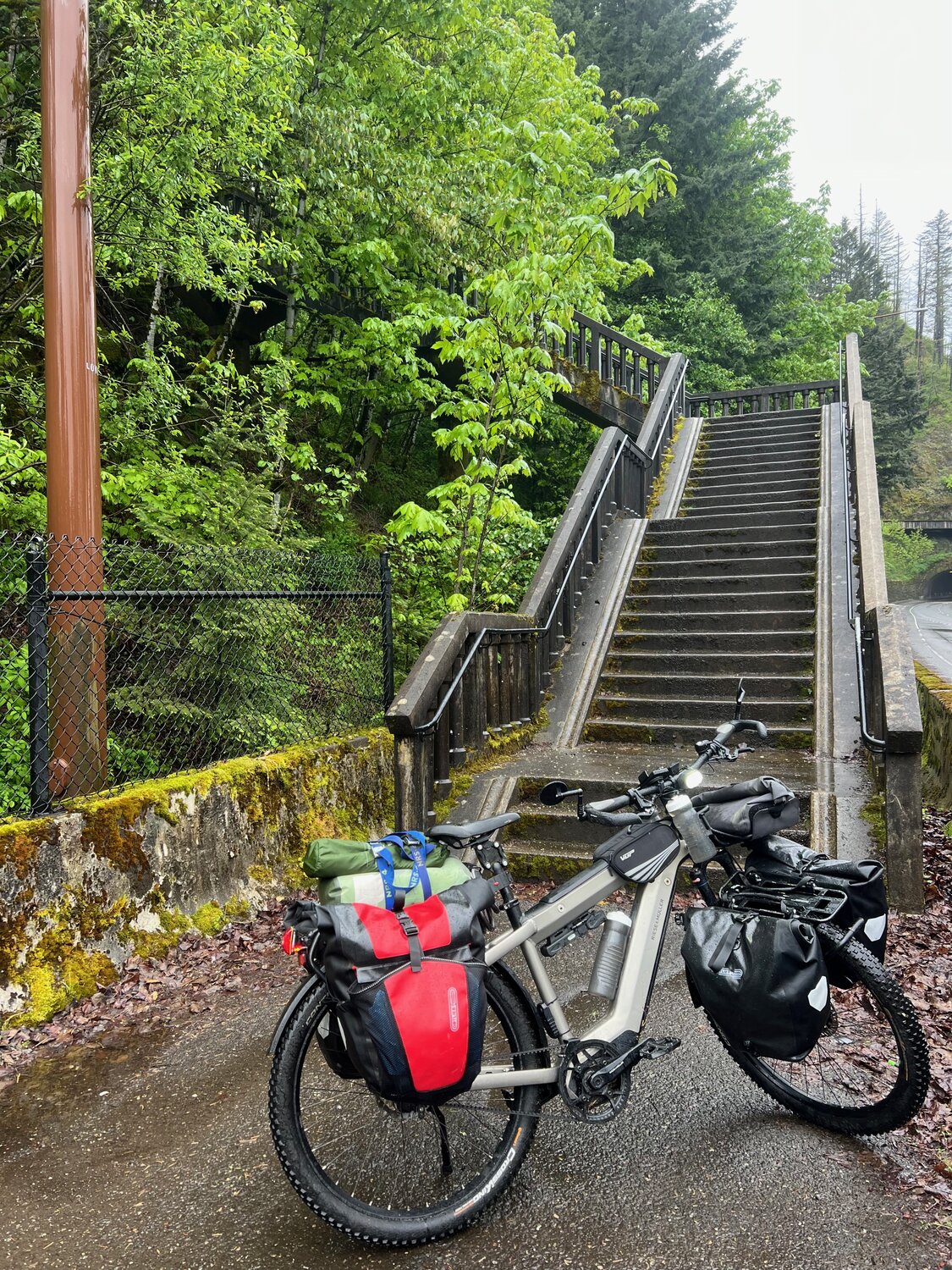

Could you have placed your wheels on the 'rail' to the right of the stairs and used walk assist mode to walk it up the smooth part of the stairwell?

Sorry to hear of your Rohloff experience. I have had no leakage issues for about 3k miles since warranty replacement. And yeah, I did end up doing that. Ended up only having to remove bags but wanted to share what I thought when I first saw the old looking stairs and did not even know those rails existed.

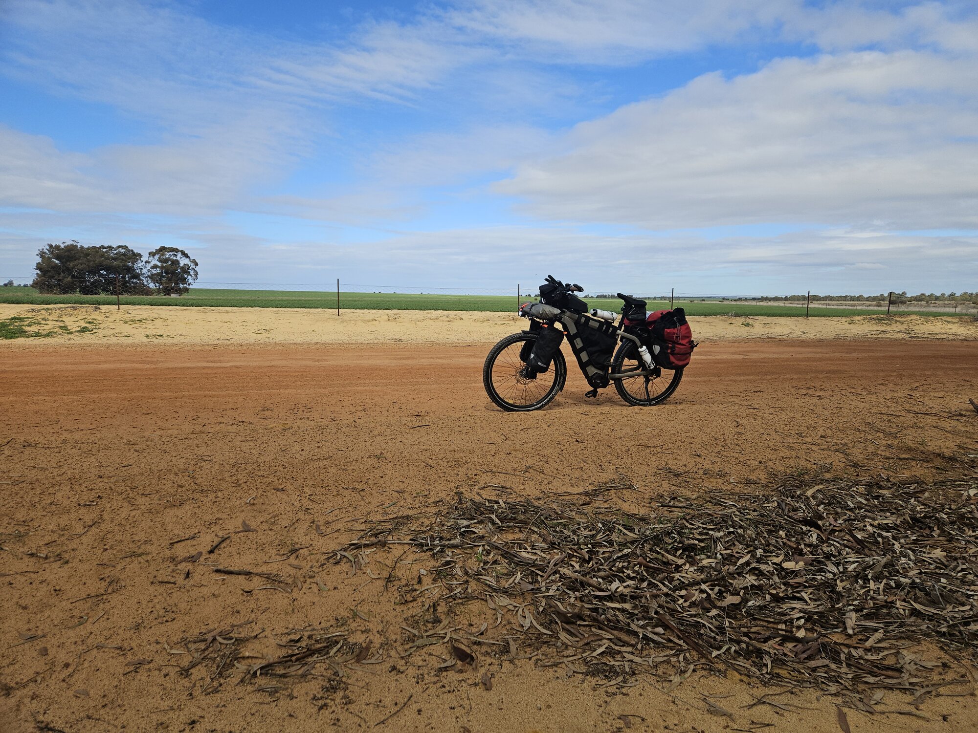

An update: I had to pull out of the tour on day 7 due to an Achilles Heel injury, which I suspect was a result of a change to my pedalling technique with my left leg. But first, I did ride 526 km without any bike issues; well, besides getting bogged four times ... a process of locking the wheels due to the amount of mud, finding a stick, clearing the mud, pushing forward a few metres in search of harder ground; rinse and repeat. Of course, at the point where I left that road, there was a sign, 'Closed for Winter.' :)
Back to the injury. At the last moment on my departure day, my parcels arrived from Germany, so I decided to make some quick changes to the bike setup. The critical one was using a mount for a bottle cage (for some stupid reason, I only ordered one instead of two), which meant shifting the water bottle cage mount to the front of the pannier on the down-stay. I also decided to go with the panniers instead of the saddle bag (that was a good decision as it allowed me a little bit of flexibility in carrying things).
With the water bottle cage in front of the left pannier, I rode with my foot slightly further forward on the pedal, whereas normally, I am a front-of-foot-on-the-pedal person. I suspect that this may have resulted in the damage to my Achilles. Also, I may have had the seat a few millimetres too high, but it was too late when I decided to lower it by 5 mm.
Reading about Achilles injuries and cycling, I see that seat height and pedalling techniques are known causes.
Anyway, besides the injury, the ride on the bike was a good experience. I found that I pretty much stuck to cruising in Eco mode, and then with around 20 km to go for the day, I would up the assistance to Tour or Sport or a combination of both just because I could :)
Based on each day's riding, I estimate that I could get a range of around 171 km, so well within the distances I wished to ride daily.

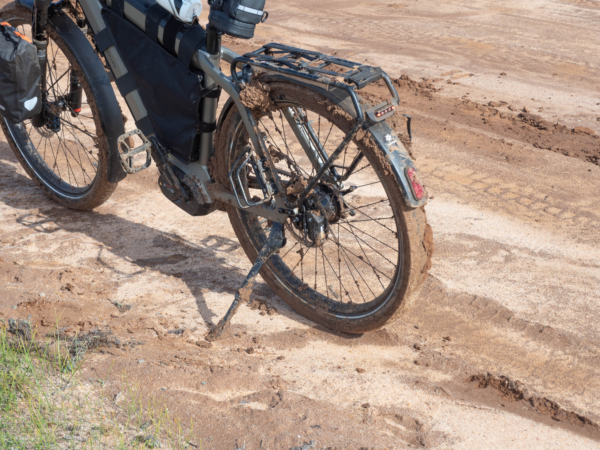

The only technical issues I had where
[1] Post the day getting bogged, I noticed that if I was in the wrong gear and pushed too hard on the pedals, I got a clunk. I have not yet been able to narrow down the source.
