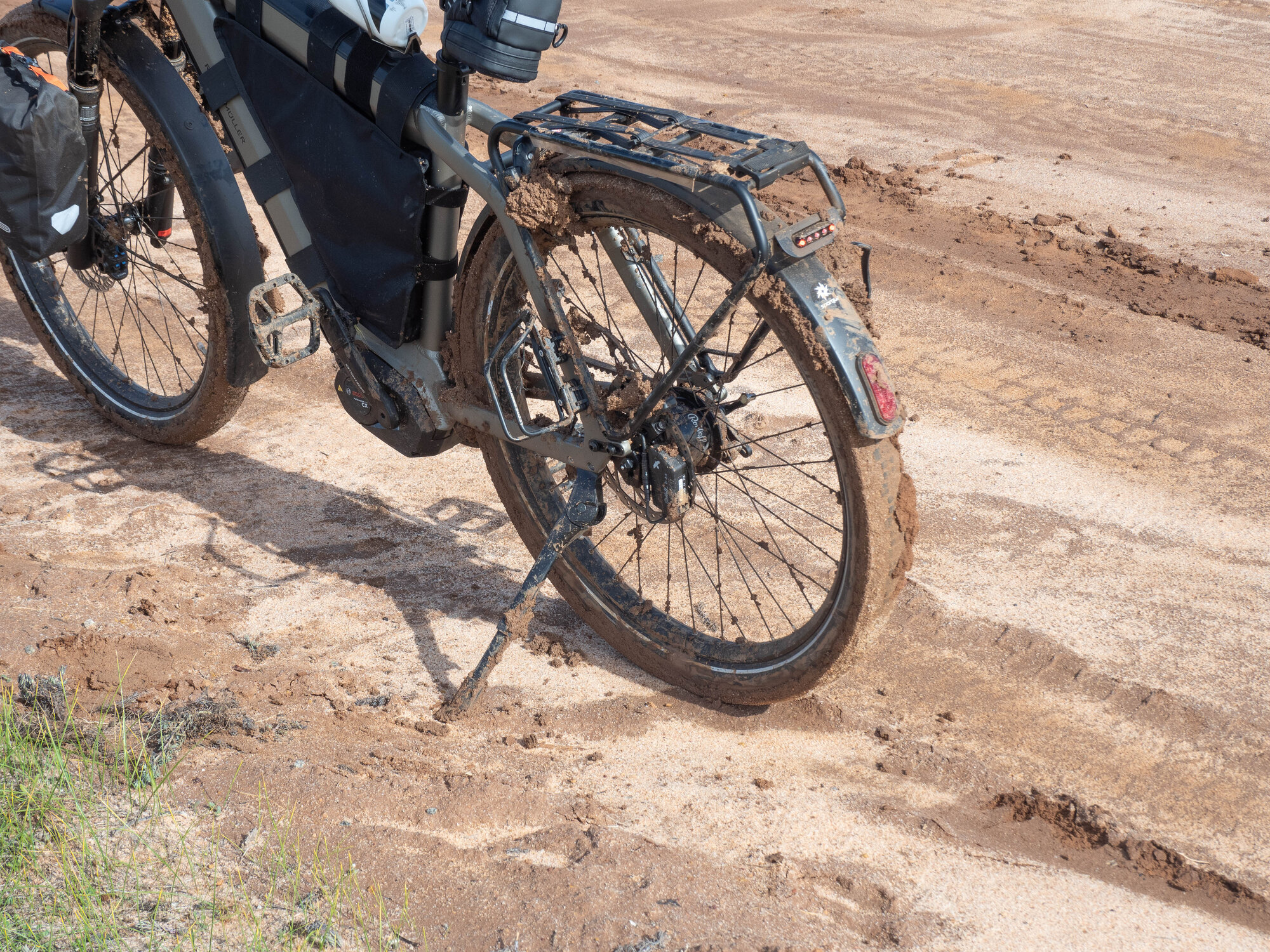

The Americans call that peanut butter mud I believe. Nasty.
In deed it was. It would lock up both wheels within seconds. No rotation, so no easy way to move forward as I couldn't get much grip either.

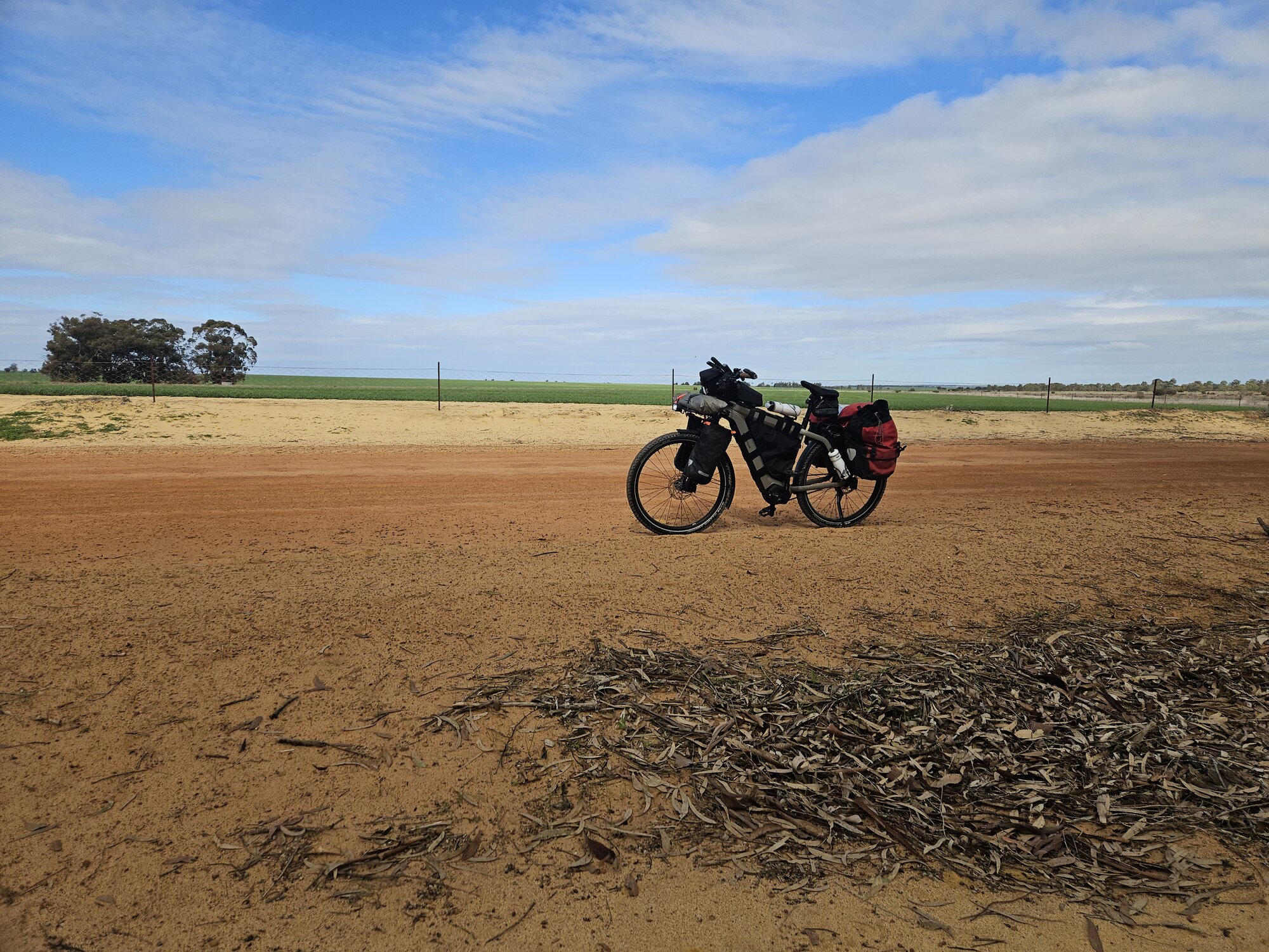

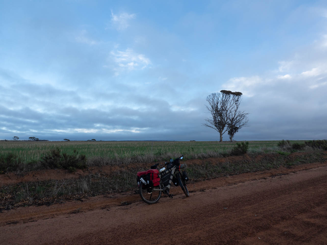

A few odds and end photos ...
It passed by whilst I had lunch about a metre away ...
Maintaining the road for me :)
Storms were expected ... they never arrived.
Cunderdin pub
Westonia ... my furthest point east
Northam ... the official starting point
