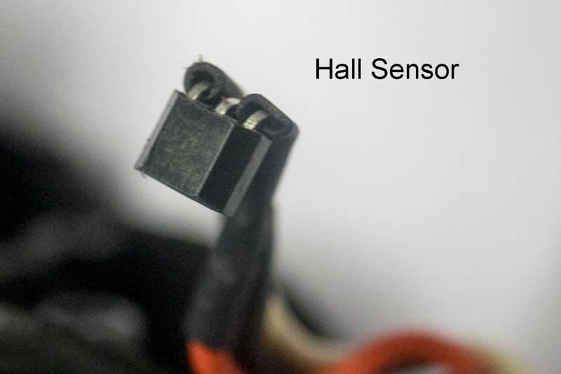

The throttle consists of a magnetic ring that is rotated around a magnetic sensor. There aren't any moving contacts/sliders in there. Just three wires soldered to that sensor. The sensor can get wet, and if it stays damp, it won't work right or the leads can corrode. Another possible failure point is the throttle connector (which is by the controller) gets dirty/loose.

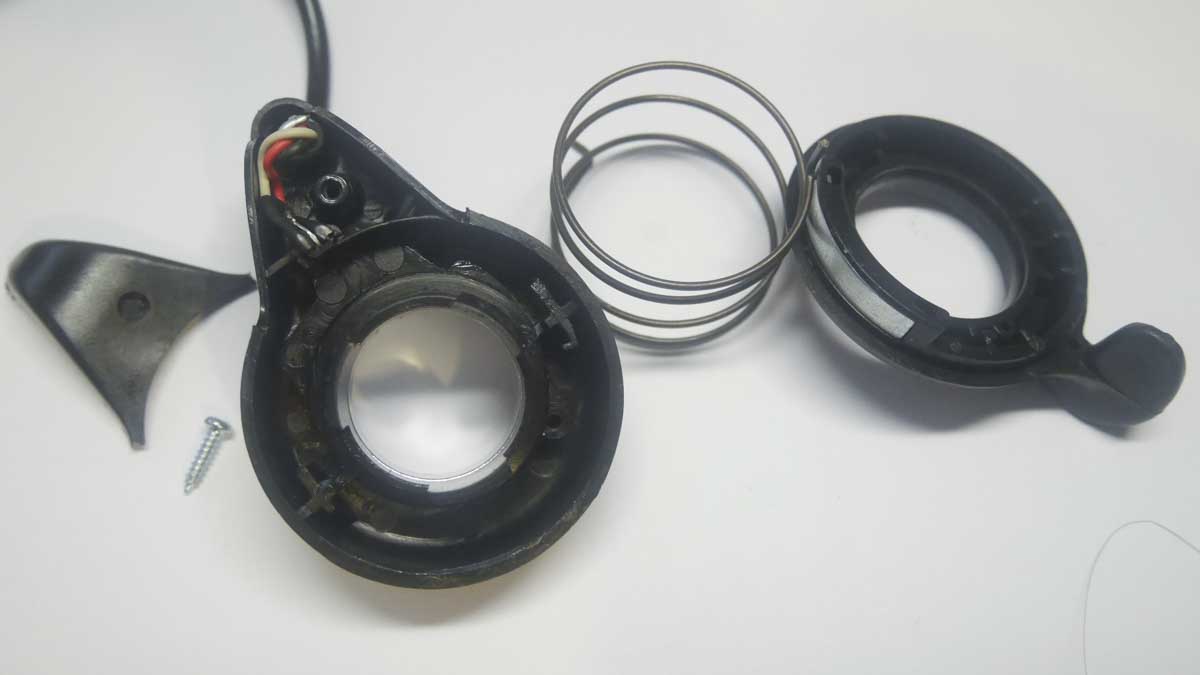

It's a twist throttle? I was never able to pull one of those apart, like I have on these thumb throttles, but I'm sure they're both the same inside. Just a magnetic ring with a spring, and a Hall sensor chip (three pins) soldered directly to the cable.
Yes,it's a twist throttle,similar to the one in the pic you attached. So,looking at the pic, there doesn't look like it's soldered inside... What goes bad..? Could it be just the sensor..?
Must be controller. You have to get one from Ecotric, I guess.

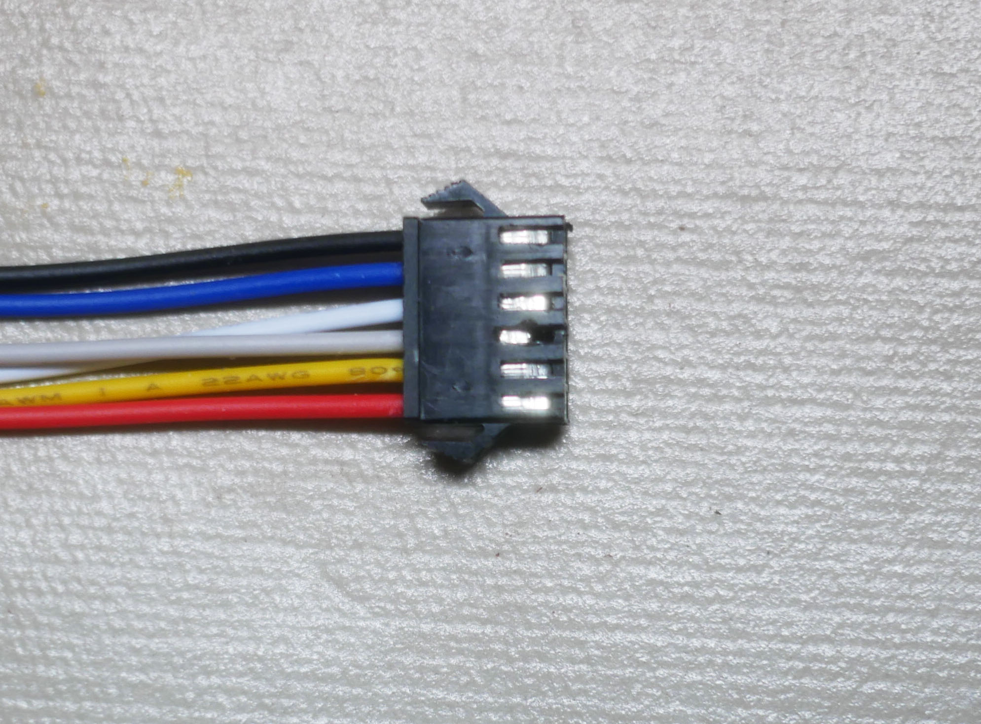

Check the old connector. While it's a three pin plug, and not a six pinner like this picture, I've had some grief when the pins get loose and do this.
The old wire has hot glue on top of the connector,where the wires go into it. This was done to stabilize and lock the wires in. I will check them out,tho. I will test each one for continuity, and see if one, or more, are malfunctioning. I think it may take me running a new wire. Have any suggestions on how to do that..? Ecotric got back to me and said unplug all the wires out of the controller. Remove all of them from the frame. Put new throttle on, and then reinstall all the wires back in. Seems like making alot of extra work..!😠😤
